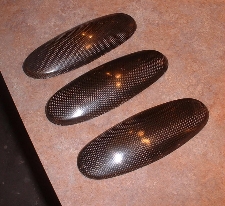

You are able to sand and polish the "finished" side of c/f. If you have small imperfections after you remove it from the mold, like air bubbles, you can rough up the area, mix up some resin and fill the hole. Let it cure and hit it with some 320, 400, 600 paper, than bring out the shine with some rubbing compound.
Not a big deal, really. Paul |

I had several areas that needed to be filled when I made these...
Attached thumbnail(s) ![]() |

I was surprized whenI polished it how well it brought out the shine.
Jeroen explained the process pretty well for flat work. Try it on a small piece first. (don't tell anyone, but I found almost no differance between working with c/f and f/g) Paul |
