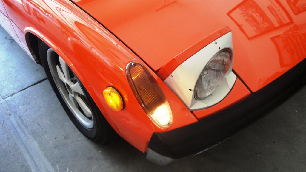

To make it a little more clear, current prices for my conversions.
Ready to Install, complete pair of signal housings. $280.00 plus shipping.

Installed....

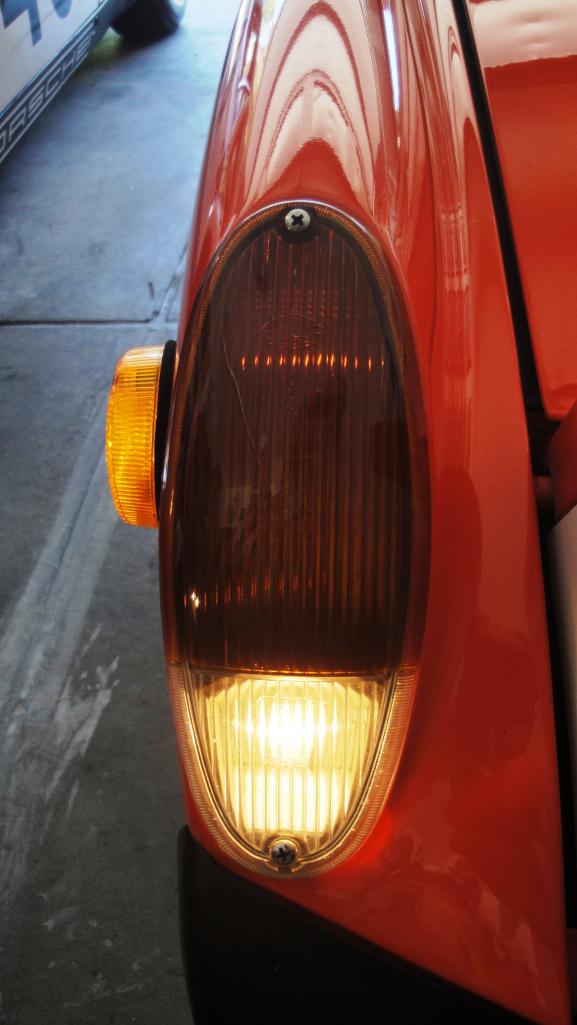

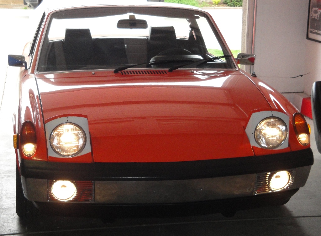

More, I love 914 types.

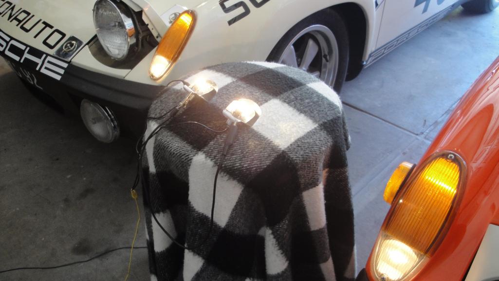

This shot gives a good idea of how much light a 7.5 watt bulb can make. Originally the cars used a 6 watt bulb which will fit this socket, I use a 7.5 as it is the most available bulb, and resonably priced. Original type bulbs can be found in a Salvage Yard, try BMW makes. I found a couple, and are still in my Orange car....they may have been the reverse lights, 3 or 5 Series. Not sure.

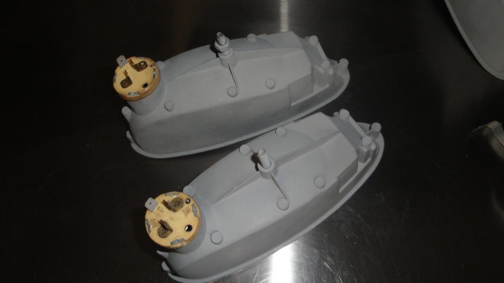

When I started making these, I would make a set for three pairs in trade, send me three sets, I send you back a restored set, I kept two sets to restore/sell, which worked OK, but many that I recieved were unusable, corroded, bent, missing parts, etc. I still have all the rejects in a box, big box. I have given up on that method, as one persons idea of usable may be very different from someone else's. I can't sell to someone a housing thats been crushed, or so corroded that the terminal cap has no lugs to retain it. One guy sent me six housings, and all six were unusable. So Yes, by ALL means, if you have nice housings and want them done, I will do them, here, and insure you get back what you sent. I have seen a few where the original finish still looks great, and if they do, I do not paint them. Just install a refractor and wire them. I am nearly out of useable housings, so for me, doing yours (Pete, or anyone else!)is a better deal. Before you send, look to see that the contour of the sides of the housing have a unifom shape, the housing is not cracked from someone screwing in the retaining stud to far into the housing. Seen a few of those. Inspect the area where the electrical terminal cap is, to insure the lugs that retain the white terminal cap, can be re-installed and secured.
No special lense, only a normal Euro lense is required. What you see here is an exact copy of what the factory did.

Sure no problem on the photo, its completly original in appearance, as I mentioned earlier. 100% like the original. Plug it in. I duplicated the original as close as possible. What it does is deactivates the park light side of the 1157 bulb, and wires up the 89 bulb internally. An original Euro uses a single filament bulb in both positions.
I have thought a bit about the price of a conversion, so if you ship them to me, and they must be usable, (as I am now out of usable housings) I will do them for $200.00 returned shipped to your location. I think this is fair, and it would be around a week turn around if I have parts on hand. I currently have sockets on order.
