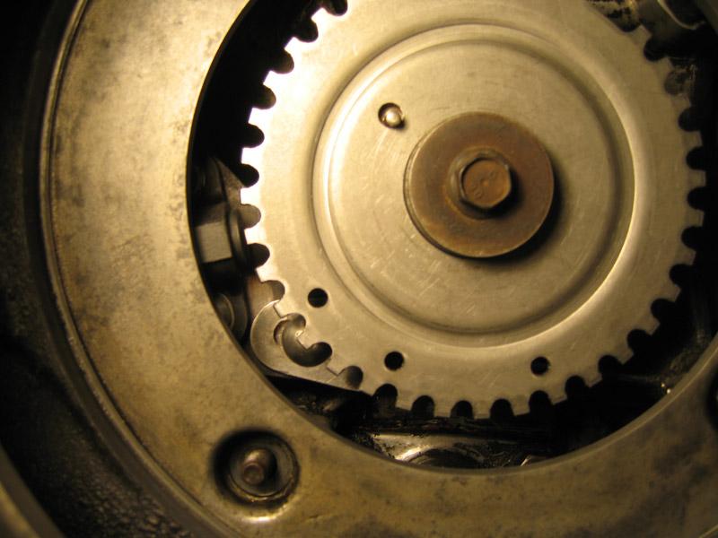

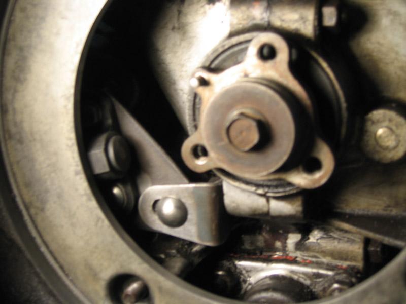

QUOTE(DBCooper @ Jun 7 2013, 07:00 AM) *
That is cool. It must be new because I don't remember their having an option for a 36-1 trigger wheel when I started my edis project back in February. I had to fab my own bracket and modify a stock trigger wheel.
(IMG:http://www.914world.com/bbs2/uploads_offsite/images.thesamba.com-11782-1370615044.1.jpg)
(IMG:http://www.914world.com/bbs2/uploads_offsite/images.thesamba.com-11782-1370615045.2.jpg)
I wonder where that sensor mount is supposed to go? It looks like maybe off the fan housing. I wonder if you have to make holes or if there is any adjustability. Mine is still a work in progress. I am thinking of trying it in gimp mode this weekend. Got to wire keyed power, ground, and put new plugs with the nubbies for the wires I custom crimped, start it up in limp home mode I hope.

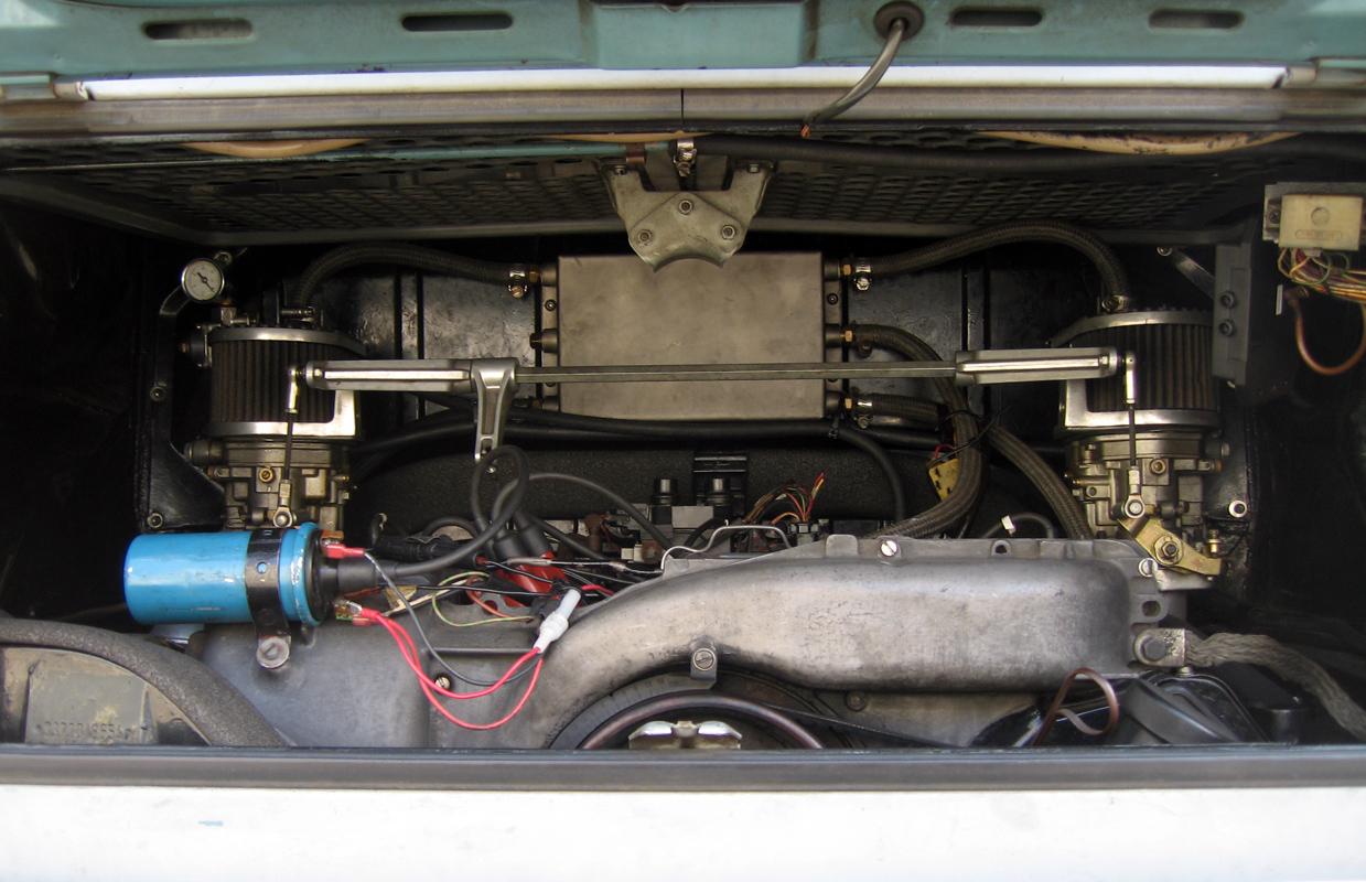

worn
post Jun 7 2013, 12:56 PM
Posts: 3,659
Joined: 3-June 11
From: Madison, WI and North Bend WA
Member No.: 13,152
(IMG:http://www.914world.com/bbs2/uploads_offsite/images.thesamba.com-11782-1370615045.3.jpg)
How did you get that photo angle? Edit. No wait, what am I looking at in the first place. Out of my league here (common).
ThePaintedMan
post Jun 7 2013, 01:08 PM
Posts: 3,887
Joined: 6-September 11
From: St. Petersburg, FL
Member No.: 13,527
VW Bus engine bay.
Source: grew up sticking my head in there many times while dad cussed at me from below while we swapped out engine after engine in his bus. (IMG:style_emoticons/default/smile.gif)
DNHunt
post Jun 7 2013, 01:11 PM
914 Wizard? No way. I got too much to learn.
Posts: 4,099
Joined: 21-April 03
From: Gig Harbor, WA
Member No.: 598
It's hard for me to tell but, if that bracket for the hall sensor is going between the case and the fan shroud there will be some machining needed on the shroud or it will sit wrong. I had to take about an eighth off 2 of the bosses on the fan shroud to mount my sensor.
