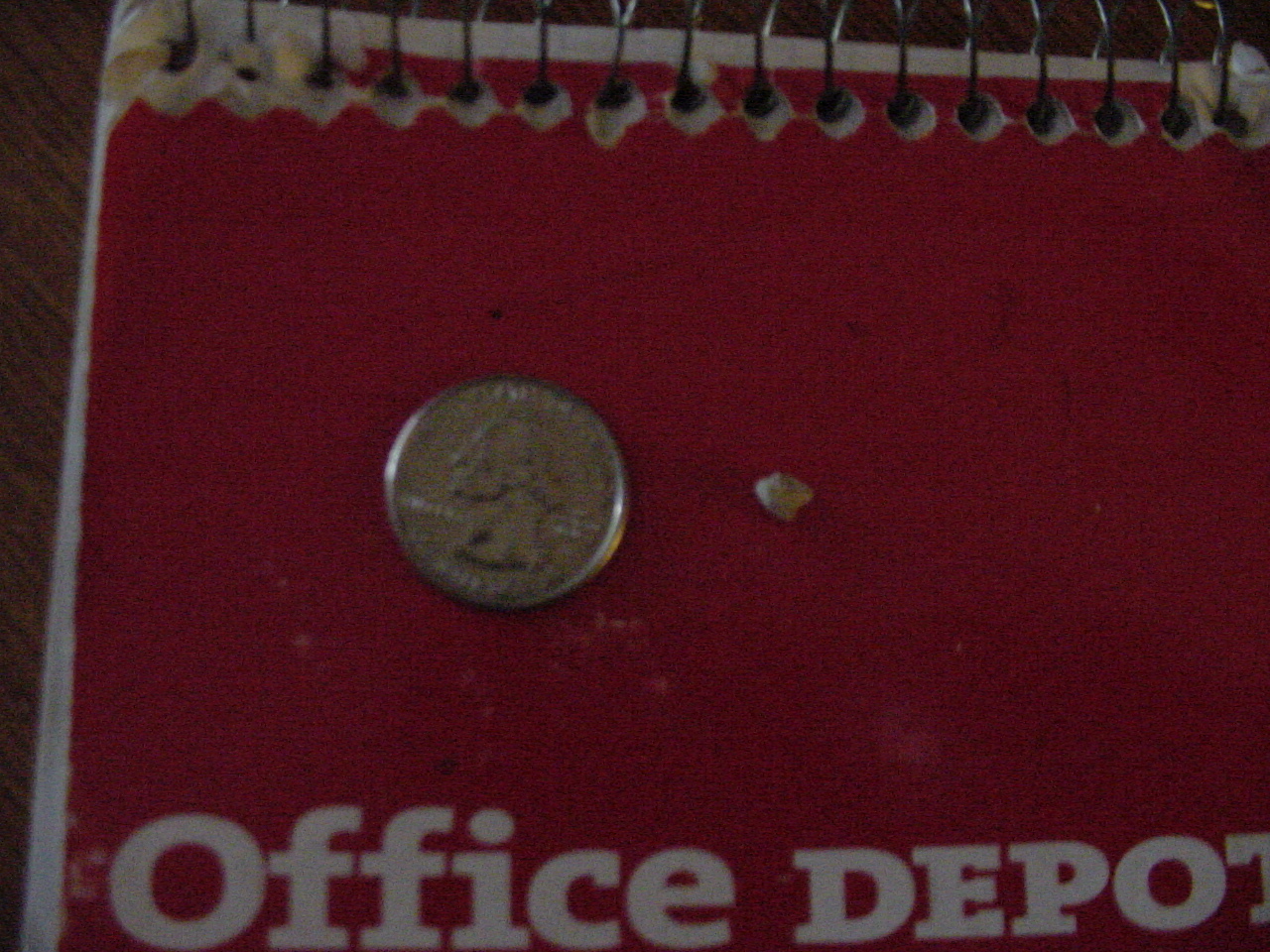

a portion of the crap that was in the bowl. was about twice as big kind of a chalky substance. hard but not like a rock.
sixnotfour
post Jun 9 2013, 06:29 PM
Posts: 10,909
Joined: 12-September 04
Member No.: 2,744
Carb Stone, It wont pass though..
