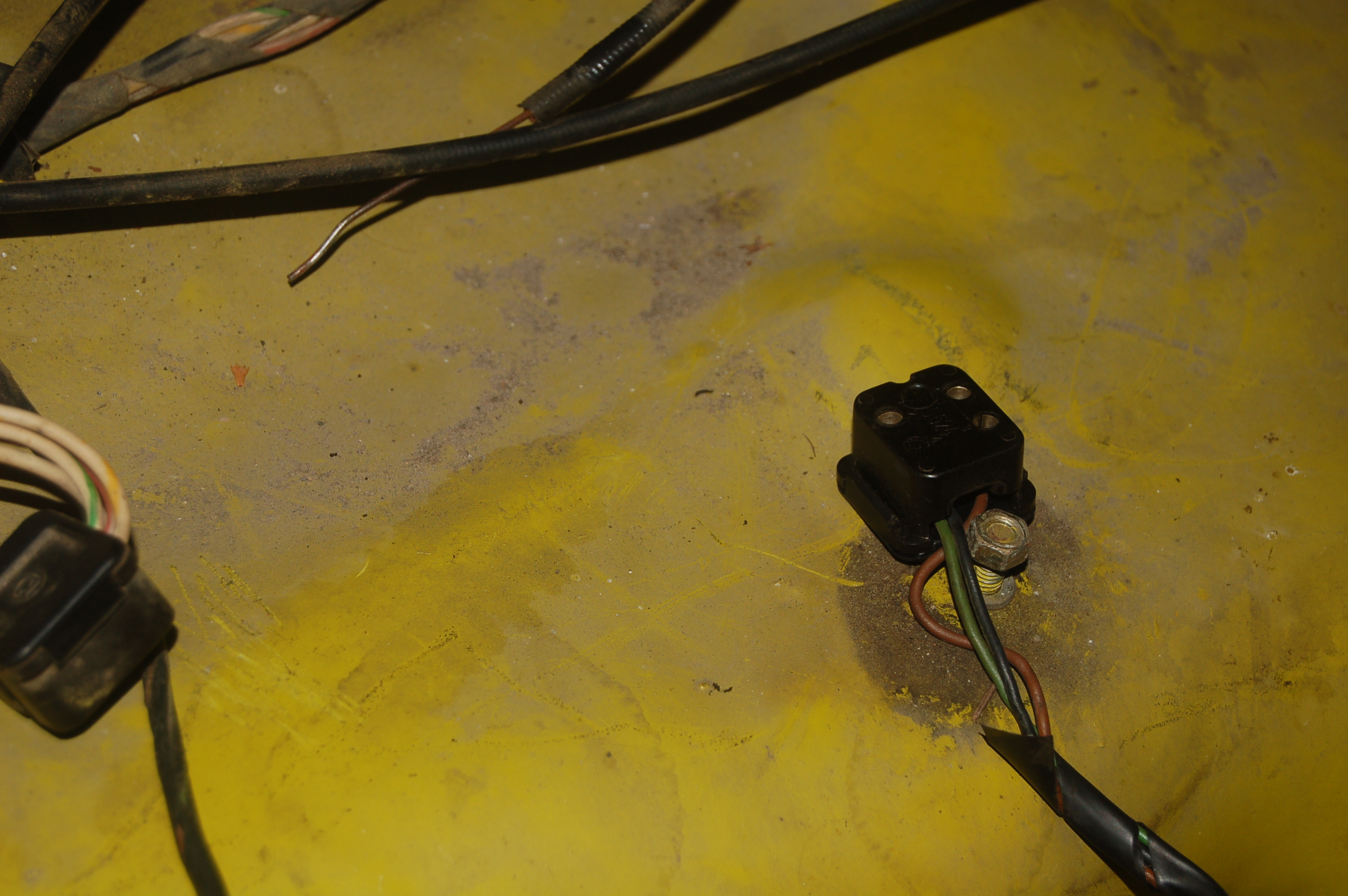

75 914/4 2.0 CA car
See photo below.
Car did have A/C so I don't know if this connected to something to the A/C or something else.
Wire colors are green, brown, and either black or blue (hard to tell which)
I'm putting in an electric pump for the windshield washer. Found the brown/black wire (cut), and no relay for the interm wipers. SOP for this project.
Thanks,
Len
PS - the connector way to the left is for the blower motor assm. I don't see where it has but one connector. So the other connector (with three wires) remains a mystery.
Would not be totally shocked if I'm missing something, but it would be nice to know

Fuel level sender.
Bowlsby.net or pelican parts have great diagrams.

Fuel level sender?
(IMG:style_emoticons/default/pray.gif)
thanks....
just looked at the sending unit for the fuel tank - duh (on me).
My BMW only had one wire and a ground. Didn't expect that.

Brown is ground, the others are for fuel level gauge and the low fuel warning light
