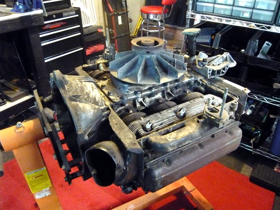

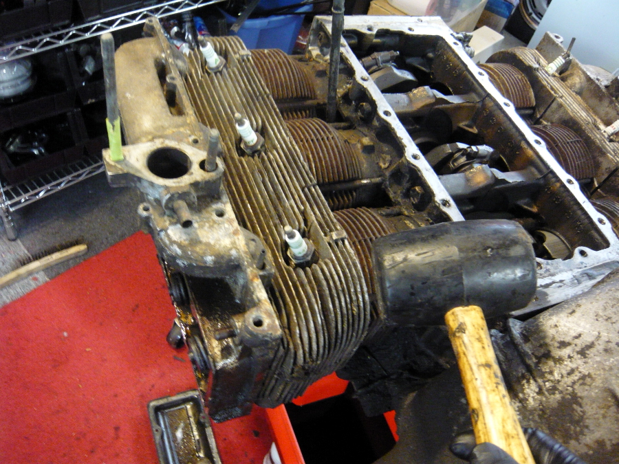

For your viewing pleasure, some barfy pics of the tear down so far.

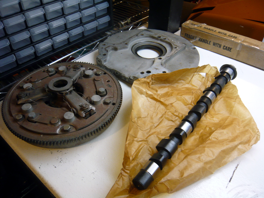

Here's part of the reverse rotation assembly. A custom 130 tooth flywheel, an engine to gearbox adapter plate, and an Otto-20 reverse rotation hot cam. Needed still are the reverse distributor gearset and alternator pulley.

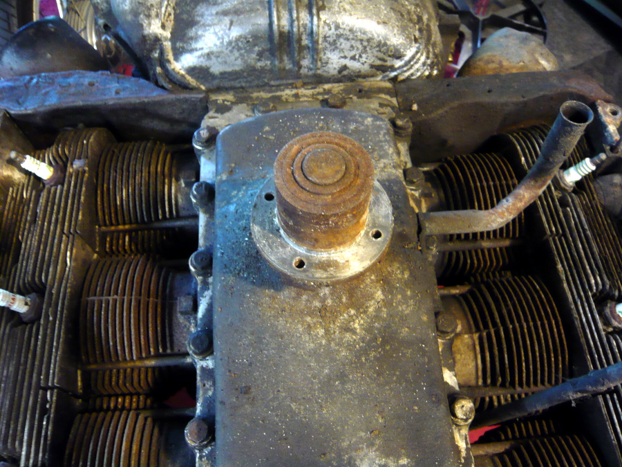

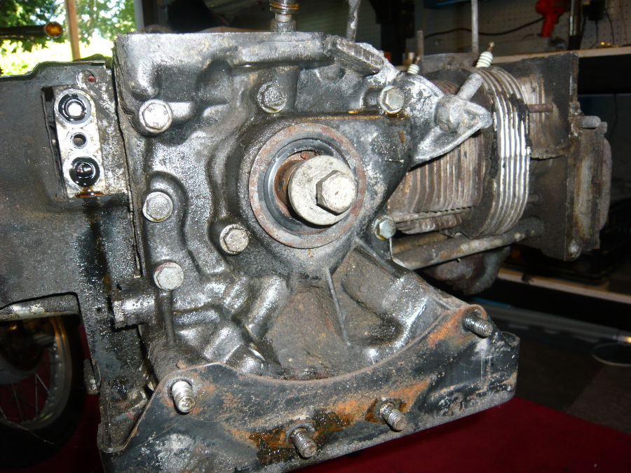

And here's the engine as-is, right from the bottom of the Black Lagoon.
The first thing to do is to gather 25 bins from Ikea for $4.99 each to separate and label everything. Then disassembly. To start, the magnesium fan and pulley is removed, followed by the top cover.

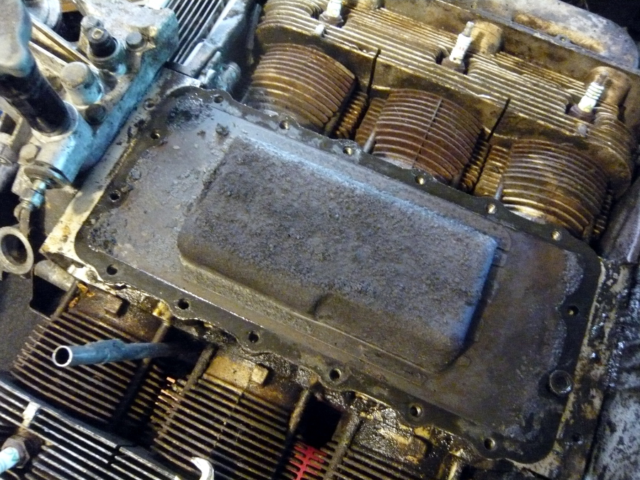

Under the cover is another cover, or really a very big gasket.

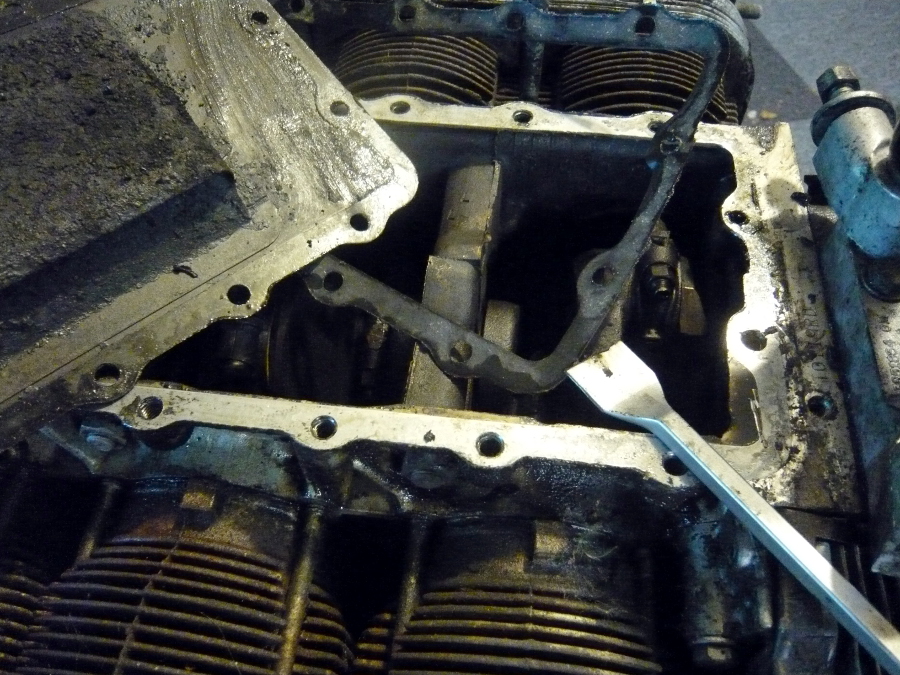

Under that gasket is another gasket, which when removed reveals the slimy innards of the crank case.
Note. Since I'm reversing the motor and mounting in "backwards" into the car, for the sake of 914 terminology I'll henceforth switch the terms "front" and "back" from what GM people would use. On the front of the engine there's a aluminum assembly that houses the oil filter, oil pressure sender, and speedo cable. Six bolts and it pops off easily.

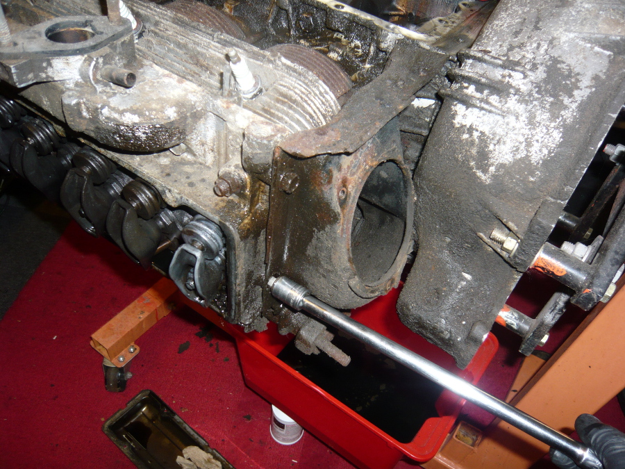

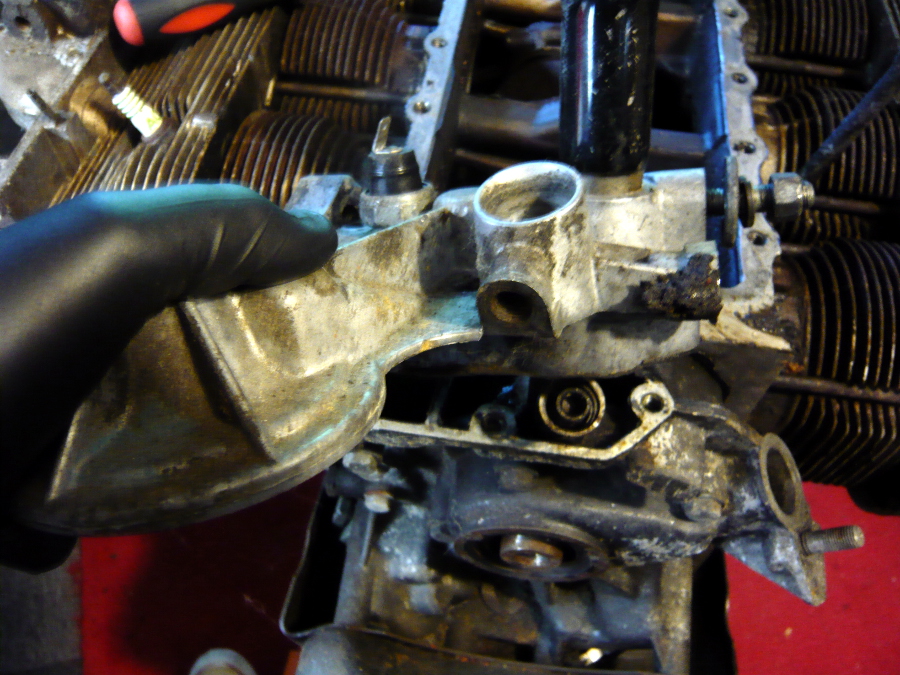

Then the oil cooler.

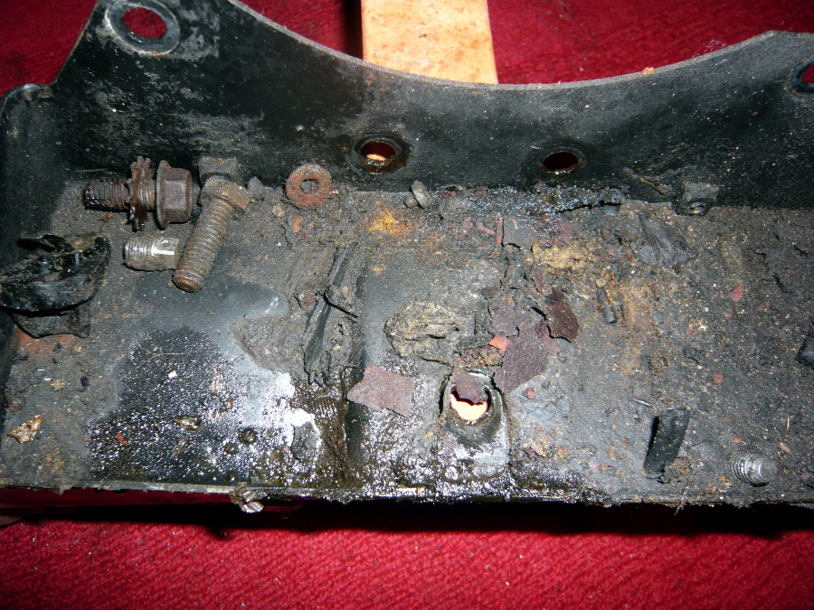

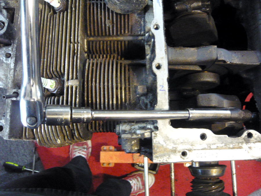

And finally the front engine cover which is held in with seven bolts and several nuts holding the bottom plate / front engine mount.

That front engine mount plate is the bearer of mysteries and a handy place to keep an assortment of extra fasteners and probably some chewing tobacco.

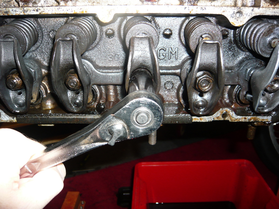

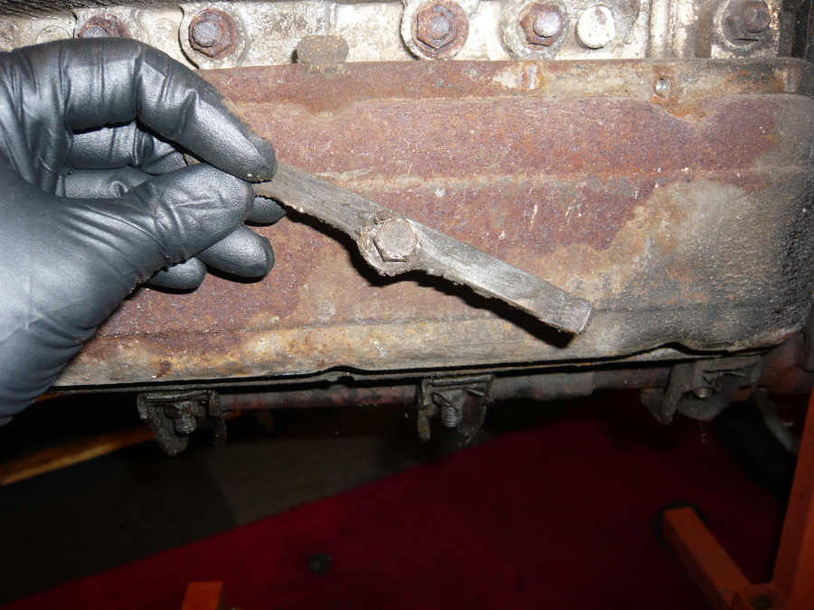

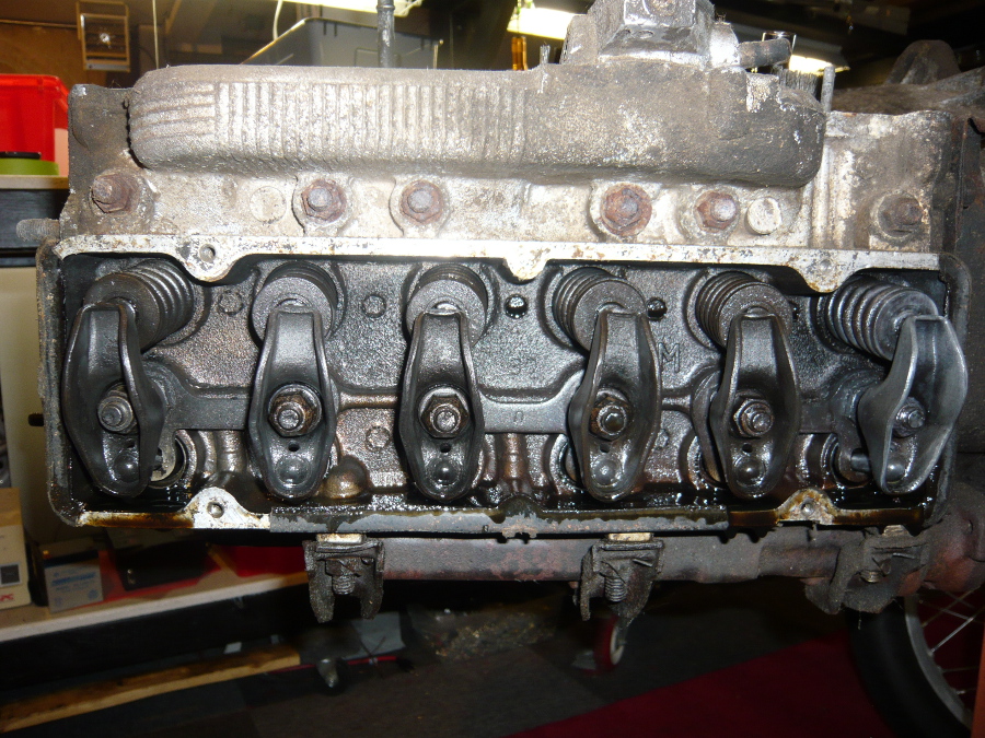

The valve covers on the later engines like mine are held on with four bolts and these elongated strips of metal to spread the load. Apparently this makes for an excellent seal.
The head for cylinders 1-3-5 showing its glorious hydraulic rockers. The nuts that hold the rockers down thread onto special studs that double as the nuts for the lower head studs. You can see the upper head nuts and they are RUSTY. It took a few days of Kroil, swearing, and heat to remove them. But hey, they held their torque.

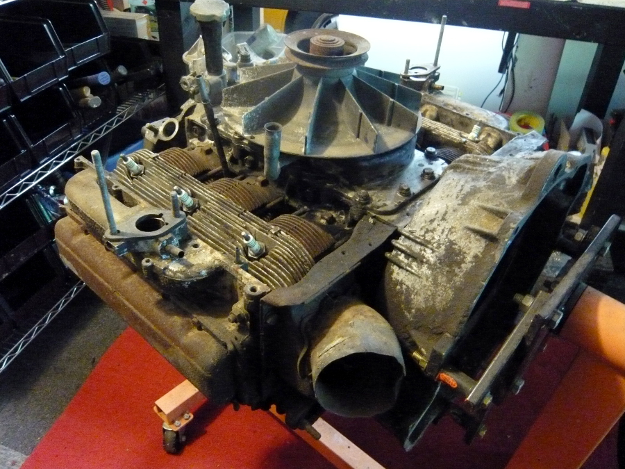

The engine is missing most of the sheet metal tins, but I'll cross that bridge when I get to it. But what little there was removed easily.

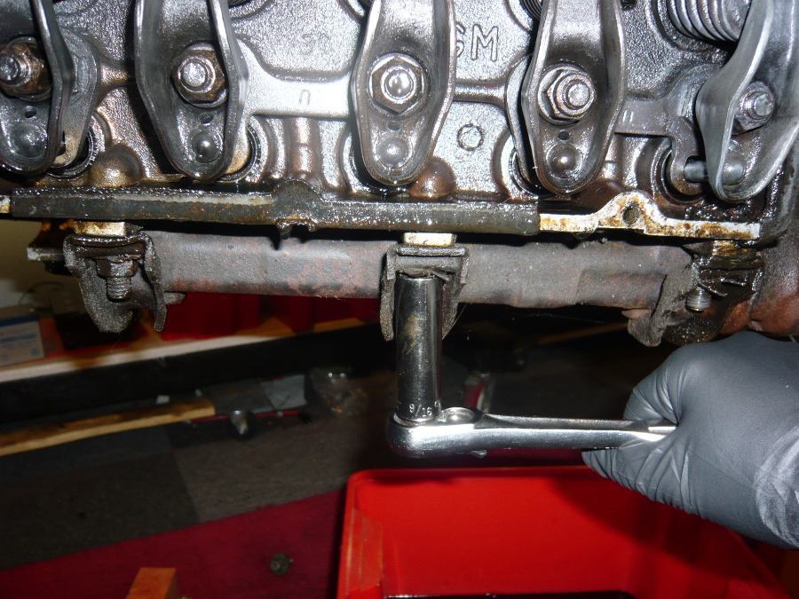

Three nuts hold the exhaust log. Once removed, it popped right off. This design uses no gasket.

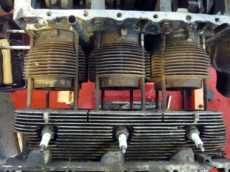

Off come the bottom head nuts.

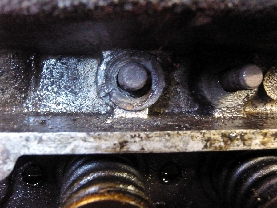

I ended up having to drill off the center top head nut and then use a cold chisel to split it. It's too tight in there to get a nut splitter. Underneath was one incorrect sized washer.

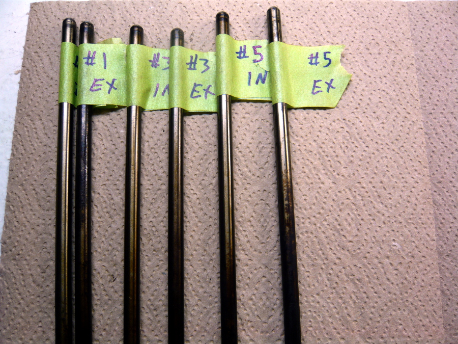

The pushrods are removed and marked for the sake of developing good organizational habits.

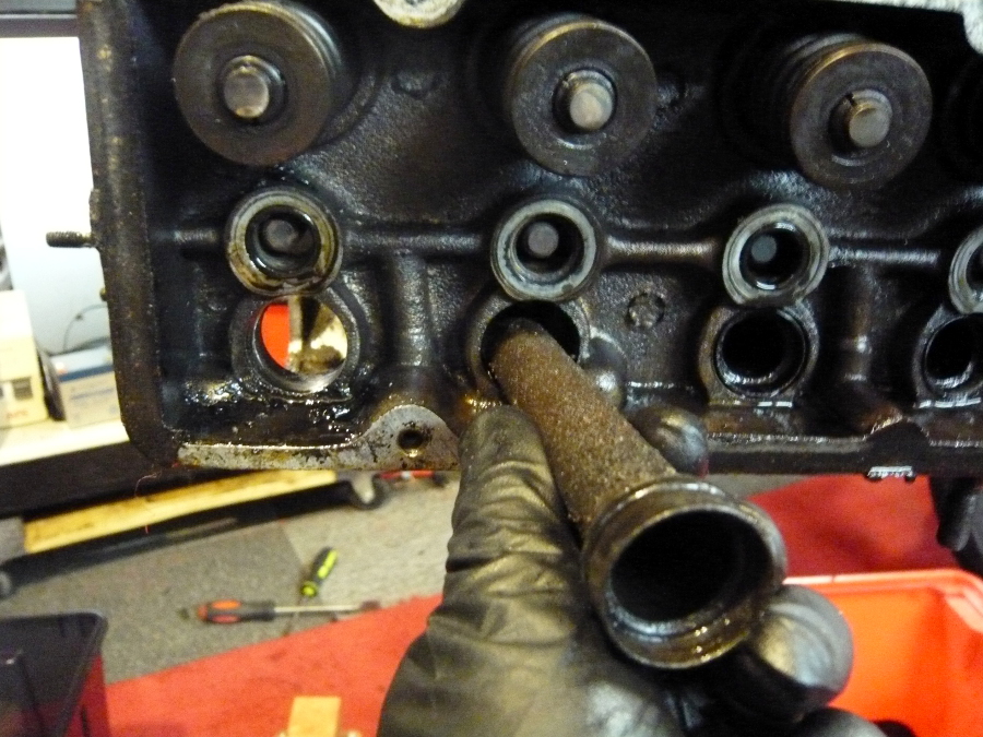

Then the pushrod tubes are pulled. If these are straight, I'll clean and paint them and use some new viton rings on reassembly. They're made of aluminum steel.

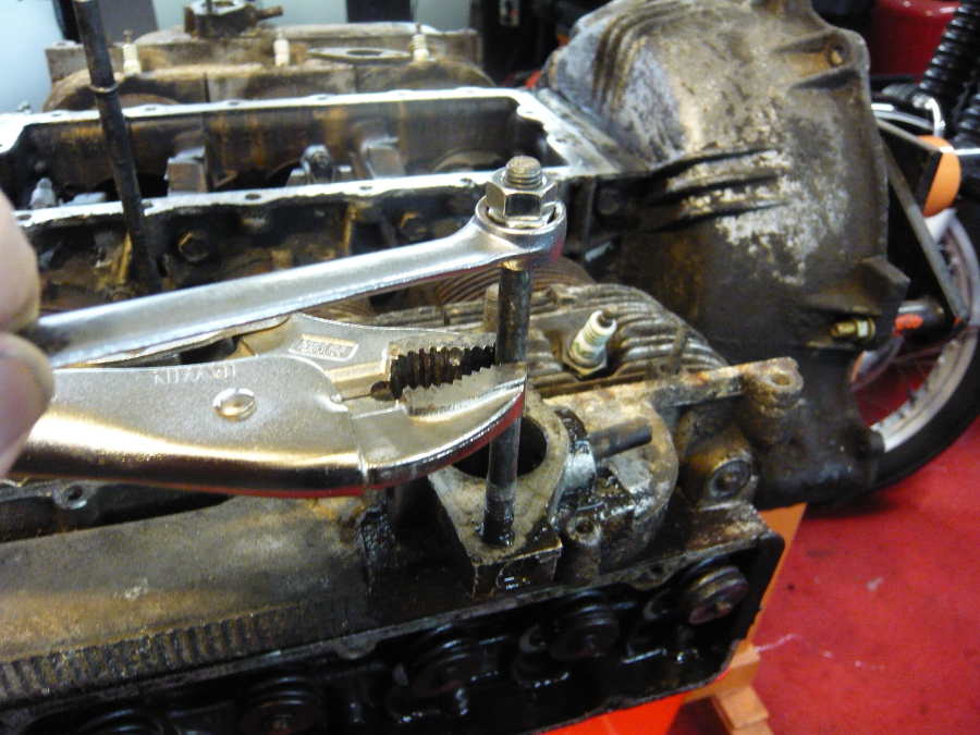

The head is free but before removal the carburetor mount studs need to be removed.
There are also nifty coil springs riveted to the bottom of the head. This pushes a small tube when heated upward to deactivate the choke on the carb. Not too different from the original heat pipe mechanism on my Chrysler 273 engine. Once removed the head can come off. A very slight tap with a mallet is all that was needed.

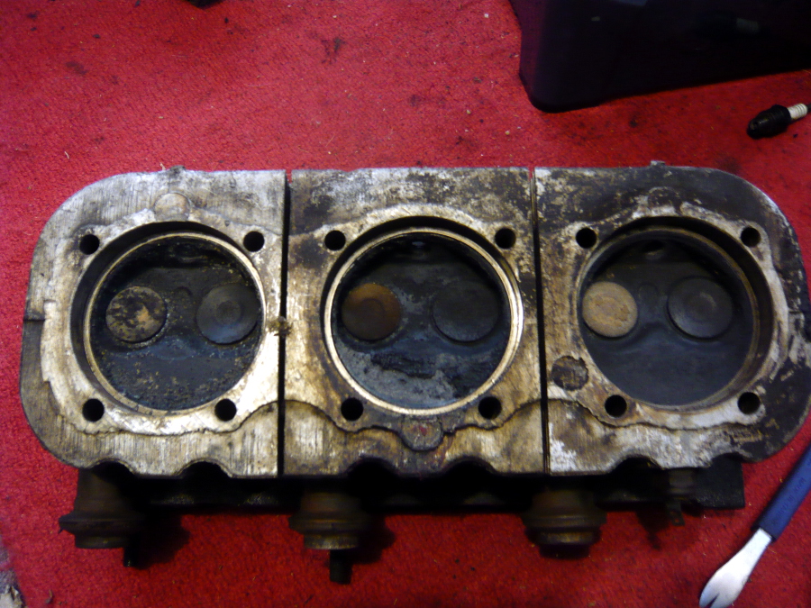

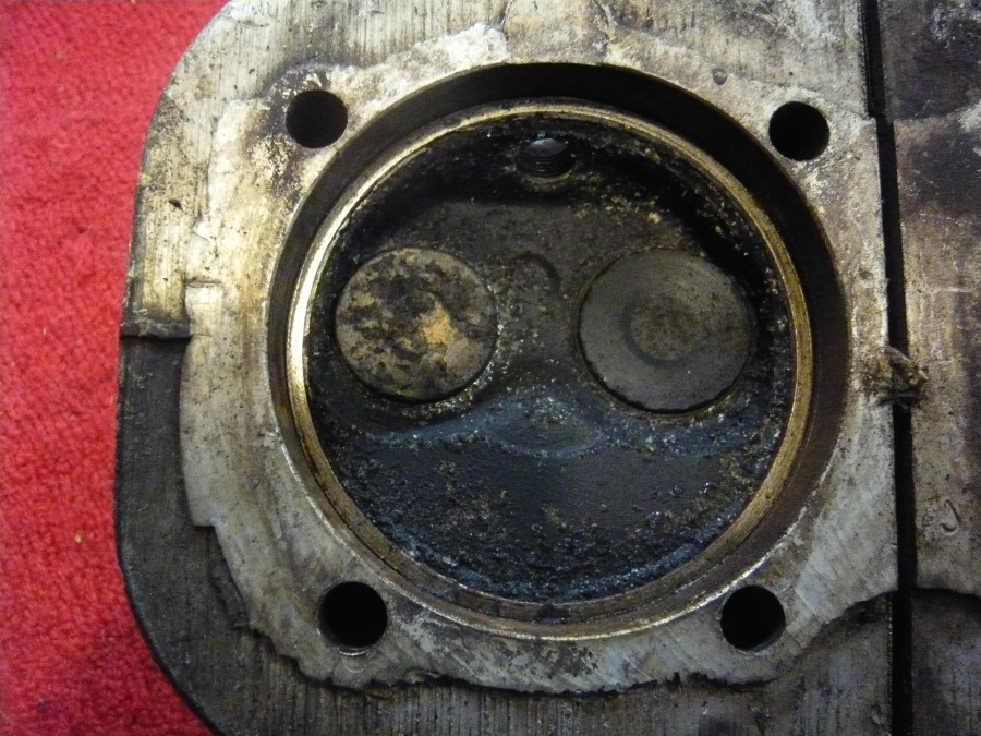

Off with her head!
Yeah. She's had some wear.

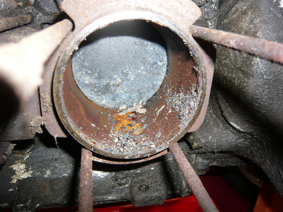

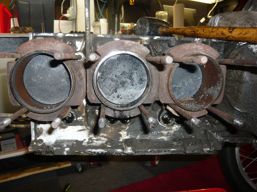

Cylinder #5 has quite a bit of bonus debris. (IMG:style_emoticons/default/icon8.gif) Doesn't matter. These cylinders and pistons are headed straight for scrap.
Now I need to remove the cylinders, pistons, and rods.
