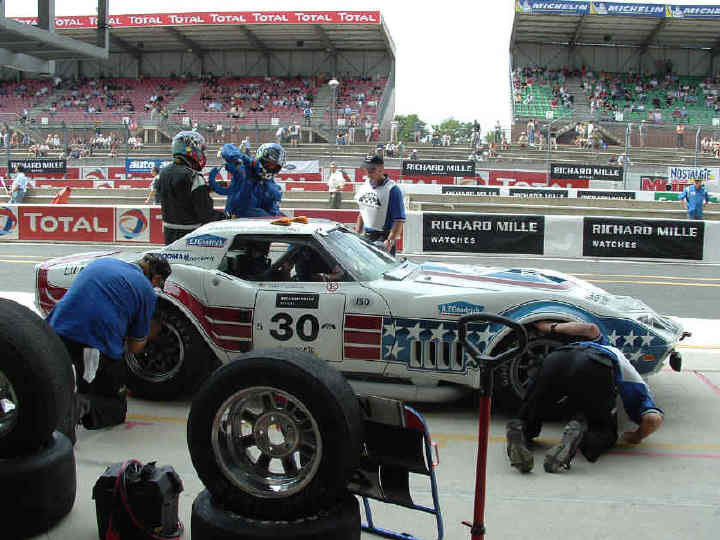

Had to do a gear change at the Lemans Classic , and stringed the rear of this corvette , boy the French Dudes were laughing they quit when we got our lap times though.Even commented afterwards how good it must of worked. (IMG:style_emoticons/default/smilie_pokal.gif)

oh ya heres the car R Dahnhauers Boss
