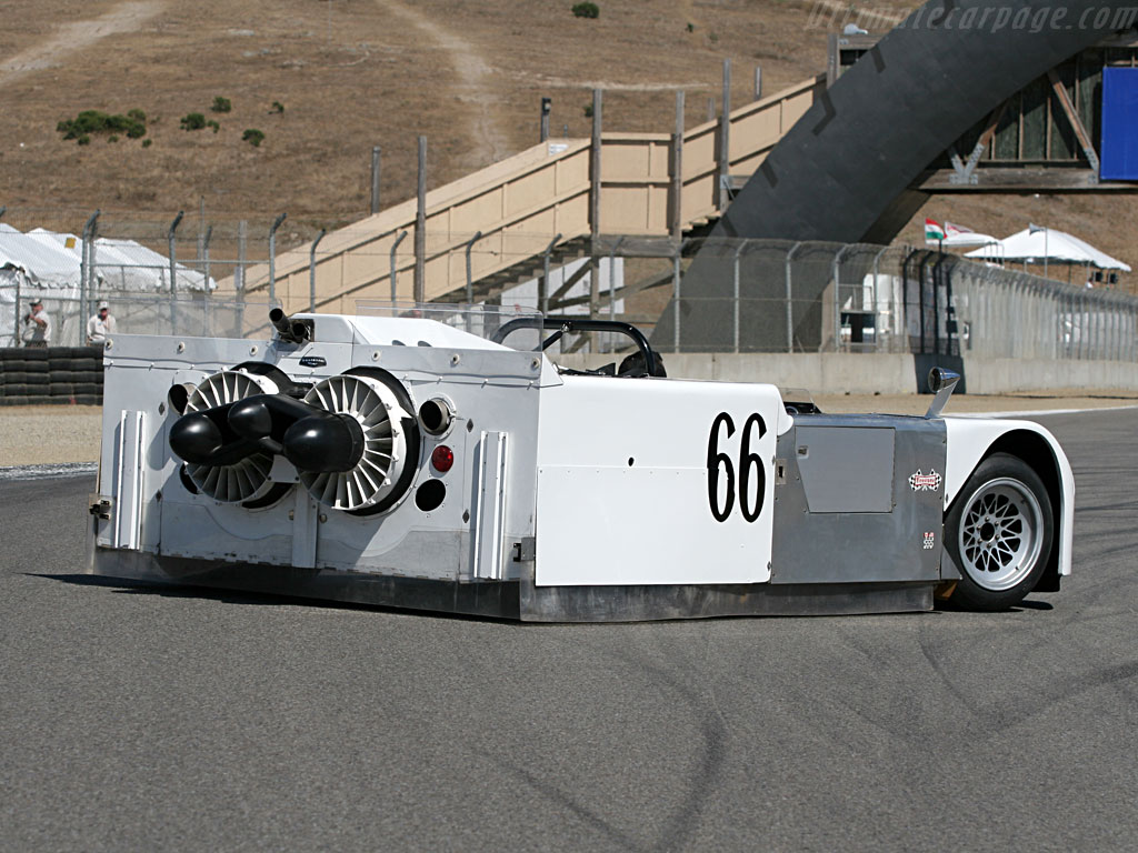

It actually creates a low pressure area that aids the fan to push the air out the bottom of the tin.
You could extend the flap all the way to ground and around the engine, turn the fan around to blow upwards and increase downforce...

QUOTE(Spoke @ Aug 13 2013, 10:27 AM) *
And suck up all the gravel on the road and blow it on the cars behind you. (IMG:style_emoticons/default/happy11.gif)

The 2J "sucker car" was banned from CanAm for that reason, plus the heat it threw off on the driver's behind it.
If they would have had any balls they would have been in front of Hall & Sharp and wouldn't have complained. (IMG:style_emoticons/default/av-943.gif)
