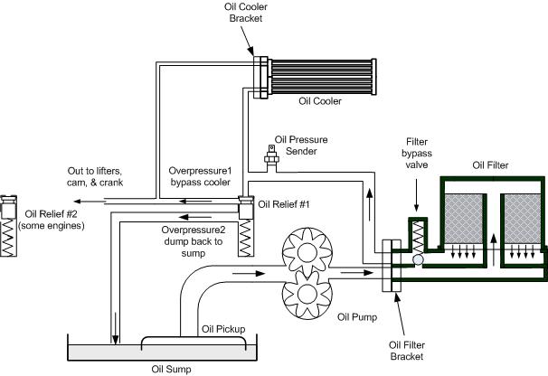

I would like to design a dry-sump type of system for my race car.
One thing I have found is that diagrams that show how the stock system works and how to modify it for other parts (coolers, dry sump, "full flow",etc) are hard to find.
So I made this diagram in Visio (CAD-like) so I can move parts around and ask the proper questions.
Does anyone have any suggestions or comments about making the diagram 100% correct before I start trying to modify it?
(IMG:http://www.914world.com/bbs2/uploads_offsite/i366.photobucket.com-10819-1376598242.1.jpg)
I could provide the original file, but not too many out there have visio.
My next step is to get out a spare case so I can see EXACTLY where these parts go, exactly what any adapter might look like, and identify where all of the galley plugs would be in the diagram.
Stu

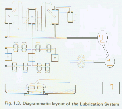

Is this what you need?
stugray
post Aug 15 2013, 05:27 PM
Posts: 3,825
Joined: 17-September 09
From: Longmont, CO
Member No.: 10,819
mrbubblehead, please post links to your diagrams.
Jeff Bowlsby, that is exactly the diagram I used to make mine.
since the original artwork is just that - artwork (bitmap) i decided to make a new diagram using a more modern medium so I can manipulate the pieces.
You might notice one difference: Mine shows that under extreme pressure situations, the first pressure regulator will dump back to the sump.
Notice the stock artwork "hints" at it with the open end on the lower right of the pressure regulator in the stock diagram.
This was based on a recent thread where 'worn' was troubleshooting a stuck regulator piston. (Brant has seen this as well)
I wanted to document what worn found during his rebuild:
http://www.914world.com/bbs2/index.php?sho...210207&st=0
That the system will dump back to the sump if the piston is "stuck" too far back in the relief bore.
My next hope is to identify where each of the case galley plugs are in the diagram.
I have seen many discussions about people plugging this or that, blocking off something over here, or installing things like a "Oil Filter, Block-off" or running the oil pumps that dont send any oil through the stock passages.
However during all of those discussions, there have been very few diagrams.
Stu

You labeled the oil filter bypass incorrectly.

I will update the diagram this weekend with the correction above and what i learn from navigating through my spare case this weekend

Better diagram:
(IMG:http://www.914world.com/bbs2/uploads_offsite/i366.photobucket.com-10819-1376724078.1.jpg)
And I have the spare case on the stand so I guess it is due for a galley plug upgrade next ;-)
Its another single relief.
Oh and I verifed that the "dump back to the sump" in the pressure relief valve is just channels cut on opposite sides of the bore.
Once the piston moves down far enough to expose the channels it dumps into the bottom of the relief valve where the spring is and there is just a hole to the sump down there.
Stu

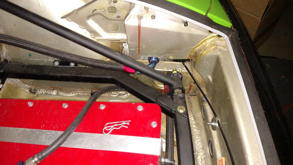

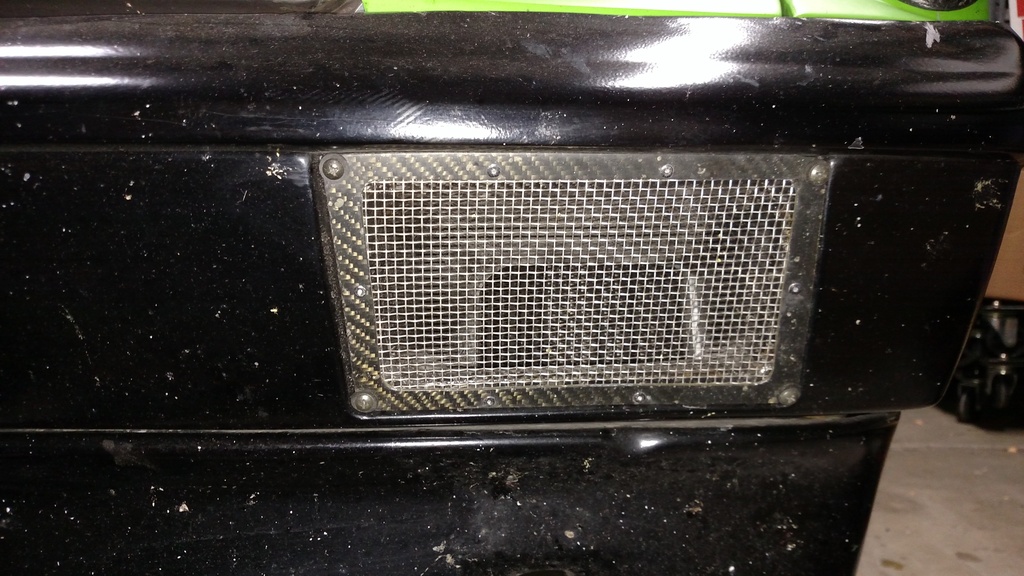

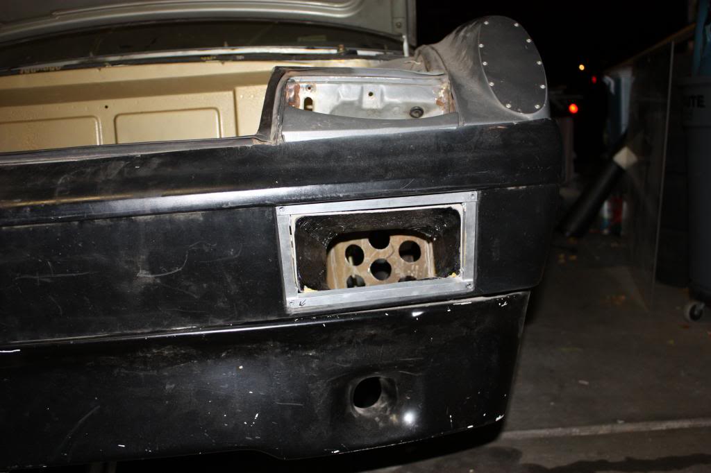

So I went ahead and used the car for one season (part of one anyway) with the new coolers in the front.
It worked very well. Almost too good.
Even after a hard 20 minute race I rarely saw much over 220.
This is with the dual front coolers in under the headlight buckets venting through the fenderwells.
Hole through front with tunnel and holes through fender:
(IMG:http://www.914world.com/bbs2/uploads_offsite/i366.photobucket.com-10819-1448336401.1.jpg)
Finished vents (complete with bugs and road clag):
(IMG:http://www.914world.com/bbs2/uploads_offsite/i366.photobucket.com-10819-1448336401.2.jpg)
Whole front end with view of cooler line routing:
(IMG:http://www.914world.com/bbs2/uploads_offsite/i366.photobucket.com-10819-1448336401.3.jpg)
Driver's side cooler hiding:
(IMG:http://www.914world.com/bbs2/uploads_offsite/i366.photobucket.com-10819-1448336401.4.jpg)

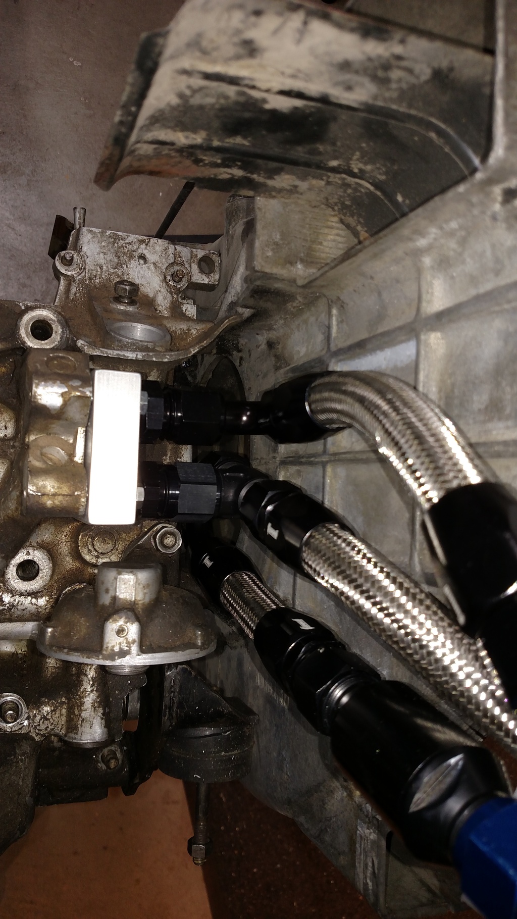

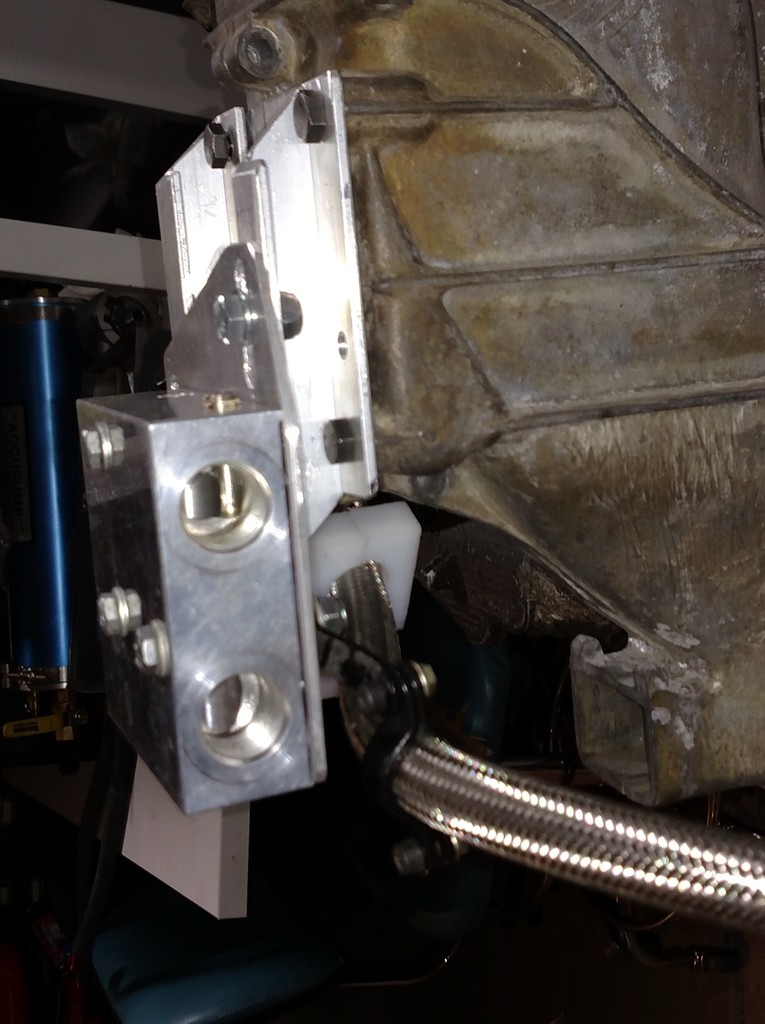

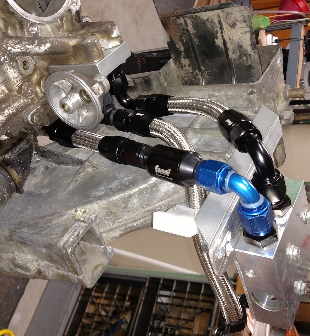

I have this currently just plumbed into the system with 12AN directly with a sandwich adapter at the oil filter.
Next will be to include a thermostat and remove the sandwich adapter.
And add an accusump oil accumulator.
I chose to go with Tangerine Racing's oil cooler block off plate.
It has 3/8 female pipe threads.
I converted those to 10AN between the engine and the thermostat and to the accusump.
The output side of the thermostat has 12AN adapters to go to the coolers.
Here's the bracket I made up to hold the (massive) thermostat with the associated plumbing.
I chose to include a one-way check valve between the engine high pressure input line and the thermostat.
Then the accusump feeds straight into the cooler block off plate.
So if I blow an oil cooler (most likely failure scenario) the accusump wont just dump all the oil out on the ground.
The check valve will force the reserve into the engine.
(It sure is nice to have a spare engine and stand laying around :-)

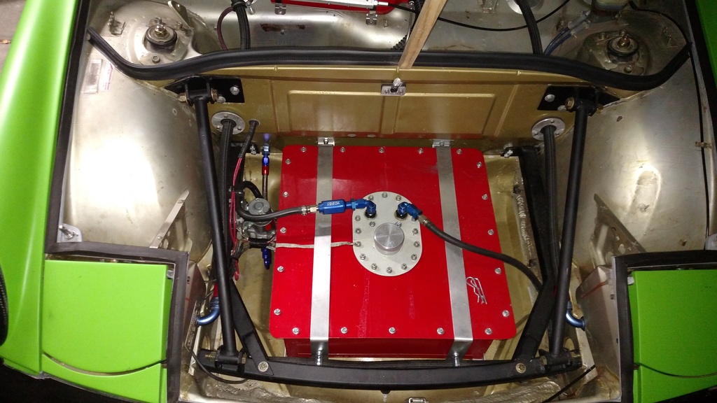

Here's a view as if you were laying under the car:
(IMG:http://www.914world.com/bbs2/uploads_offsite/i366.photobucket.com-10819-1448336401.5.jpg)
near the top of the pic is the line out from the engine to the thermostat.
middle line is routed over to the accusump.
lower line is the return from the thermostat, and you can see the check valve.
The middle & lower line combine with a tee and feed into the engine IN line (would have been out from stock cooler).
Here are some more pics:
(IMG:http://www.914world.com/bbs2/uploads_offsite/i366.photobucket.com-10819-1448336401.6.jpg)
Here's the side out from the thermostat where the coolers will go in:
(IMG:http://www.914world.com/bbs2/uploads_offsite/i366.photobucket.com-10819-1448336402.7.jpg)
I have had that mess up under the car and it will fit once the stock cooler comes out.
I also have to contend with Murphy's law: The absoulte perfect location for all of this plumbing is where the rear suspension ear reinforcement bar crosses the engine bay to the firewall.
Makes the placement very tricky...
I hope to put it on the car this winter, but no rush.
I'll get more pics as I do that.

Finally updated my drawing to match my current configuration:
(IMG:http://www.914world.com/bbs2/uploads_offsite/i366.photobucket.com-10819-1474723587.1.jpg)
The thermostat in the pics above never actually worked right so I took it out and plumbed straight across the bracket.
If the pressure at the "low oil pressure switch" drops below ~5 PSI it opens the solenoid on the accusump.
There is a one way check valve to keep the accusump from dumping back towards an oil cooler failure.
I also have a manual valve on the accusump to avoid accidental discharge.
And I have the tangerine racing oil pressure relief valve upgrade
Kansas 914
