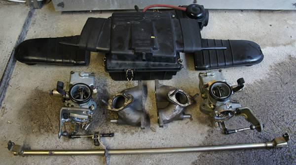

Does anyone have any pictures of a 914 with dual carbs from the factory?
Never seen one and I can't imagine they are all gone, if in fact they ever existed...

I don't have a pic of them installed in a 914 but here is what they look like ...

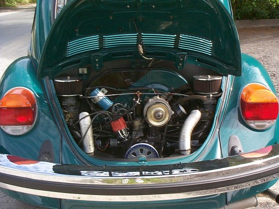

AJ and Berg were people I looked up to when I built my 1776. Dual Kadrons were great on my Type 1. They were much easier to maintain than the dual 42 Webers.
I miss this car...
