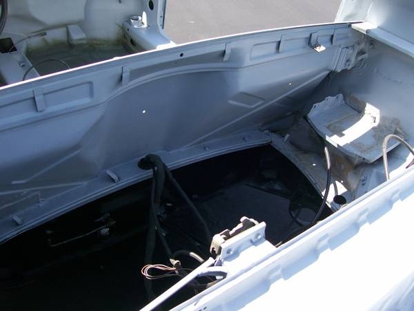

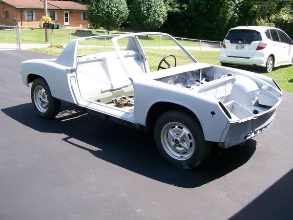

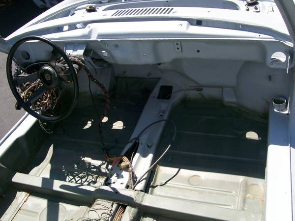

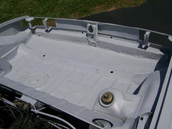

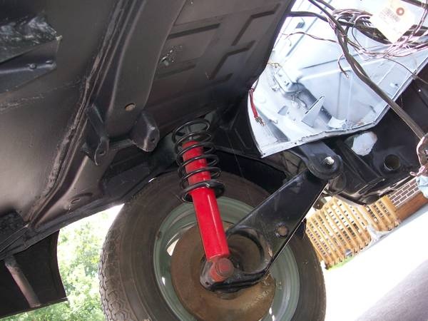

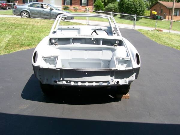

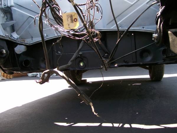

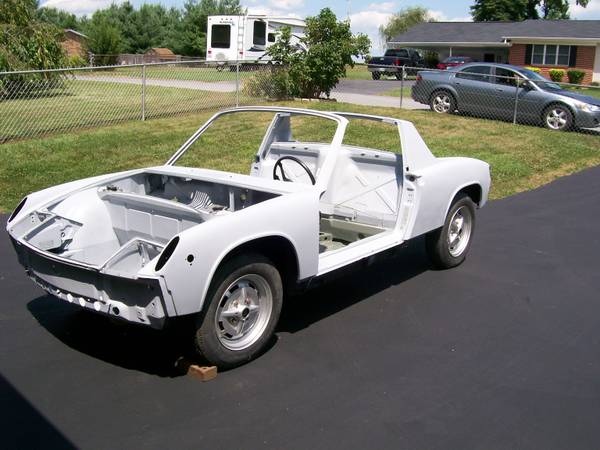

Here is what I am picking up:
(IMG:http://www.914world.com/bbs2/uploads_offsite/i1227.photobucket.com-16328-1378055385.1.jpg)
(IMG:http://www.914world.com/bbs2/uploads_offsite/i1227.photobucket.com-16328-1378055385.2.jpg)
(IMG:http://www.914world.com/bbs2/uploads_offsite/i1227.photobucket.com-16328-1378055386.3.jpg)
(IMG:http://www.914world.com/bbs2/uploads_offsite/i1227.photobucket.com-16328-1378055386.4.jpg)
(IMG:http://www.914world.com/bbs2/uploads_offsite/i1227.photobucket.com-16328-1378055386.5.jpg)
(IMG:http://www.914world.com/bbs2/uploads_offsite/i1227.photobucket.com-16328-1378055386.6.jpg)
(IMG:http://www.914world.com/bbs2/uploads_offsite/i1227.photobucket.com-16328-1378055386.7.jpg)
(IMG:http://www.914world.com/bbs2/uploads_offsite/i1227.photobucket.com-16328-1378055386.8.jpg)

QUOTE(ky914 @ Sep 1 2013, 10:09 AM) *
That car had some major surgery done to it. Make sure it was done well and the car is square and didn't twist while being welded on.
That was my major concern. Seller stated that the Long's haven't been touched at this point and are good - although there is some pitting. Anything I can do to make sure it is square when I pick it up? Missing the doors so I can't tell from the door gaps.

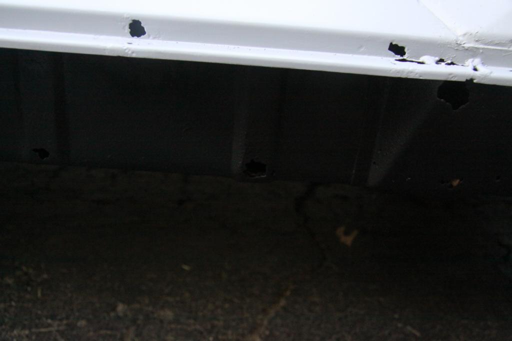

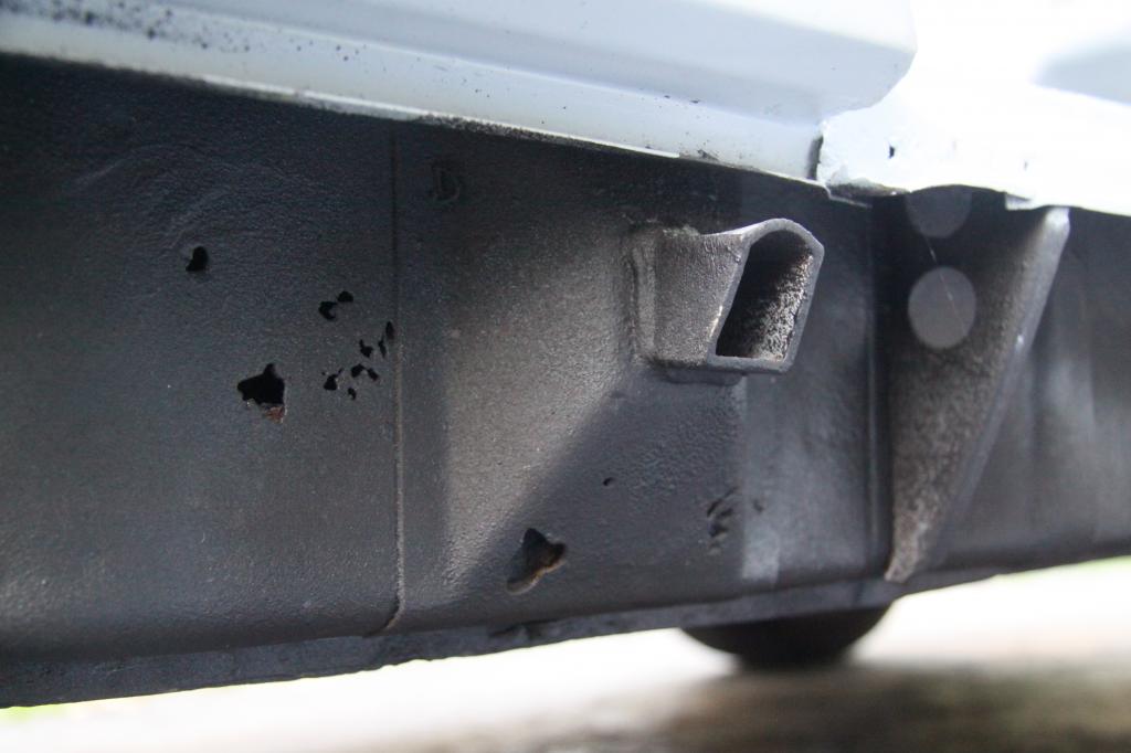

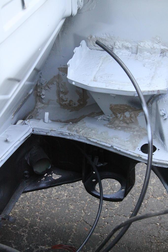

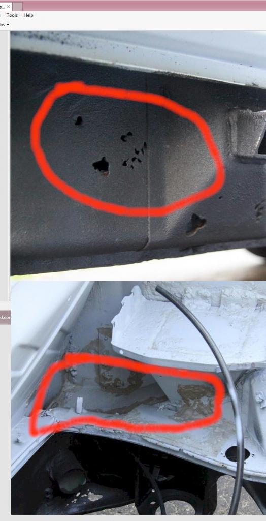

I would like some comments on the condition of my tub. I picked a few of the pics from the album. Hopefully it will be representative. What I am wondering is:
Opinions on the condition of the Longs: Average / Below Average / Must be fixed ASAP. I am not going for a concours restoration, but I don't want to put a lot of work into something that will be worthless in 5 years either.
Here is a pic of the worst part of the longs:
(IMG:http://www.914world.com/bbs2/uploads_offsite/i1227.photobucket.com-16328-1379005679.1.jpg)

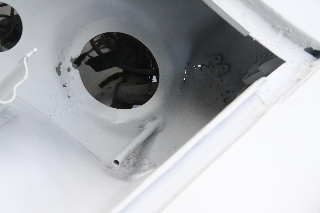

Hell Hole has had some repair already. What attention do I need to do here before I start a swap from my parts car?
(IMG:http://www.914world.com/bbs2/uploads_offsite/i1227.photobucket.com-16328-1379005679.2.jpg)
Some bad spots on the door sills:
(IMG:http://www.914world.com/bbs2/uploads_offsite/i1227.photobucket.com-16328-1379005679.3.jpg)
Some more questionable metal:
(IMG:http://www.914world.com/bbs2/uploads_offsite/i1227.photobucket.com-16328-1379005679.4.jpg)
Is this tub in need of a ton more work? What are your suggestions? Any advice from the experts on this board would be appreciated.
Thanks,
Michael

aside from the home made rear trunk pan - the hell hole might be an issue.
clearly some of the rust you are showing is non structural.
this is the thread I like to scare everyone with : )
http://www.914world.com/bbs2/index.php?showtopic=16748

Just go buy a mig welder and an angle grinder tomorrow.
If you don't know how to weld yet, you will before you start swapping stuff on to the car.
First things first. BRACE YOUR DOORS! You are going to need to cut into your longs a little to clear the rust that Jim has pointed out. If you don't brace your doors, you will twist that new chassis. Lots of threads on door braces. Not bracing the doors is one of the biggest mistakes that noobs make when restoring these cars.
Good luck, we will help you along the way.

If I start cutting out everything that looks a little like swiss cheese, I will likely be replacing a huge percentage of the metal. I see rust evidence a little at the top of the windshield, in the trays under the headlights, in the fresh air vents behind the doors, etc... etc... etc... There has to be a point where it is ok to grind out the rust with a wire wheel, hit with metal ready or ospho to keep more rust from coming back and move on without cutting out chunks of metal.
I think you only learn where that line is from experience. Seems like the answer I am getting from the experienced people on this forum is you should always cut out the rust and put in new metal. If that is the case, my tub may be too far gone already and I am better off to resume looking for a better candidate.
boogie_man
post Sep 12 2013, 01:24 PM
Posts: 308
Joined: 22-April 11
From: So Cal
Member No.: 12,969
Do not like that rear floor pan at all but the good thing is you have access to all the bad areas. Go restoration design's web site to map out what you need like the battery tray kit and rear truck floor pan some of the smaller rust issues can be patched. If you change the rear trunk floor pan, you can also repair that rear body
panel to get it straight. You also get the jack mounts for the rockers where i've seen
people completly replace then or section just the lower half. As these guys said, brace and secure that car to keep it square and straight. Take your time and it will
reward you with a nice long lasting ride.
