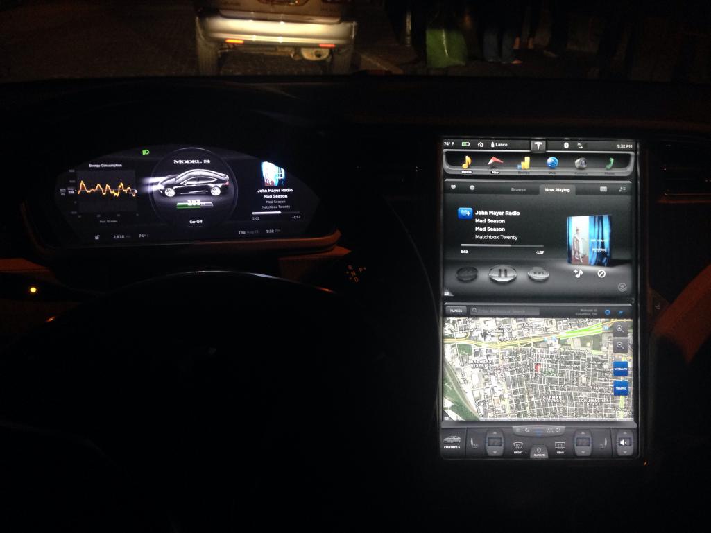

Here's the Tesla-S dash that got me thinking. I don't know that I'd go to THIS extreme, but it was cool as hell.
