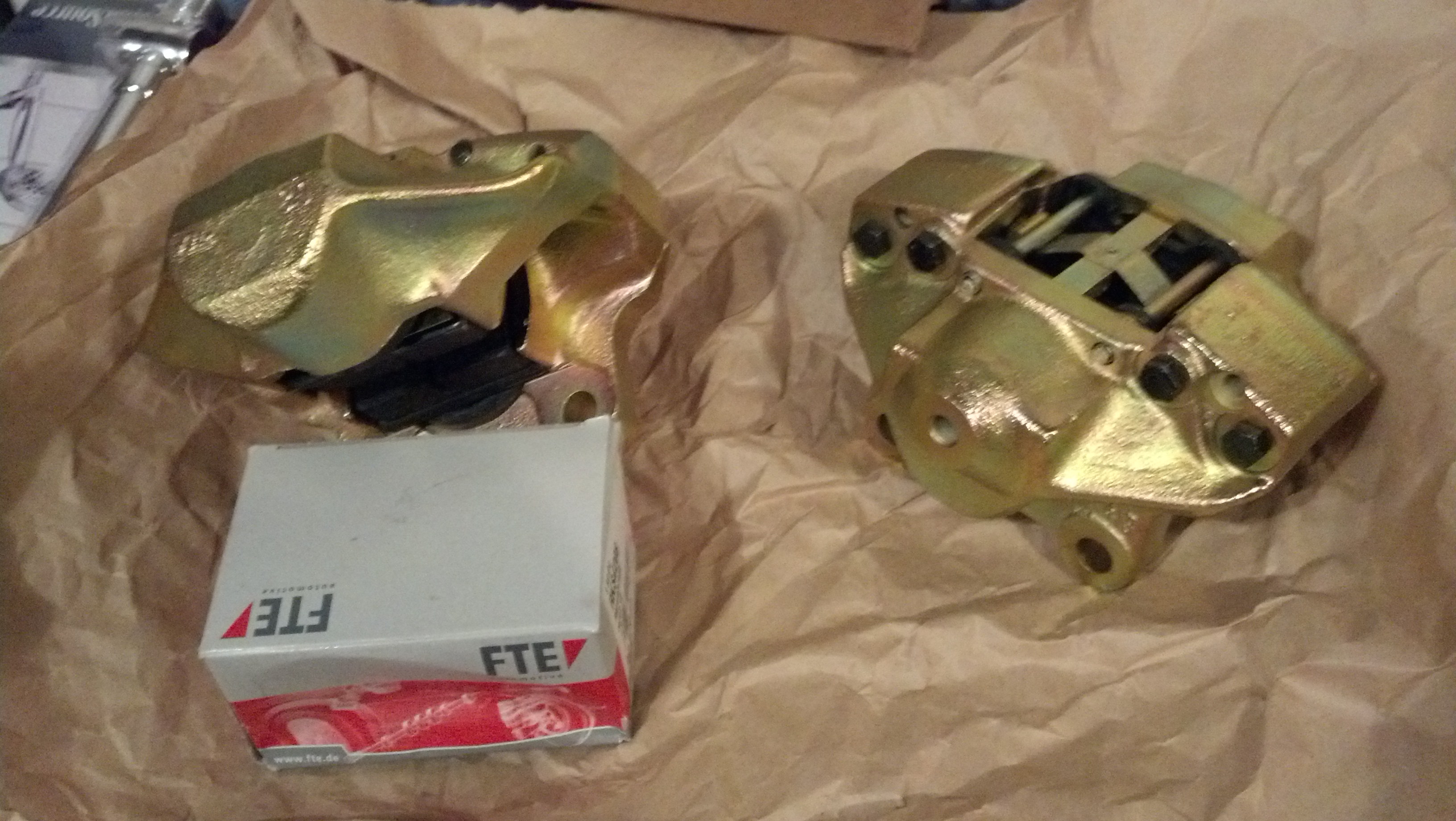

I am finally getting around to doing this, i am wondering who else has done this and whether you have any words of wisdom, etc.
One thing to know, I have newly re-done trailing arms, with the new hubs and bearings already installed, also new pivot shafts and bushings as well -
this week i was able to order my newly reman. calipers from PMB, so "while i am at it" is the catch phrase to use here i think, i also had them send me new brake hoses and master cylinder(mine just went bad, so i have not been able to drive the car).
So i have not seen anyone else that did this group buy post any thread or pictures on this process, so i figured i would do this when i get started, but would appreciate the advice! I have done brakes on many other vehicles but not my 914
here is what i already have done -
-new shocks and springs- rear: sport bilistein's with 100#springs, new factory anti-roll bar bushings.
thanks Eric and Bill H. for getting the group buy put together, and Eric for the ONE-STOP-SHOP and providing all the necessary components!!!!.
Phil
