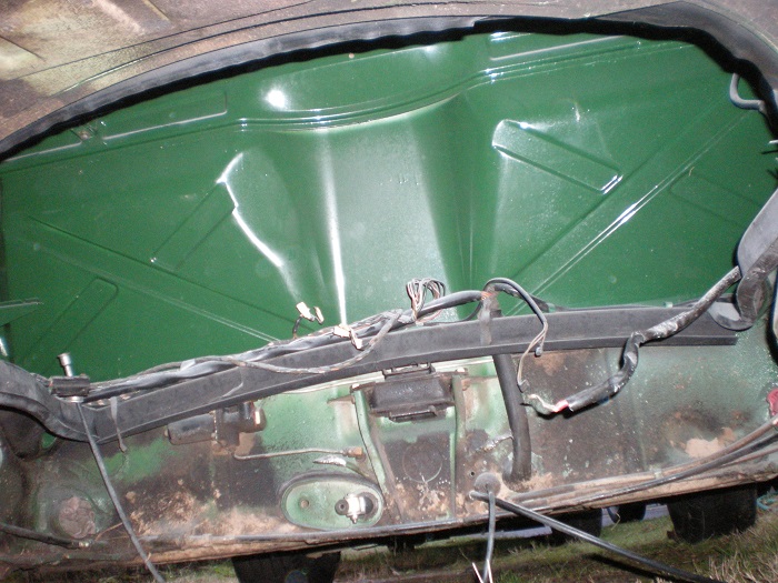

I agree, after cleaning off the black underside of my 72 - 4, this is what I found.
Underside:
Wheel housing:
Floor pan:
Under body:
Paint close And the dove gray primer:
Seam sealer

post Sep 22 2013, 06:54 AM
Posts: 241
Joined: 4-October 09
From: Finland
Member No.: 10,886
I have asked Porsche Classic for help to have correct painting to my six. It took 3 months to have answer and it was: Please tell your 914:s VIN.
