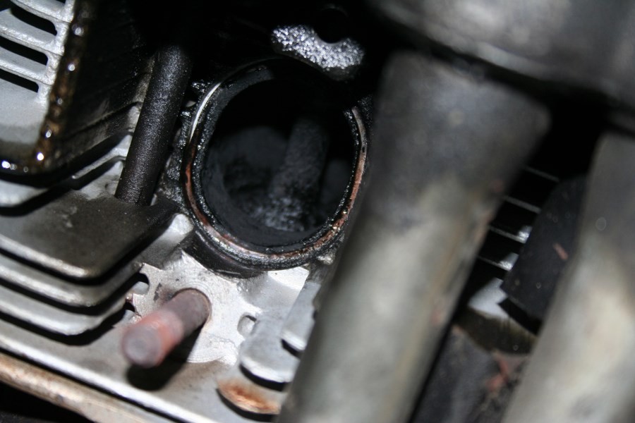

Could this leak be coming from a crack in the head at the valve guide?

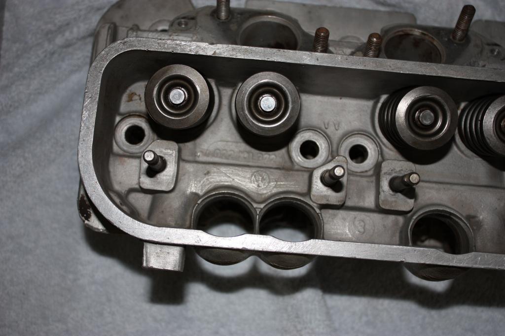

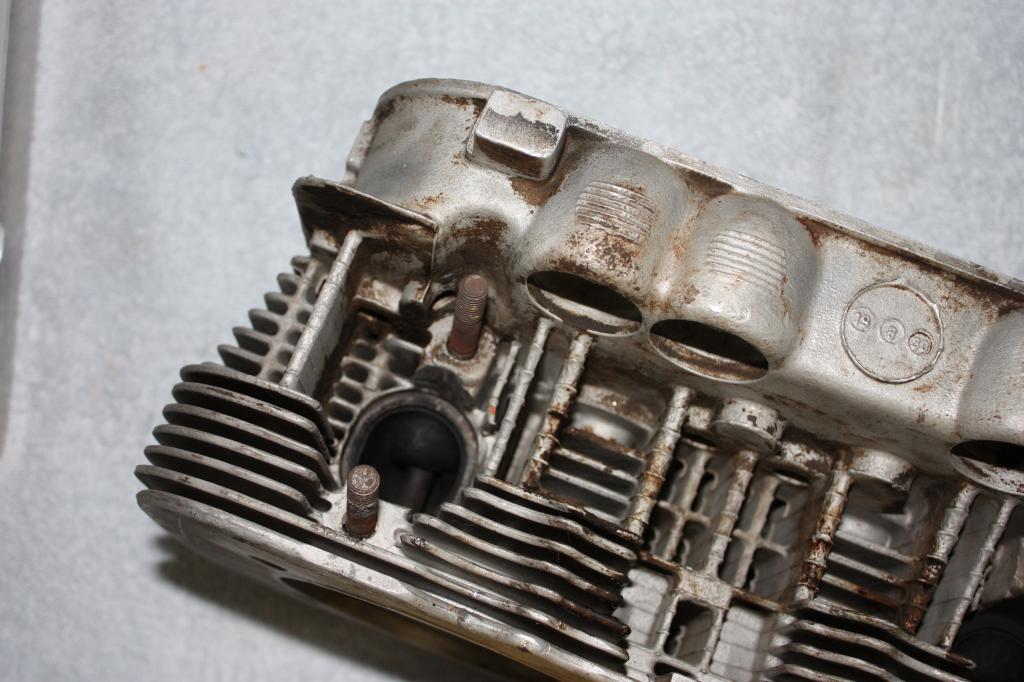

then I took some pics of a head laying right next to me:
(IMG:http://www.914world.com/bbs2/uploads_offsite/i366.photobucket.com-10819-1380059313.1.jpg)
(IMG:http://www.914world.com/bbs2/uploads_offsite/i366.photobucket.com-10819-1380059313.2.jpg)
So after looking at those pics... If the head nut/stud to the left of the above pic gets really loose, then the oil could leak out where you are showing.

OK, I'm pretty sure the inside of the exhaust port including the valve and valve stem, shouldn't be covered with wet glistening oil. (It's actually worse than the picture shows). All the other exhaust ports are dark grey with carbon but they are totally dry. I need some experienced opinions here unless you just can't help making remarks about silicone and bitch slapping. (IMG:style_emoticons/default/laugh.gif) This is the number 2 exhaust port. I found the smoke the car was making was worse doing down hill with a right turn. Since number 2 is the forward left cylinder I guess this makes sense. Does anyone besides SLITS agree with this? Looks like the engine comes out and the head comes off. (IMG:style_emoticons/default/smash.gif)
The part that I was commenting on was the drip of oil coming from ABOVE the stub pipe, which cannot be coming from inside the exhaust port.
Or do you not see the drip coming off of the cooling fin?
I was being serious both about the leak and the fact that you should not use silicone on the tube seals....
Looks like you have a leak both inside & outside that cylinder.
Maybe from that bolt AND from inside. Maybe related?

Thanks. It looks like the engine comes out. (IMG:style_emoticons/default/sad.gif) The push rod tubes aren't leaking and never have on this engine because of the high temp sealant that was used. So, which is better, carbs or fuel injection?
