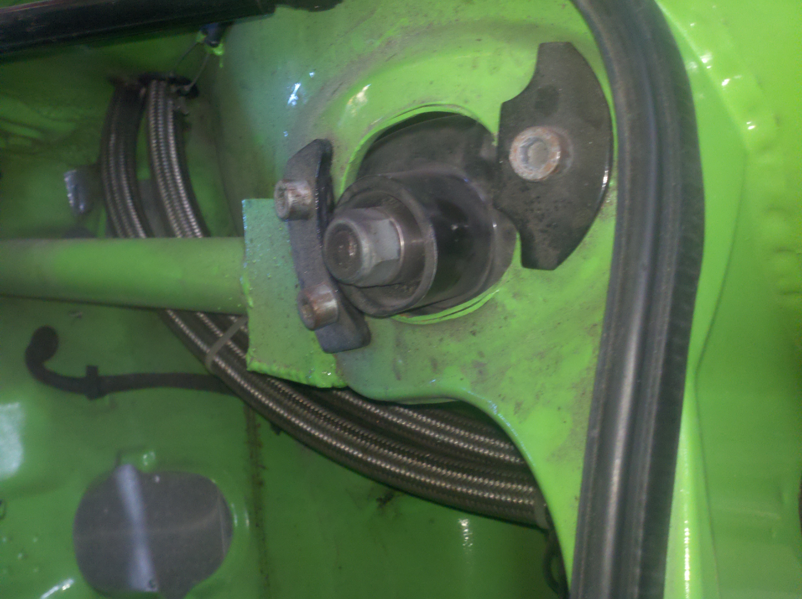

Just curious. Does this car have suspension or chassis mods to get you that claimed 2.7 degrees of negative camber? That seems like a lot of negative camber for a stock configuration.
-Josh
wndsrfr
post Nov 22 2013, 08:45 AM
Posts: 1,454
Joined: 30-April 09
From: Rescue, Virginia
Member No.: 10,318
QUOTE(jhadler @ Nov 21 2013, 01:16 PM) *
-Josh
Here's a shot of the drivers side front suspension tower.....you can see it has a aftermarket monoball I think it is....also where the cage is tied in to the tower.
Also, to answer Randal's question....yes, there's good stiffening from rear consoles and towers to the cage.
