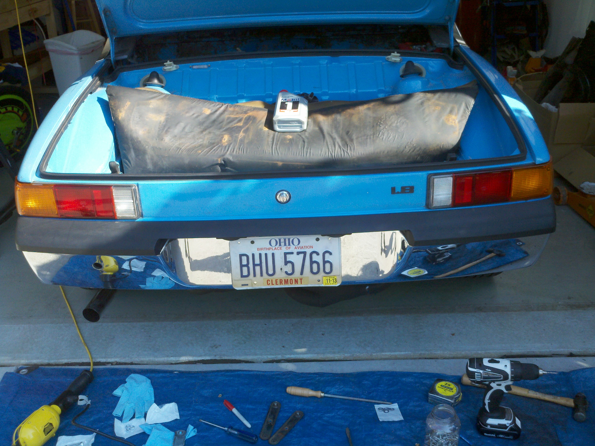

I did the rear first, for no particular reason.

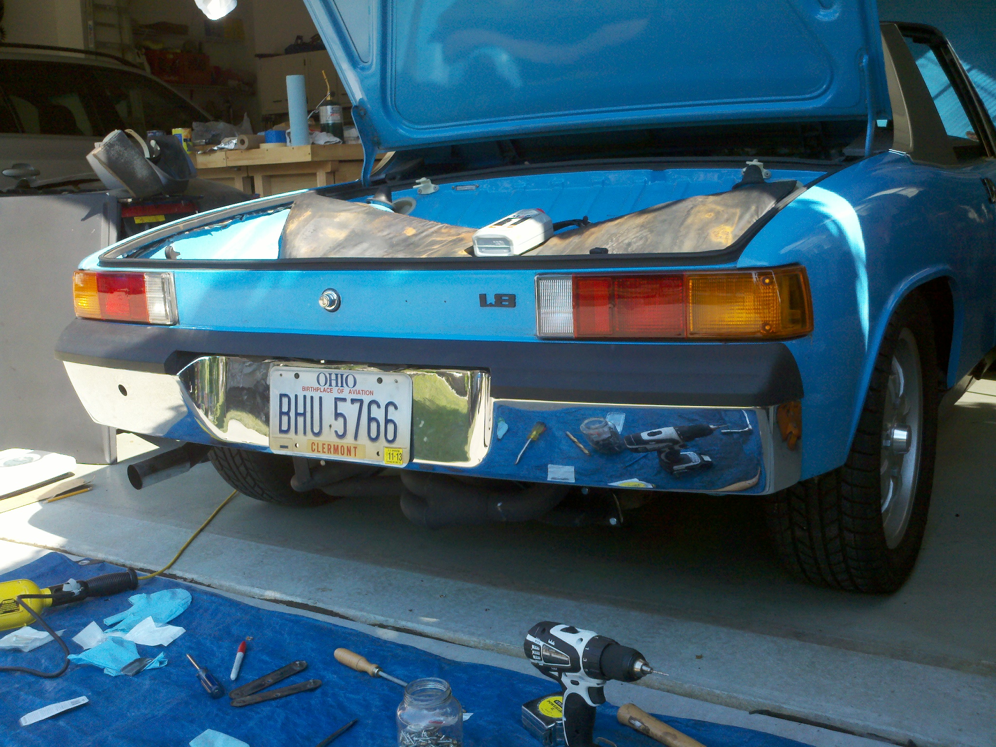

The first order of business is to remove the bumper. This is accomplished by first disengaging the bumper sides from the retaining rails on both sides of the car. Simply pull the bumper sides away, and they will peel right out. Next, unscrew the license plate lights and disconnect the wiring. Finally, remove the two 19mm bolts located in the holes on the underside of the bumper. The bumper should now slide right off, but remember – it weighs 50 pounds, so be prepared.
I removed my valence as well. Not sure if it was necessary, but it needed some dents removed and paint anyway, so what the heck, it was only a few screws.
Next, you will need to crawl under the car with a 17mm socket and remove the 3 bolts holding on each shock and work the shock out. I recommend putting the bolts back in place to keep water out.

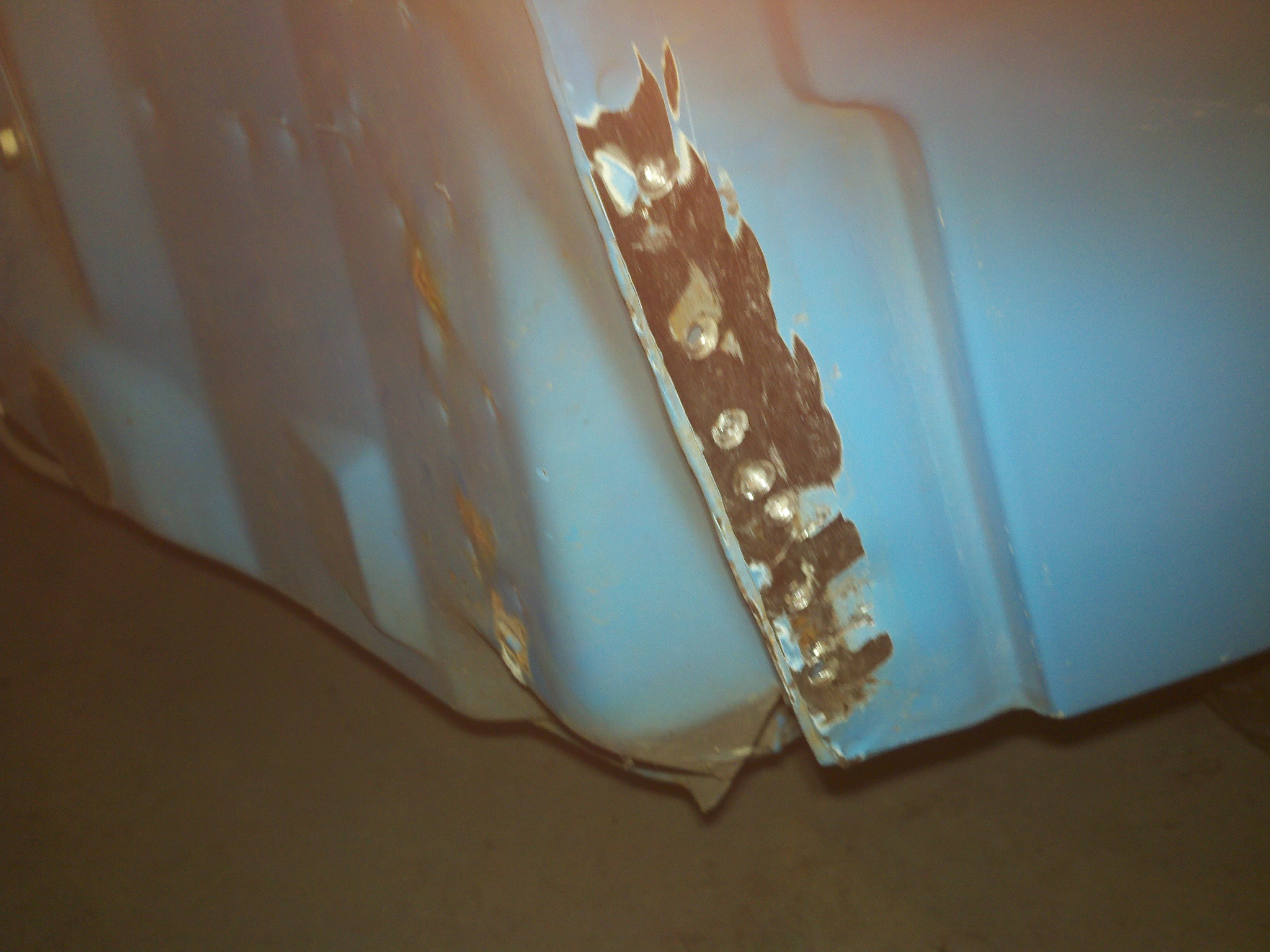

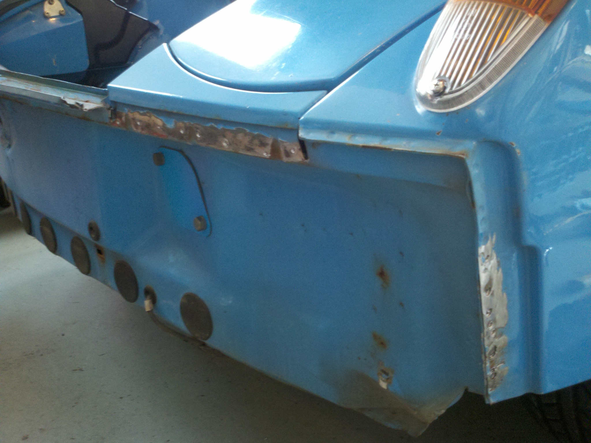

Now for the fun part. You will need to remove those retaining rails from each side of the car. They are spot-welded on in 5 or 6 spots. There are a couple of ways to do this. You can use a grinder or cutting disc to grind through the welds, or you can buy yourself a spot weld cutter to drill them out. Or if you are an idiot like me, you can attempt to use a regular drill bit and drill them out, and then weld up the resulting holes. I bought a spot weld cutter before I did the front.

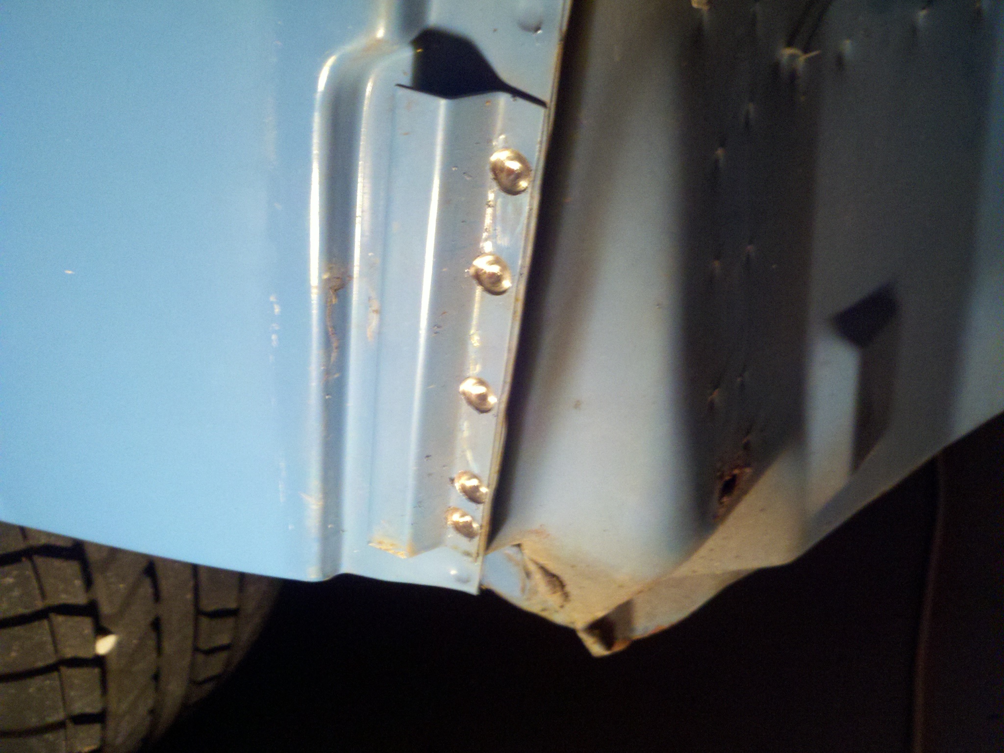

I forgot to take pictures of the rear, but here is one of the front – same procedure for both.
As far as the bodywork required to touch these areas up, I welded up the holes and ground it flat. I then taped off the area, primed it and used a rattle can of a fairly close blue that I found at Lowes. When the bumper is installed, these areas don’t show much, but they still needed to be painted.

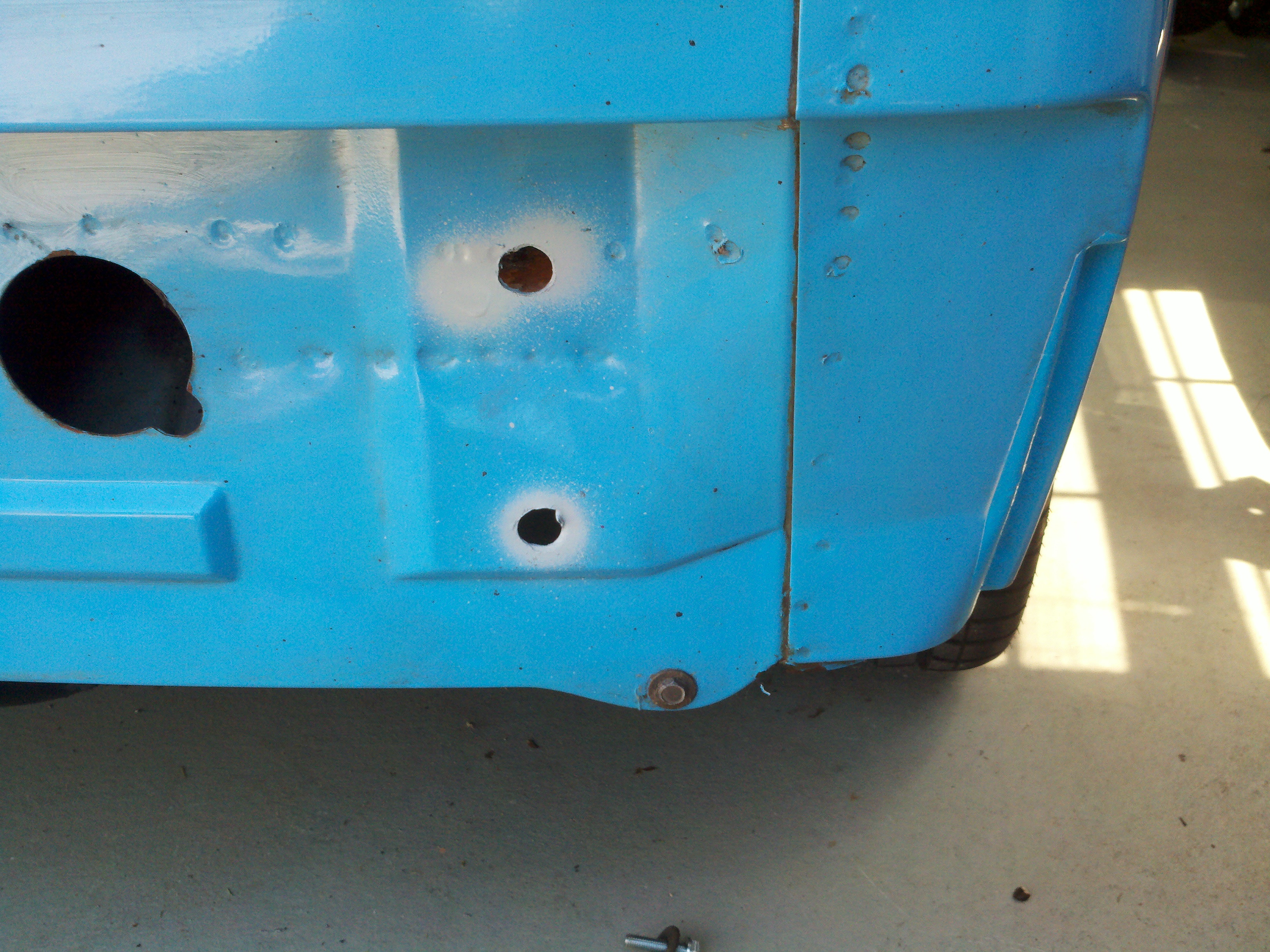

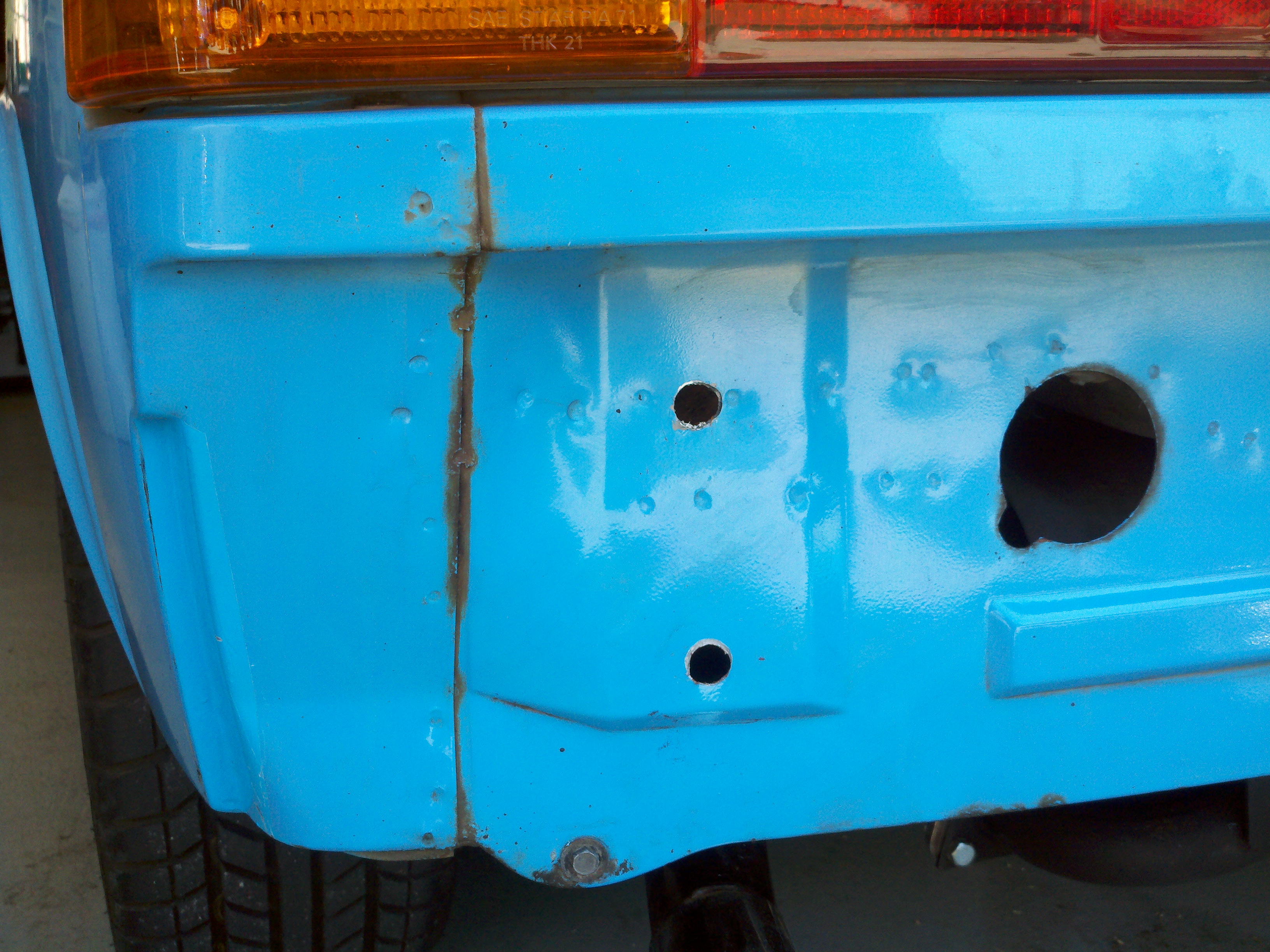

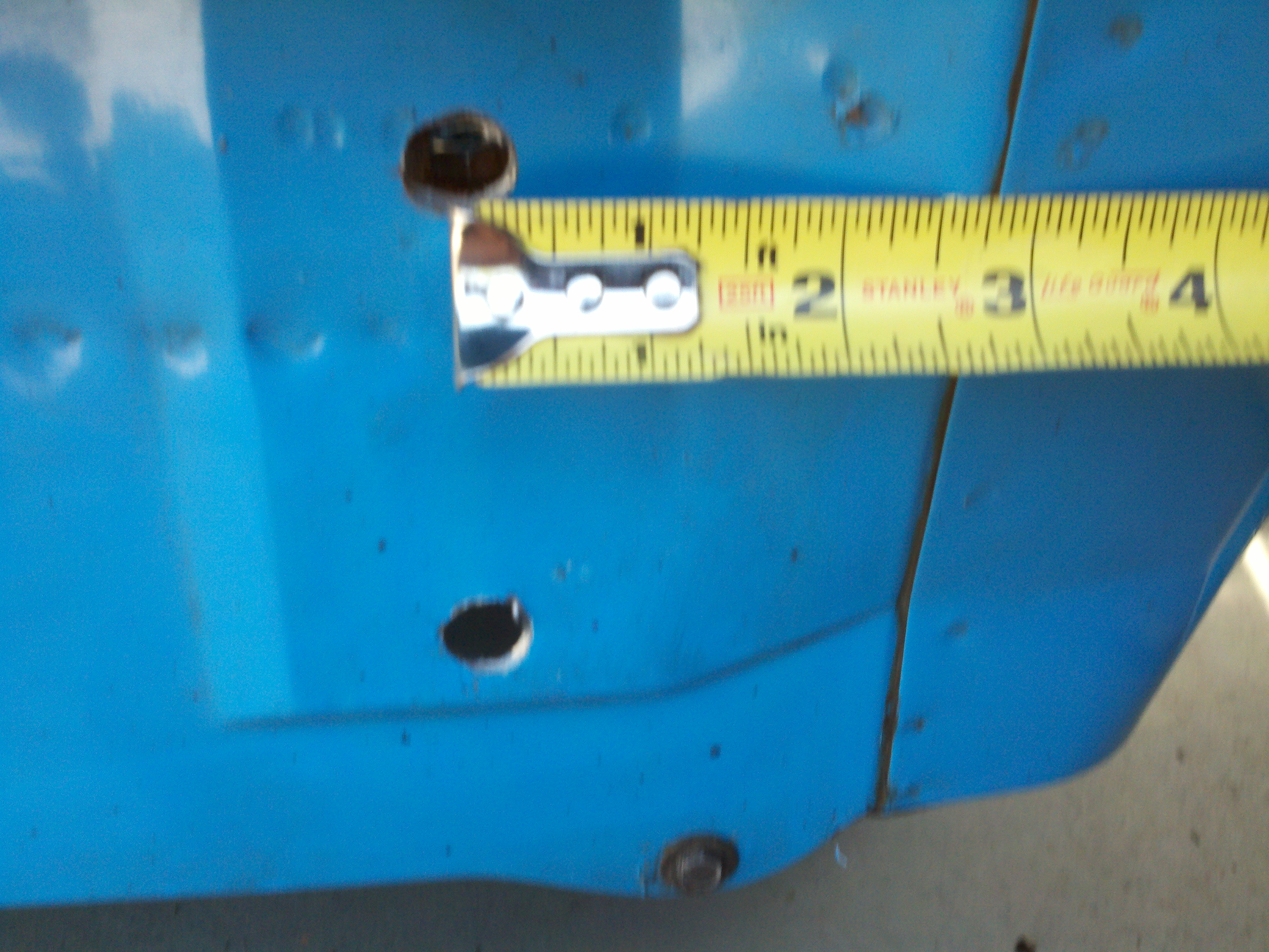

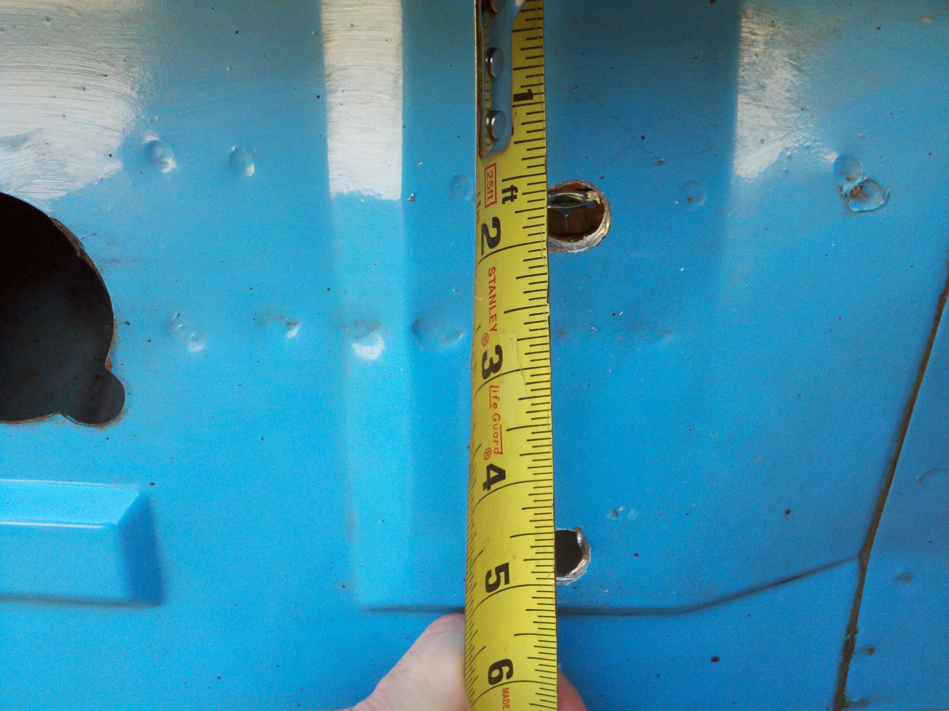

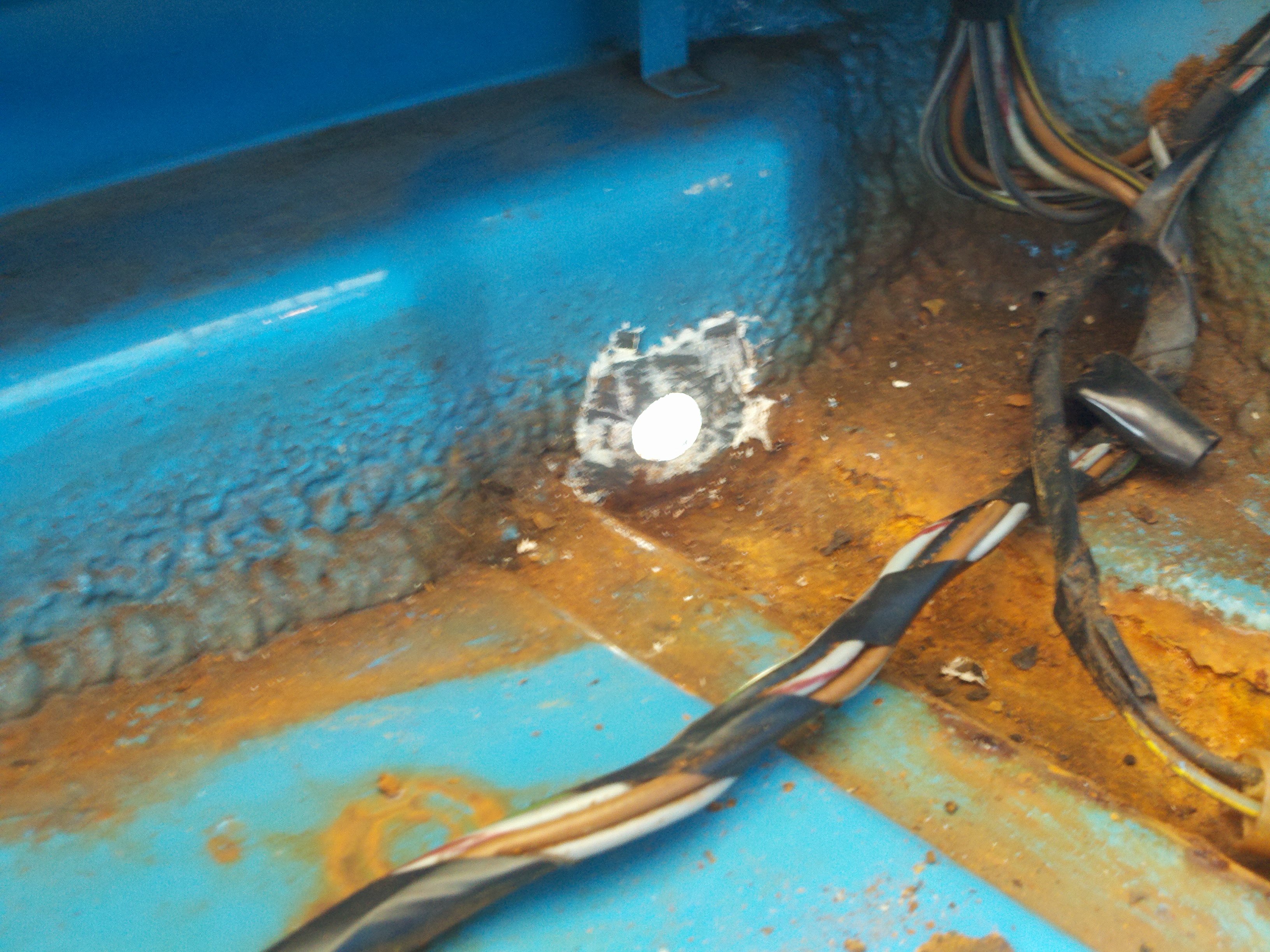

Now the part that had me nervous – where do I drill the 4 holes for the early bumper? Right where I tell you, that’s where. On each side, you will see that the rear panel has rectangles formed into it. The holes will be roughly centered in that rectangle. Mark your top hole first by measuring 2 ¾ inches horizontally from the body seam shown in the picture. The vertical mark can be made 1 3/4 inches from the ledge underneath the taillight as shown. The bottom hole is also 2 ¾ from the seam and 4 ¾ from the ledge.
bigkensteele
post Nov 24 2013, 10:27 PM
Major Member
Posts: 2,200
Joined: 30-August 04
From: Cincinnati, OH
Member No.: 2,660
Using one of your dog bones (they are the same front and rear), verify that your marks are centered in the holes of the dog bone. If not, adjust the bottom mark accordingly.
The point of no return – drill your holes. I think that the factory holes are about 5/8, but I got by with ½ on the rear. Use a punch to dimple your mark, or drill a pilot hole – either method will keep your larger bit from walking. I used a regular bit on the rear, and it tended to bind up and make for an ugly hole. On the front, I wised up and used a step bit from Harbor Freight. They turned out much nicer.

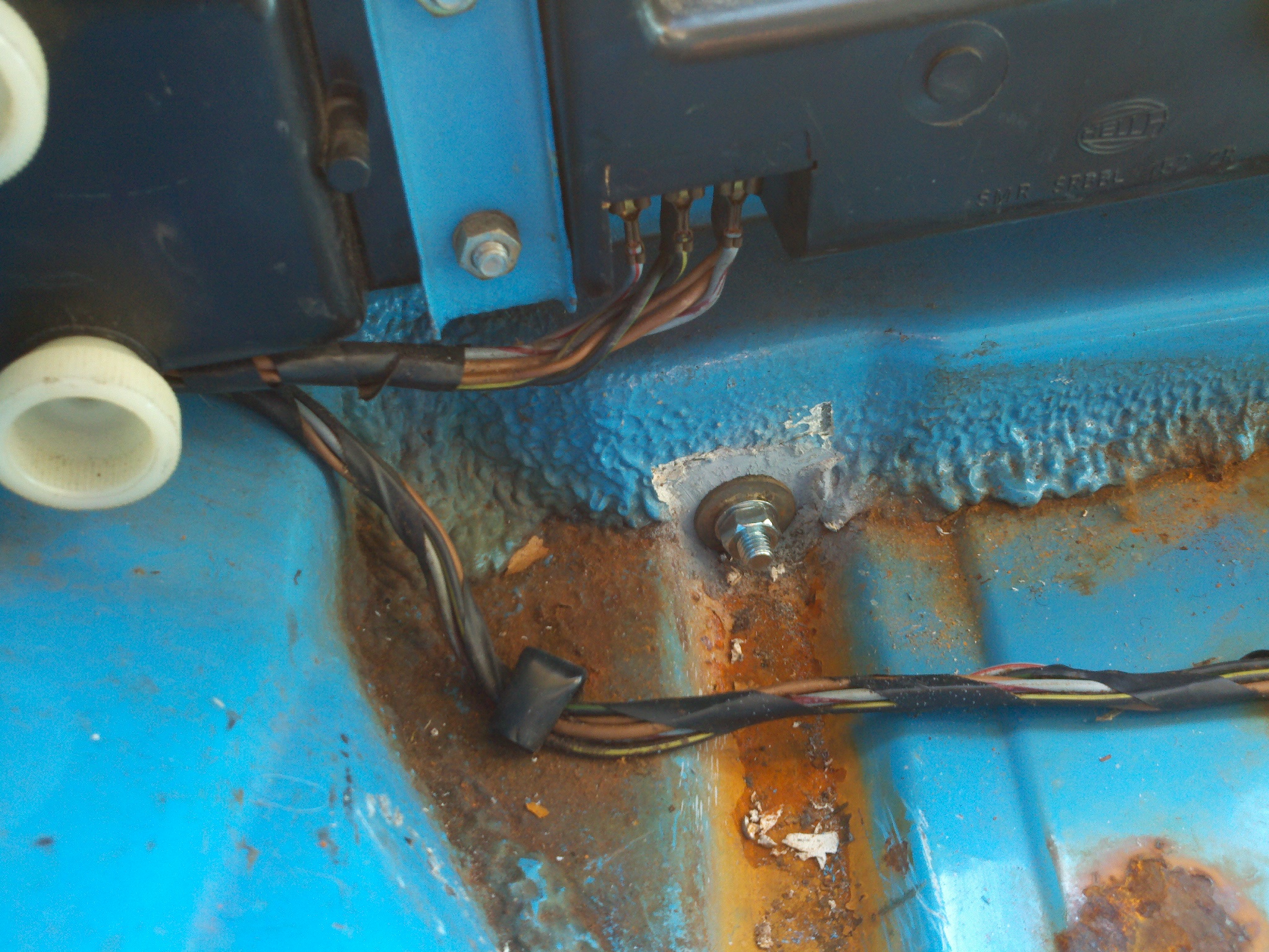

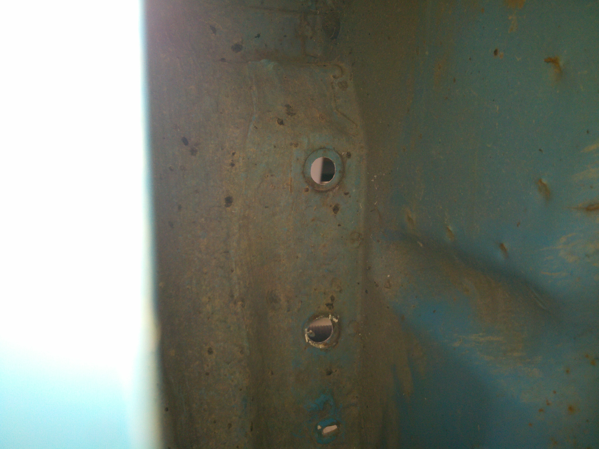

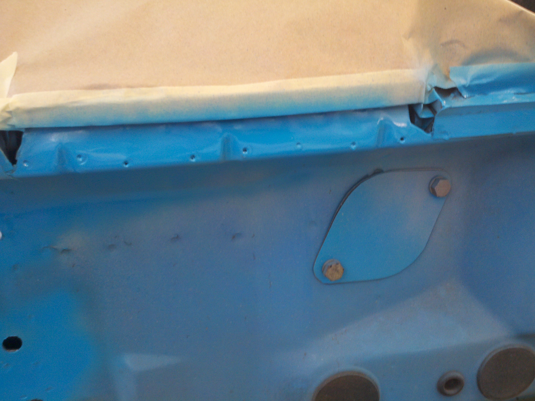

This is where your top hole should be looking inside the trunk.

You may need to dig out some seam sealer to get a flat spot for your washers and nuts. Yes, I said nuts, not bolts, because I am about to impart more wisdom upon you (Craig at Camp914, not mine). It is much, much easier to hang the bumpers (especially if you are working alone) if you use studs and nuts, rather than bolts like the factory. I made my own by buying 8 M8 x 1.25 x 50 bolts and cutting the heads off. Screw those into the bumper, and it makes it a one person job!
I chose to prime the holes before installing the bumper.

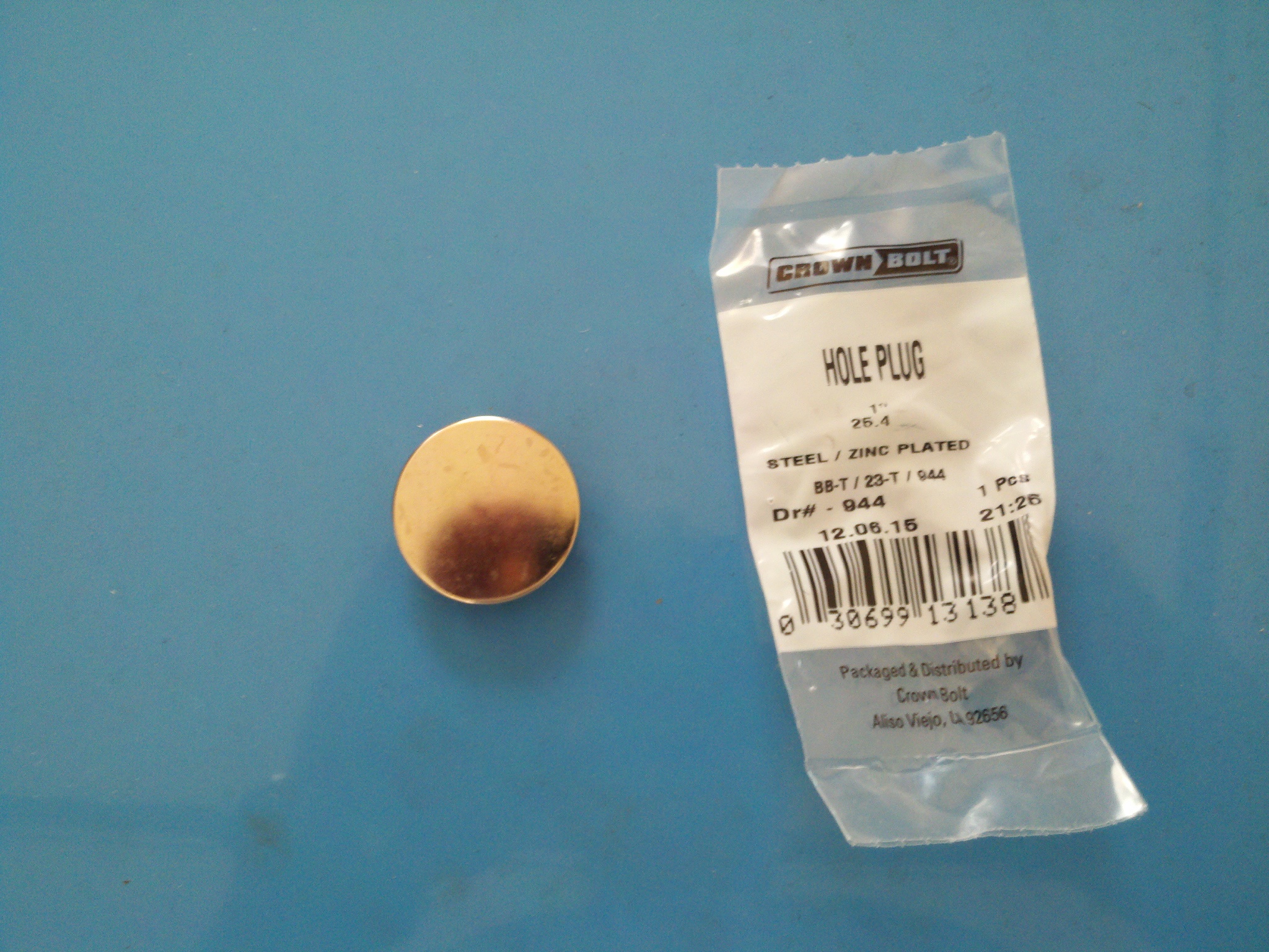

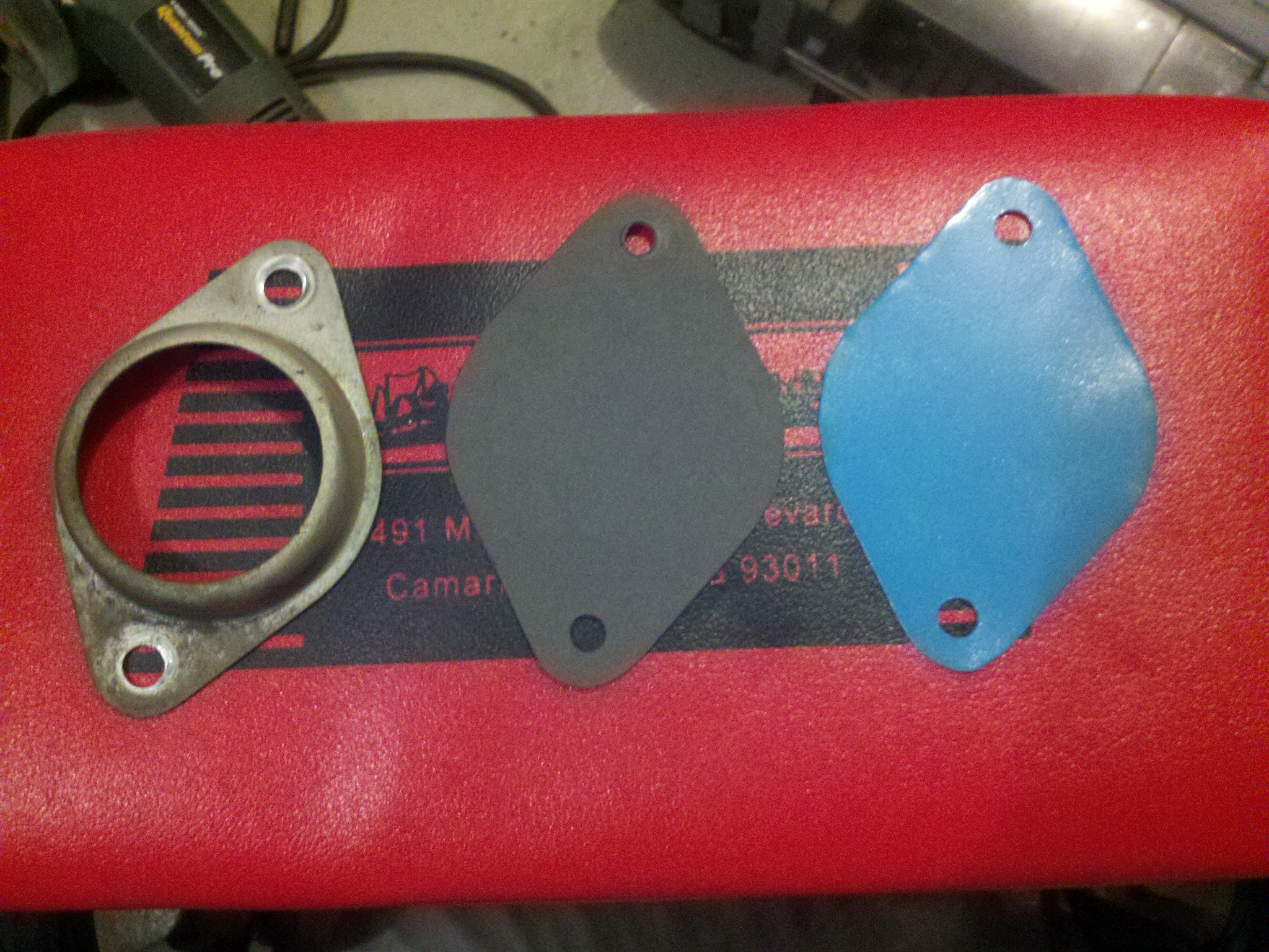

My bumper didn’t have the plug when I got it, so another trip to Lowes, and I found this 1 inch plug that fits perfectly. Zinc rather than chrome or stainless, but it looks fine.
Remember those license plate lights? On my car the wiring was way long, and I had two too many wires (don’t recall why). So I pushed the two extra wires and all the excess back through the grommet into the trunk. Just to be safe, I put some heat shrink around the exposed spades on the extra wires. Hook up the wires, and done.

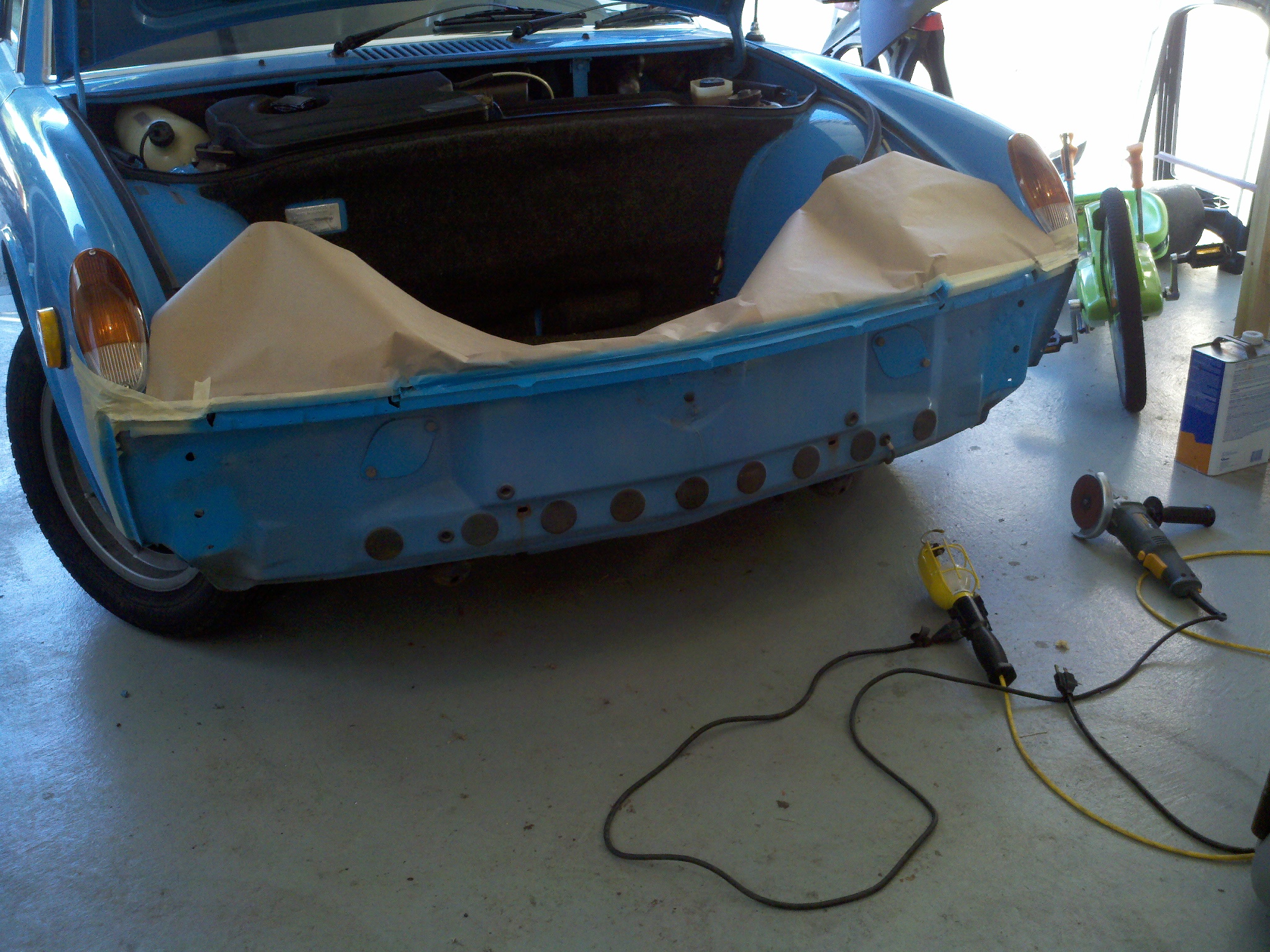

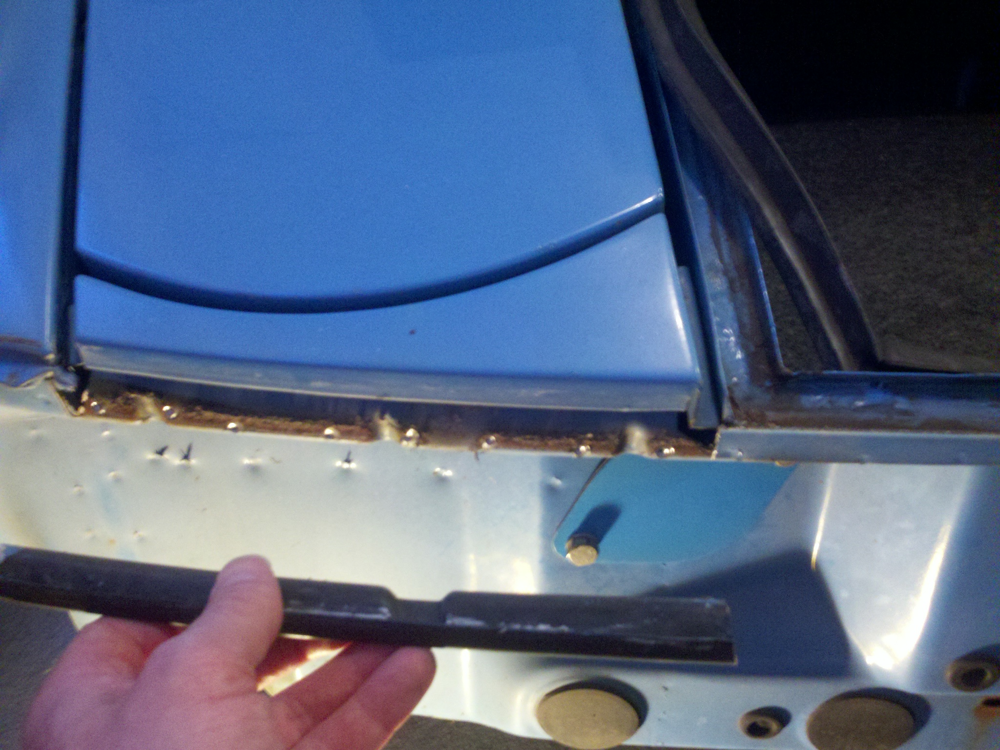

Hope you have bought that spot weld cutter by now. It is time for surgery.
Let’s start with the side rails, tabs, whatever you want to call them. Remove these in the same way you did them on the rear. I won’t go over all that again. Here is one in process.
Now for the part that has never been covered all that clearly in earlier threads. You will find that there is an S shaped strip that runs all the way across from the outside edge of each headlight eyebrow. This strip is there to support the top of the late bumper rubber and is not present on early cars. Unfortunately, this strip completely interferes with the early bumper top, so it must be partially removed and the part that remains must be trimmed. This really isn’t as bad as it sounds, so lets get started.
The sections underneath each headlight must be removed altogether. The section in front of the trunk must be retained so that the trunk seal will still have a channel to live in, but trimmed back so it won’t interfere with the early bumper pad. The first step is to use a hacksaw or cutting disk to cut the strip just on the outside of each corner of the trunk seal channel. Do not cut through the metal underneath. You are effectively cutting the strip that runs all the way across into three sections. The two outer sections under each eyebrow will be removed by cutting out the spot welds.

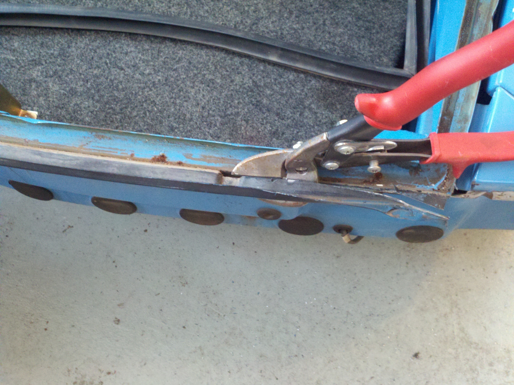

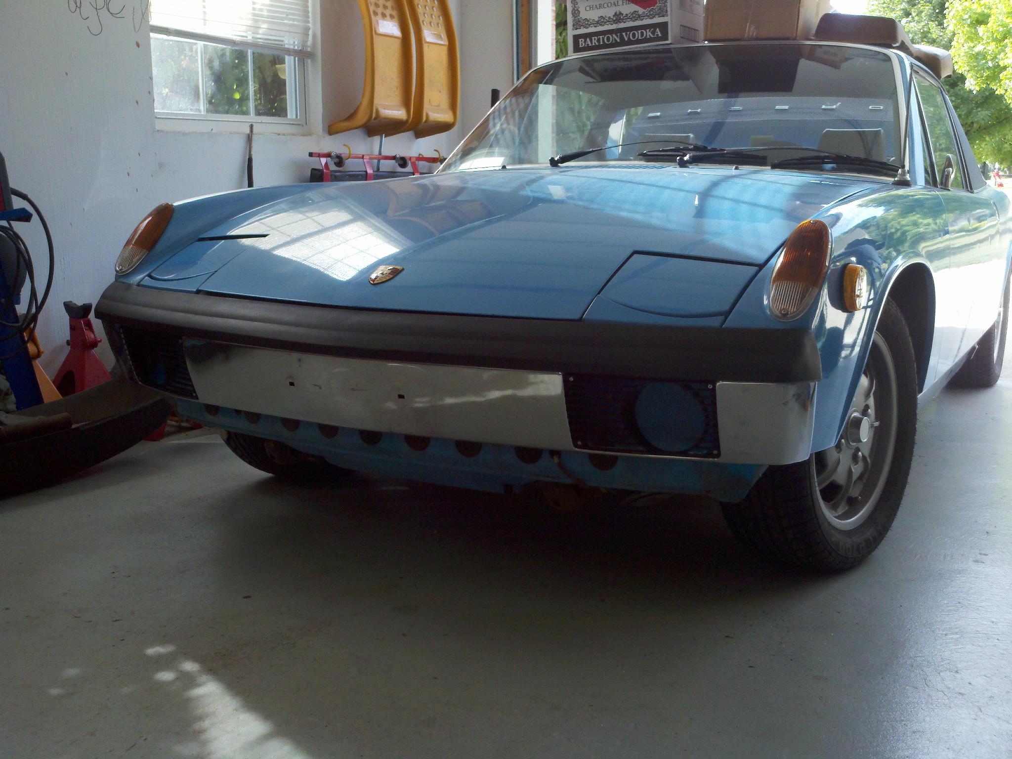

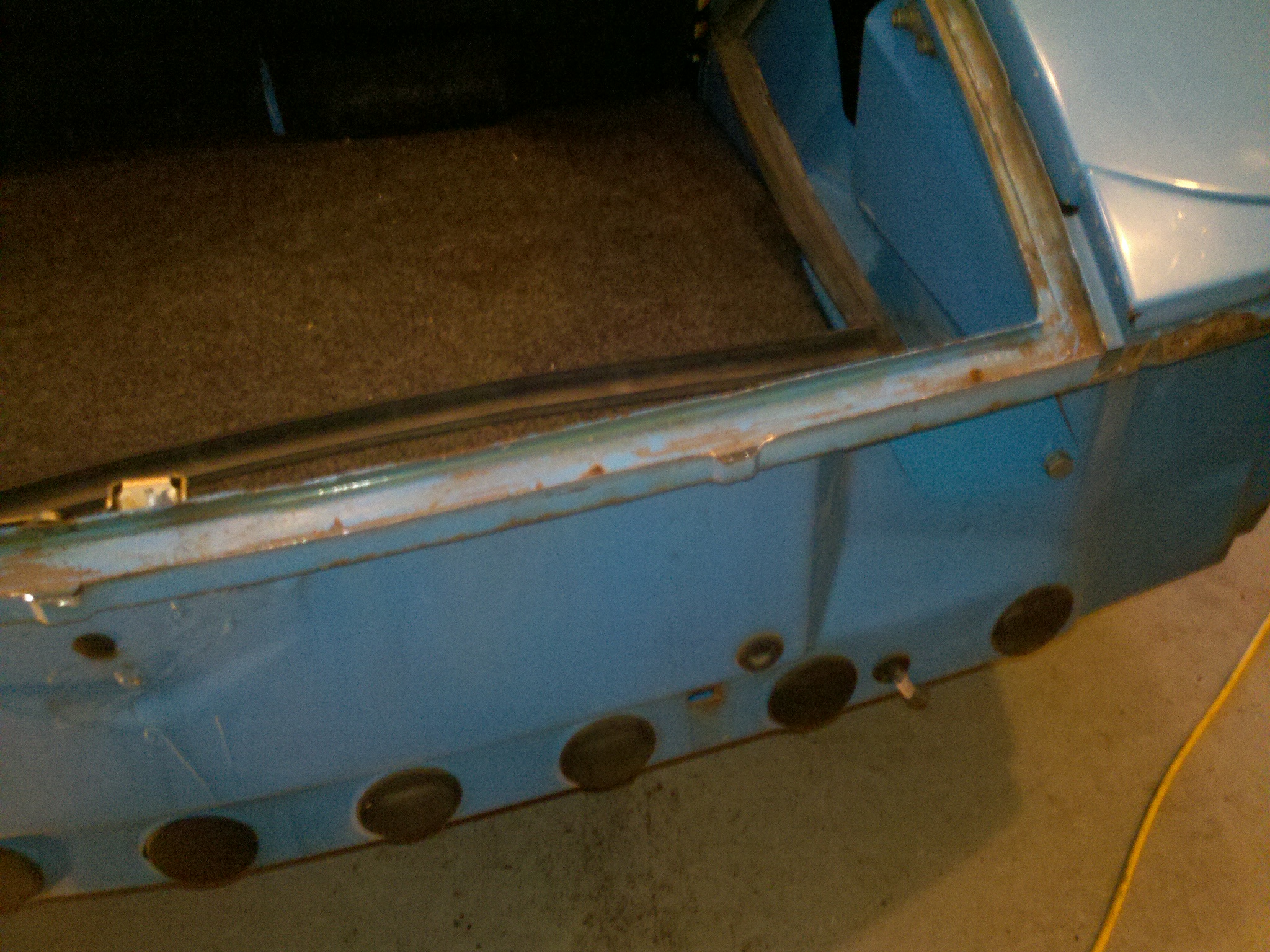

For the center section, I used tin snips to cut off the outer lip, leaving just the vertical part that will hold the trunk seal in place.
When you are done, this is what you get. There are three drain “tubes” that I left in place. I will probably go back and cut them off because they hit the bumper top.

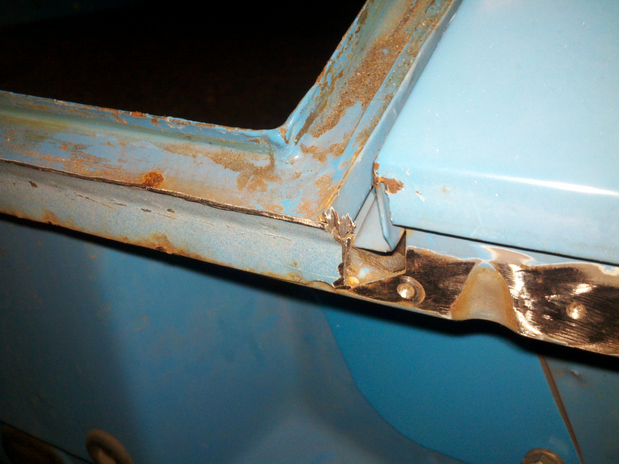

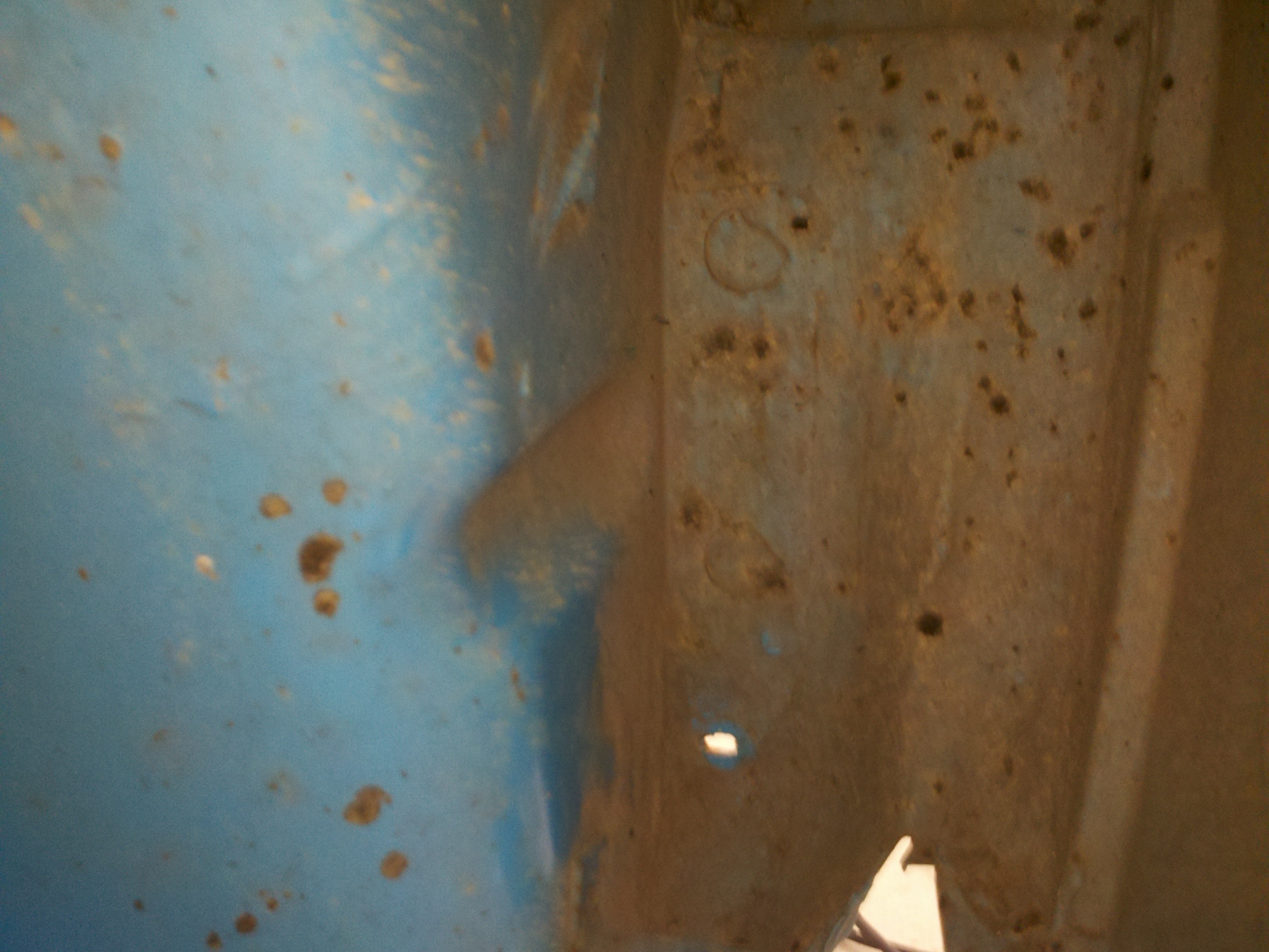

Remember how I said the holes were already there, sort of? Well they are, but you need to make them go all the way through. If you look inside the wheel well, you will see that there is a reinforcement plate with two holes that was welded in at the factory to support the early bumpers. Why they continued to put them in on late cars, I don’t know, but it works out in our favor. All we need to do is punch or drill the center of these holes and drill them out to 5/8.
bigkensteele

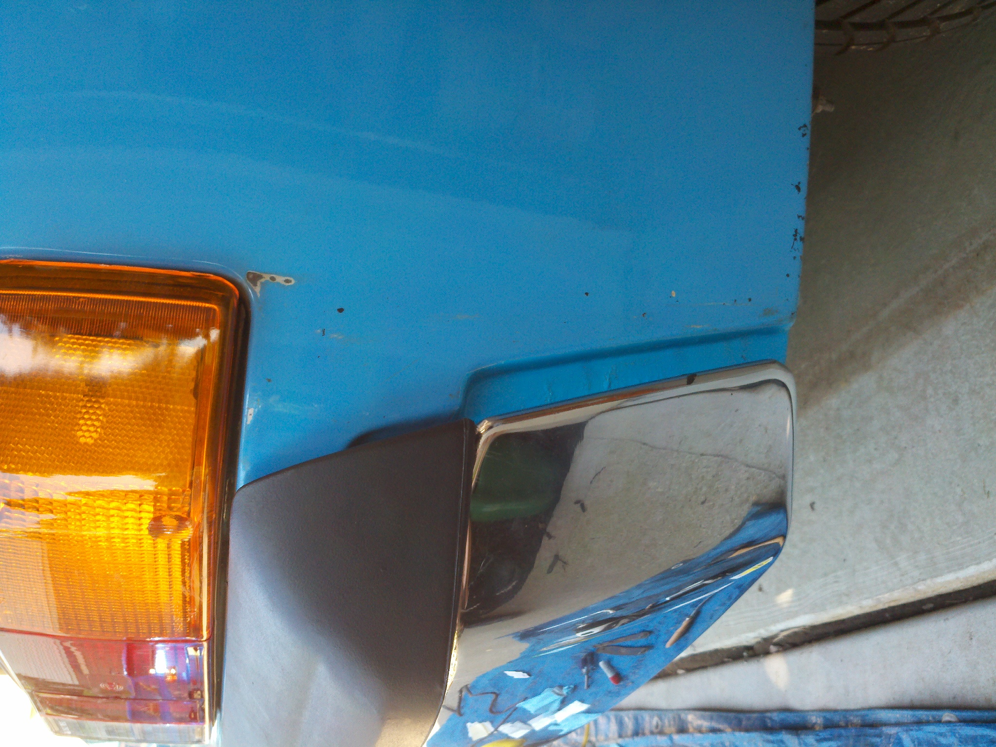

And from the outside...
