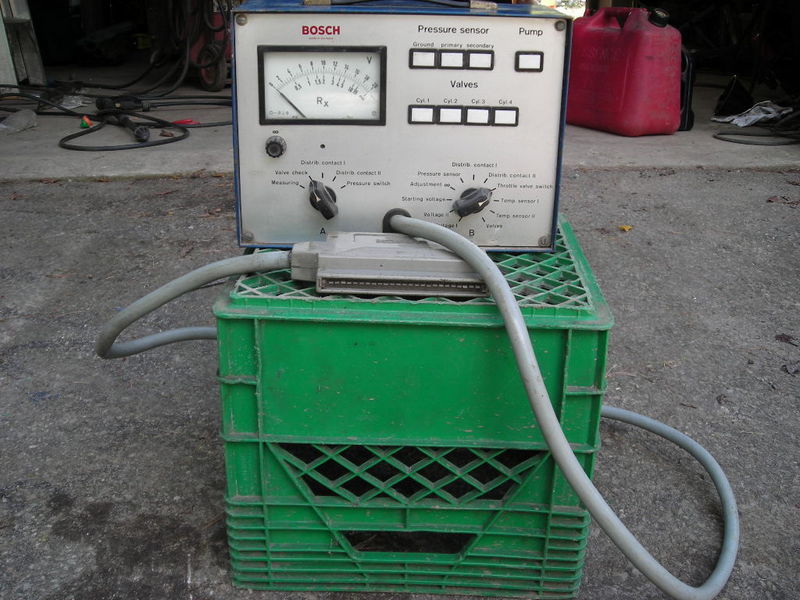

I have two bosch Djet test machines if you think that would work.
