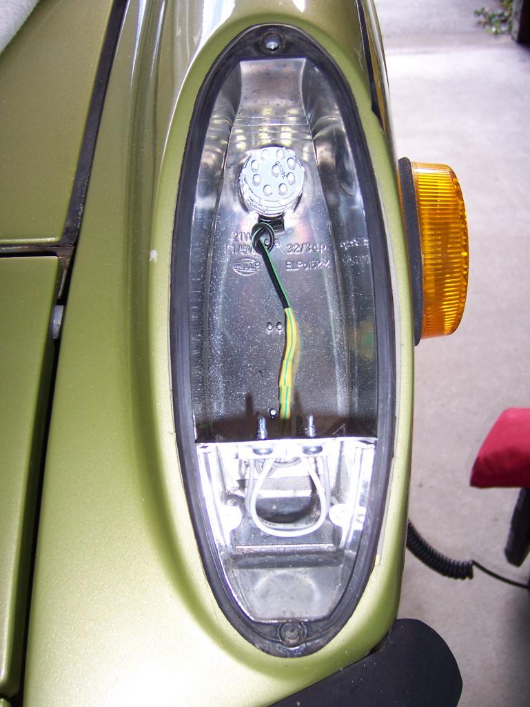

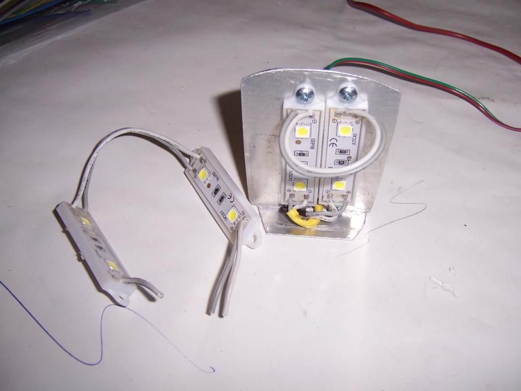

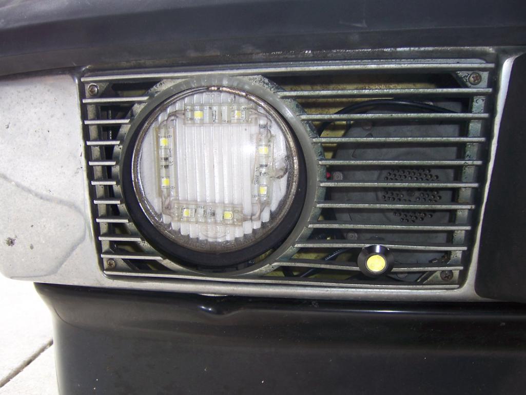

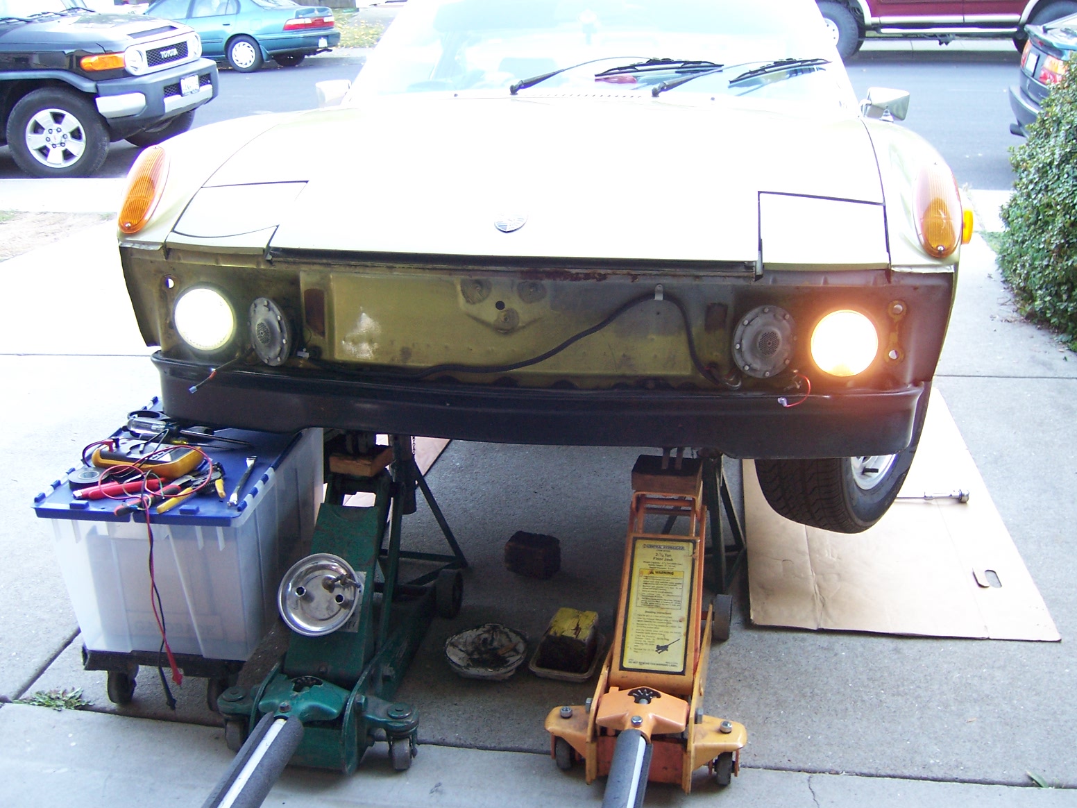

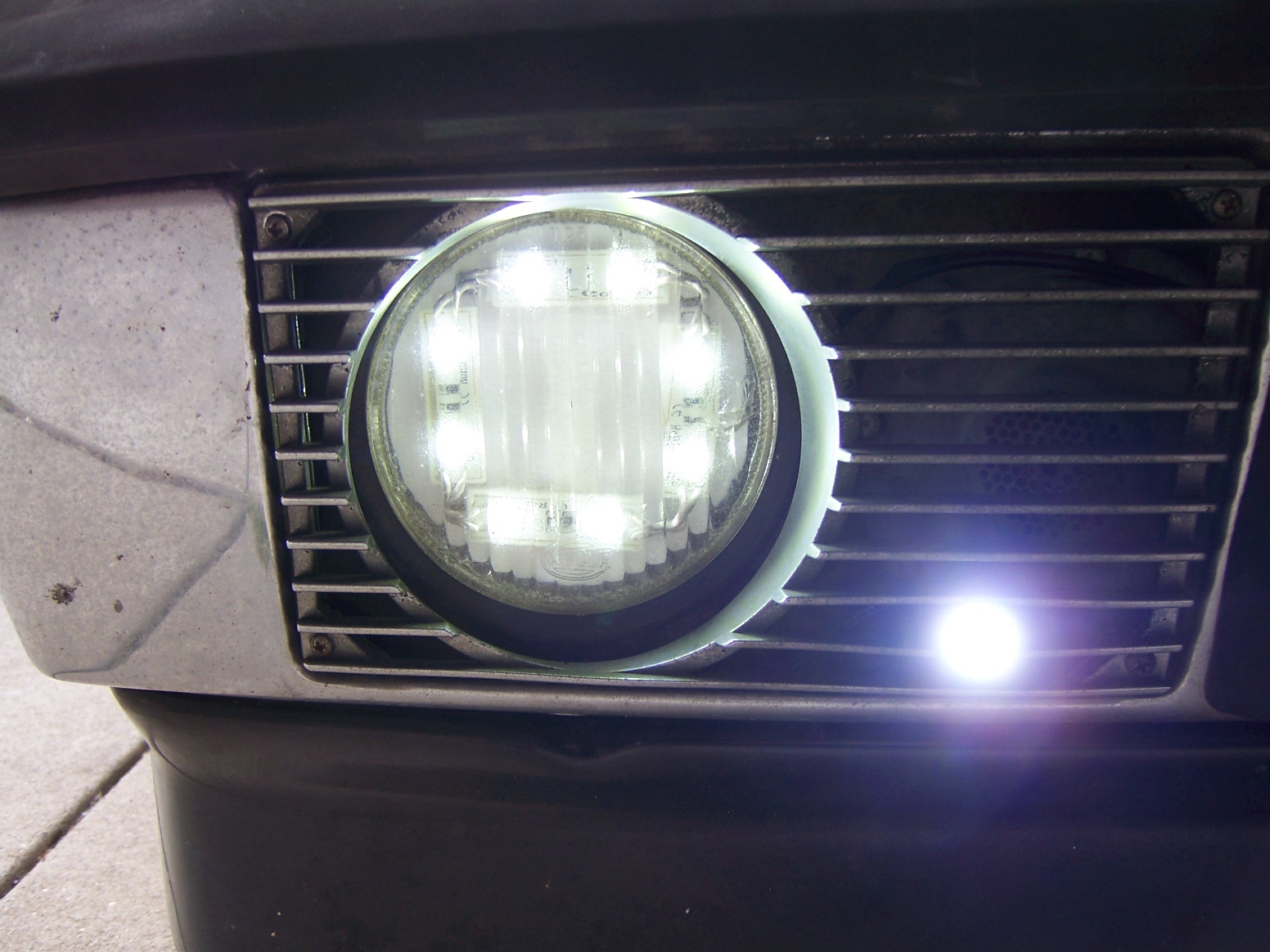

Okay, in my continuing quest to update the incandescent bulbs in our teeners, I changed out the 35 watt bulbs to SMDs in each housing. the cost was minimal of course. I also augmented the light fog grills with "3W White LED Eagle Eye Daytime Running DRL Light Tail Backup Lamp, Stock number# 2XSKU40521" from my my favorite China vendor, Bang good.com. Cost was $5.99 for four of these eagle eyes units; I installed the other pair as daytime running lights on my other car.

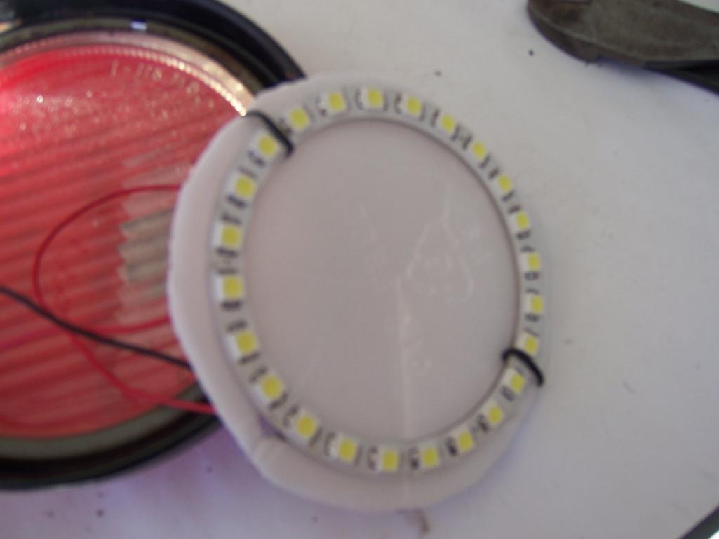

I cut out some styrofoam discs (from a take out container) and placed the assembly into the fog light lenses, added some wiring, all WITHOUT cutting any of the OEM wiring.
check it out, one of the pics shows the driver's side bulb with the 35 watt incandescent, compared to the passenger side with the four SMDs.
the pics are misleading. I had the camera flash off and it looks like a blaze, but in person, you see eight bright dots, of the same color as DRLs that you see on current Audis. I will try to add a better pic later.

Not sure how I feel about this. Hard to tell how bright it is, so it may just piss off oncoming traffic since there is no optics directing the light. (IMG:style_emoticons/default/idea.gif)

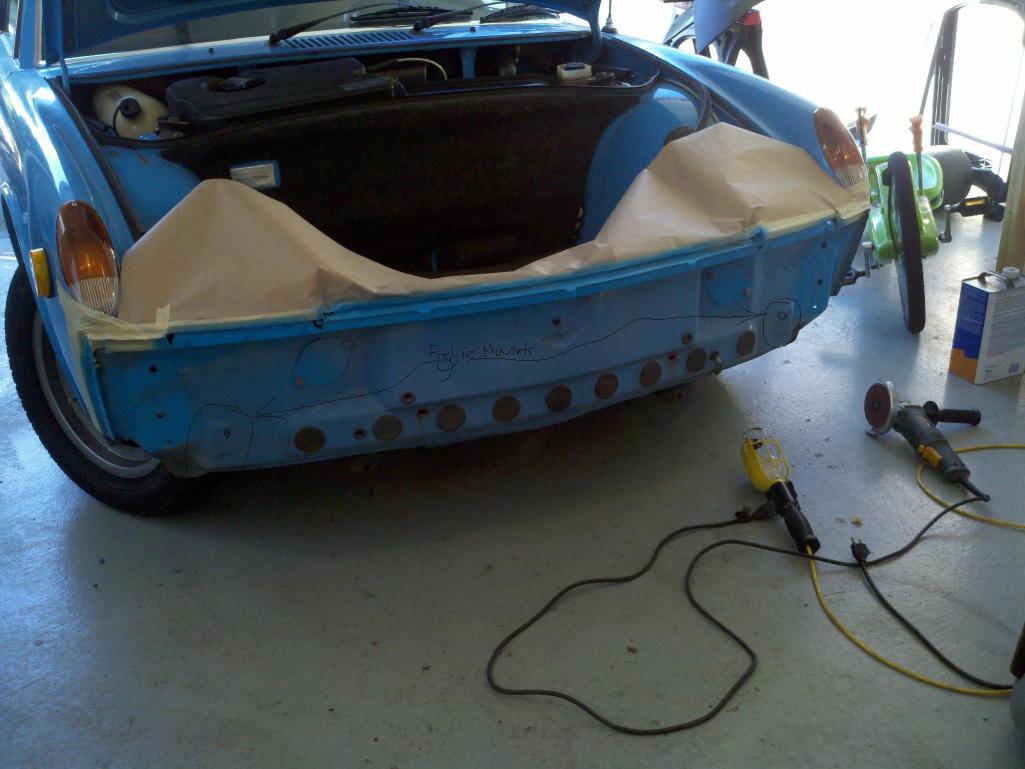

Interesting. While you're in there, would you mind measuring and posting the locations of the mounting holes for the fog brackets? I'm working on a backdate and that would be most helpful.
Thanks,
Joe

The only concern I have is the styrofoam that they are mounted to. After enough heat cycles you may run into a potential melting situation and the PCBs will then fall to the bottom of your fixture. You may want to purchase some thin Phenolic material for mounting.

QUOTE(Porschef @ Dec 29 2013, 07:01 AM) *
Thanks,
Joe
Sorry Joe, I buttoned up the bumper before I could take measurements. I will do so and report back if I have to do some mods. In the meantime have you checked out Lapwauli's thread on bumper backdating. THe foglites mount on the flat rectangle flats to the left and right of the that train of black plugs on the bottom lip, you see where I marked them in black lines and the holes for the mounts occupy the upper half of the flat stamping
http://www.914world.com/bbs2/index.php?sho...225743&st=0

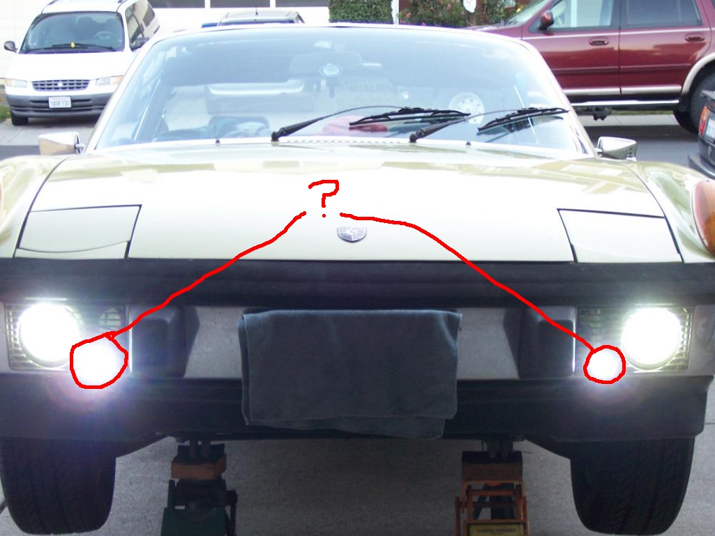

I agree, you may want to mount them to a sturdier surface ... and plug up the large hole to keep the elements at bay (IMG:style_emoticons/default/confused24.gif)
Are these artifacts, reflections, or separate lamps?

QUOTE(euro911 @ Dec 30 2013, 12:31 AM) *
Nice mod.
those are not artifacts, those are the "eagle eys" from mail order and here is the lighting as it appears as DRLs

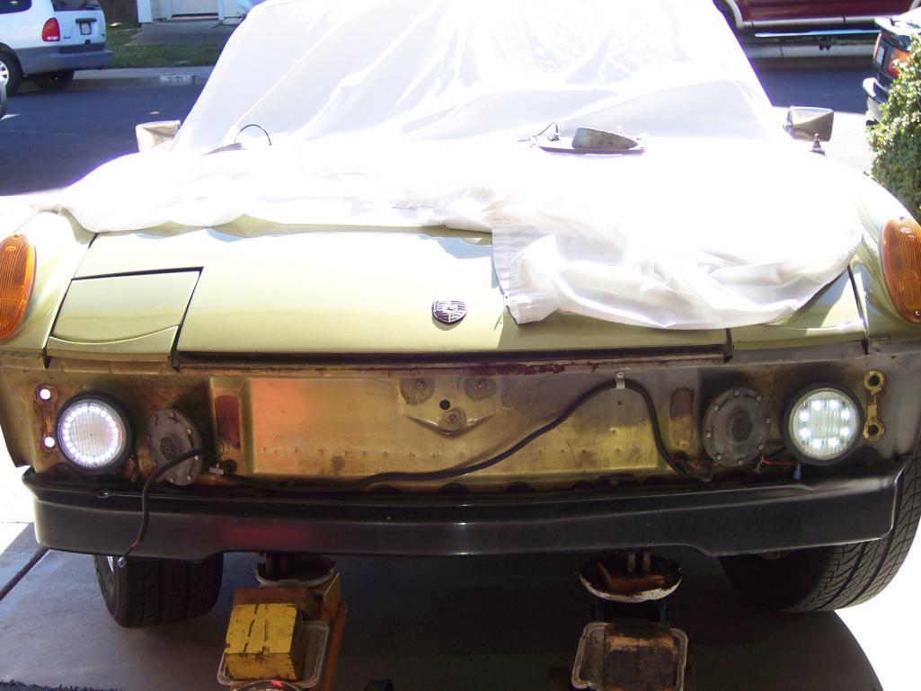

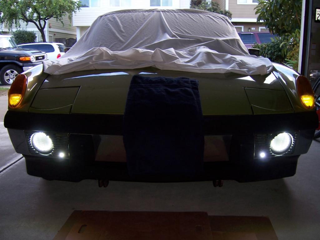

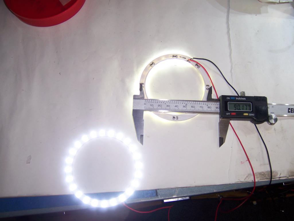

final iteration for DRLs, using the fog light housings.
so I got this 90mm set of SMD 5050, that has 24 lites for $14 for the pair from eBay
I installed them using that same piece of styrofoam that I used to mount eight of the SMD lites. I just did a swap out and now I really have a set of angel eyes. No I am not trying to be poser to look like a BMW. I just wanted to create a set of lites that will alert motorists of my presence when I come up behind them. I don't think they are annoying.

Hey, those look really cool. Who's the ebay seller?
