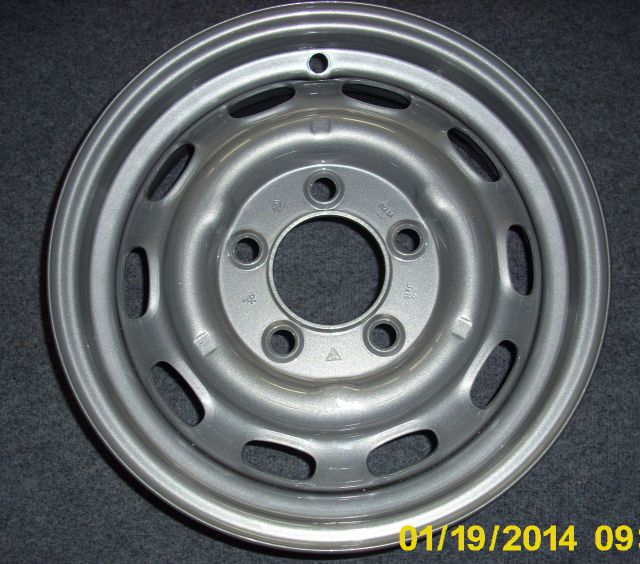

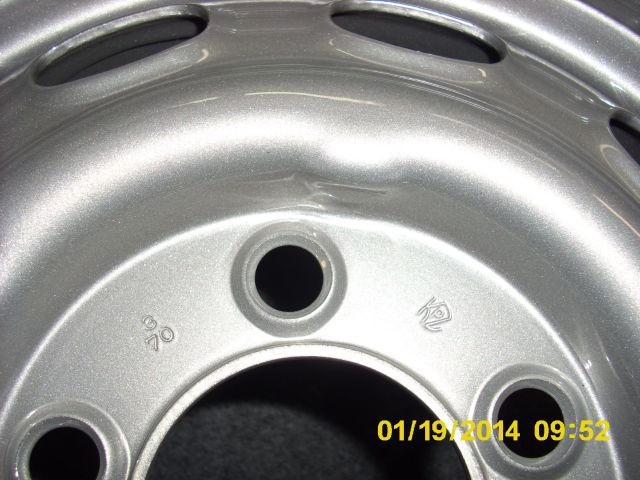

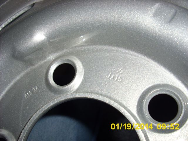

toolguy
post Jan 19 2014, 12:04 PM
Posts: 1,276
Joined: 2-April 11
From: San Diego / El Cajon
Member No.: 12,889
This is the correct rim from my April 1970 914-6. . 5 1/2 X J15 made by KPZ Production date 3/70 Stamped part number 613 3A in last picture
PM sent
