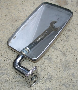

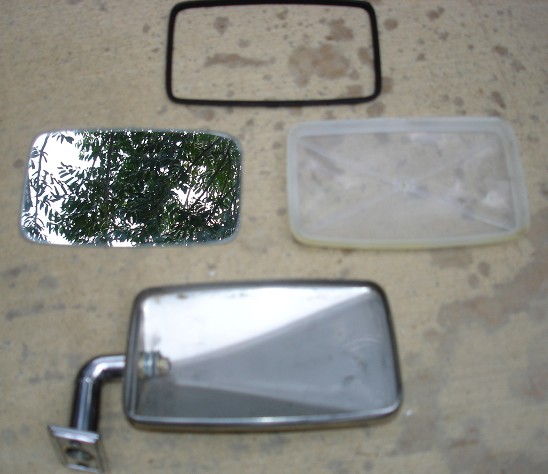

If you gently remove the seal around the outer edge of the mirror, you can remove the glass. Once it's removed, you will see a nut that controls the tension for the vertical movement. Do the same thing here you did with the base.
Remember, too little tension will cause the mirror to vibrate due to engine and road vibration. Too much and you can't move it up or down.

Like this:

Finally got the camera out to get some photos, as you can see it is six sided and only locks in on those positions. I thought the piece in the base might be separate but I have soaked it in PB blaster and tapped on it and it feels like it must all be on piece.
offwatch
post Feb 9 2014, 08:14 PM
Posts: 44
Joined: 4-December 13
From: Vancouver, WA
Member No.: 16,725
I take it back, just tried tapping it again and the center piece did come loose from the base. (IMG:style_emoticons/default/piratenanner.gif)
