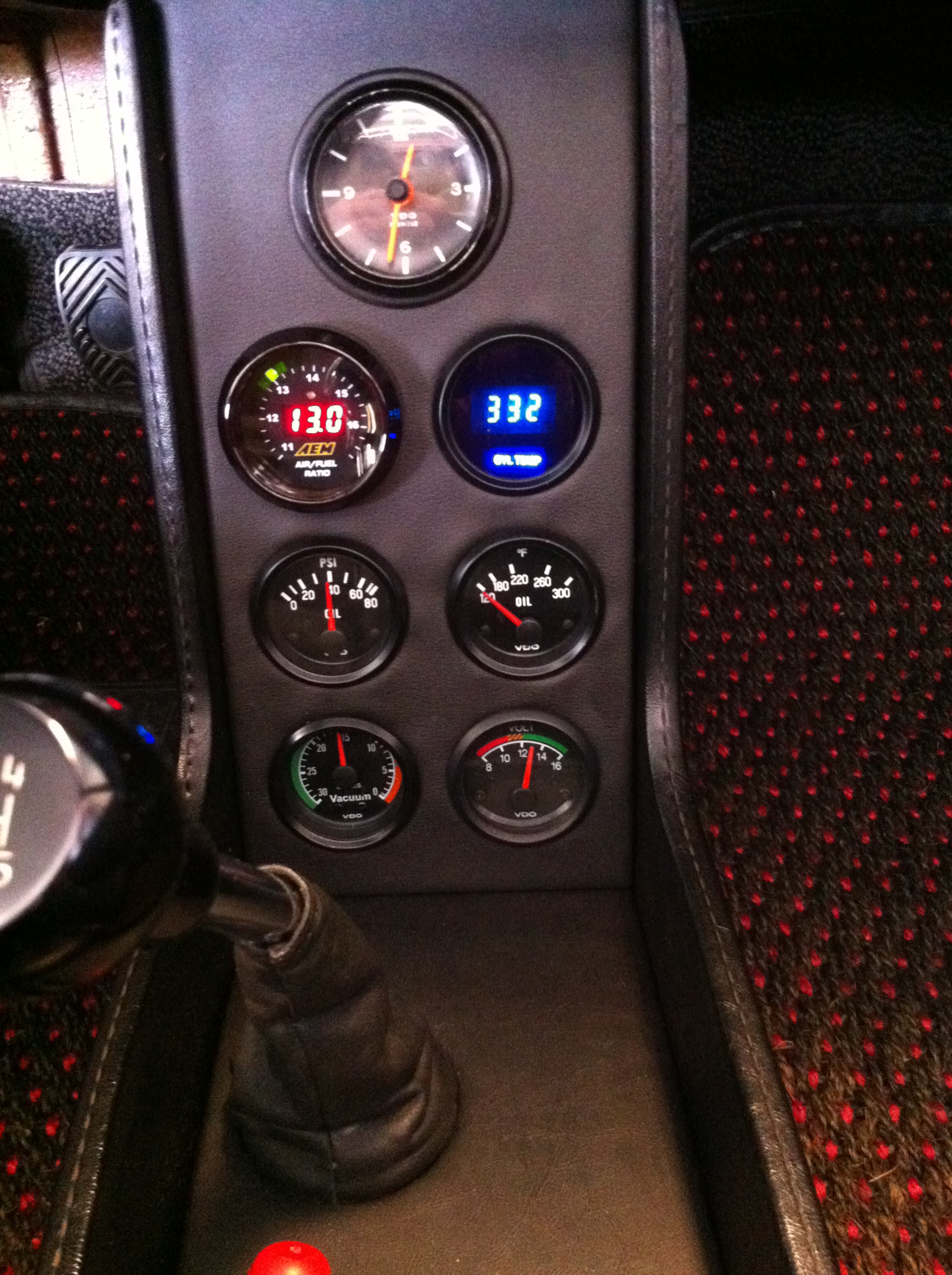

I sugggest getting a wideband air/fuel gage to monitor your ratio. You may be running very leaner as RPMs go up and just need to increase fuel from carbs at higher RPMs.

Just looked up the wideband gauges, what's involved in installation? Presumably it won't rectify the issue just confirm it? What would be next if what I suspect is true? I'm thinking perhaps just be kinder to the car and ease off when I get to 100mph!
gunny
post Feb 10 2014, 08:35 AM
Posts: 205
Joined: 17-October 12
From: Madison Al
Member No.: 15,051
The Wideband O2 sensor needs to be added to your exhaust at a point after all cylinders exhausts are combined. Mine is just before the muffler but after the resonator. You have to run the wire set to the gage in the console, I run mine thru the same hole as the speedometer cable to get it in the tunnel. I also added a Vacuum meter to monitor load, but your issue is at full throttle so load is high and vacuum is very low.
If you see that the mixture gets to lean at high RPMs then a carb adjustment would be required, maybe new Jets.

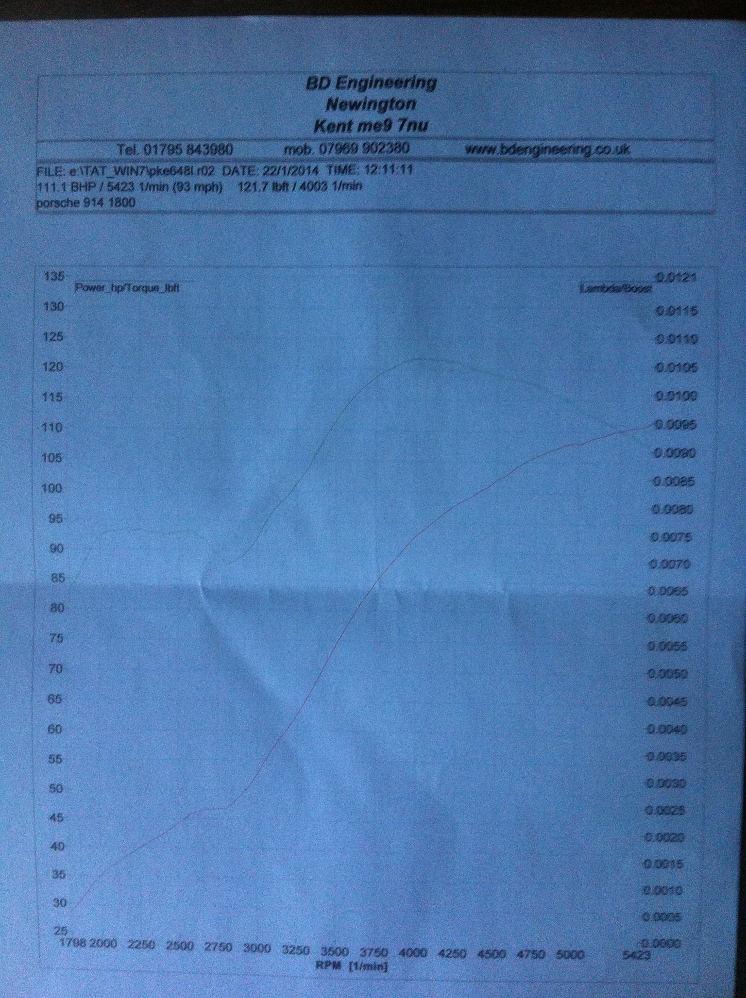

Thanks Jake, it was on a dyno a couple of weeks ago for a basic carb set up so I'll take it back with these ideas and see what they say.
Have any graphs? Were they plotting AFR?

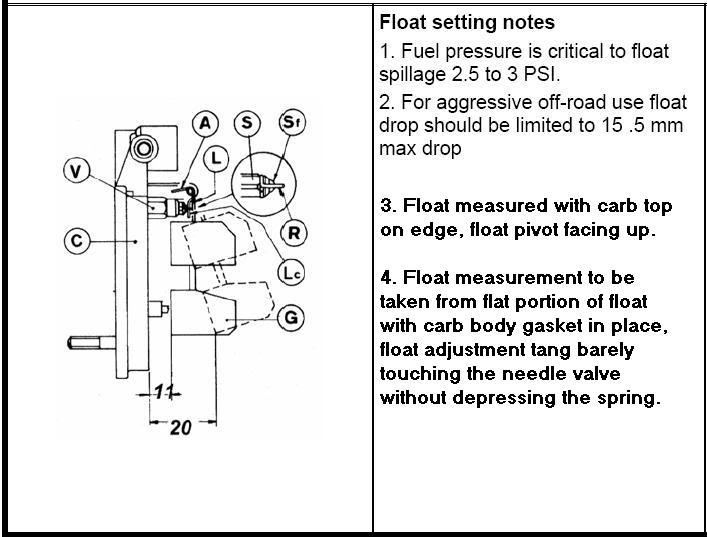

If you set float height, or if they do, make sure they/you don't compress the ball-spring in the needle valve. If they/you do then your float settings are too low. Set the upper/raised height without compressing the ball.
I'd trust Jake's numbers, but the ball is marked Sf in this pic.
(IMG:http://www.914world.com/bbs2/uploads_offsite/img.photobucket.com-419-1392137068.1.jpg)
Jake Raby
post Feb 11 2014, 10:59 AM
Engine Surgeon
Posts: 9,398
Joined: 31-August 03
From: Lost
Member No.: 1,095
Compressing the ball changes it all.. I blow on the fuel inlet to know if the ball is open, or not during this setting.

This was the only graph I got, torque and power. What's AFR?
Tom
post Feb 11 2014, 07:09 PM
Posts: 2,139
Joined: 21-August 05
From: Port Orchard, WA 98367
Member No.: 4,626
Air to Fuel ratio.
