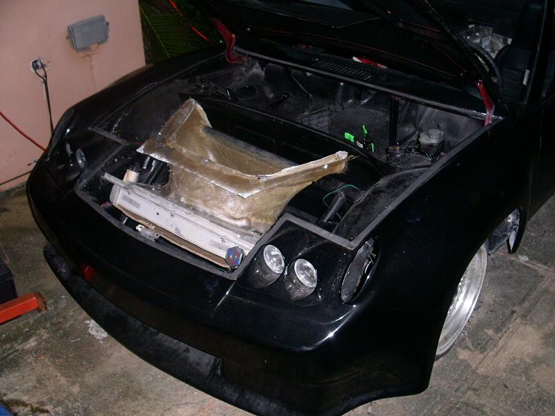

Do you want to vent trough your wheel-wells or trough the hood? I seen venting trough the wheel-wells routing the air with a shroud. This will eliminate air re-circulation in the trunk. I will vent trough the hood with a shroud.
Also check Wigberto's thread....
