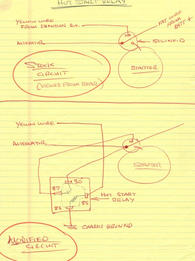

Here's a quick wiring guide.
You should be able to pick up all the parts needed at your local auto parts store.

In the drawing above....The big fat wire from the battery...you show it going to the plug in with alternator and then down to the relay, or bypass the alternator wire plug and go straight to the relay? Thanks for the I want to be sure clarification.

QUOTE(bandjoey @ Feb 22 2014, 12:07 PM) *
You leave those wires alone. You will be adding a new red ( + ) wire to the terminal to power the relay at # 30.

QUOTE(Luke M @ Feb 22 2014, 11:49 AM) *
Relay it is then.
