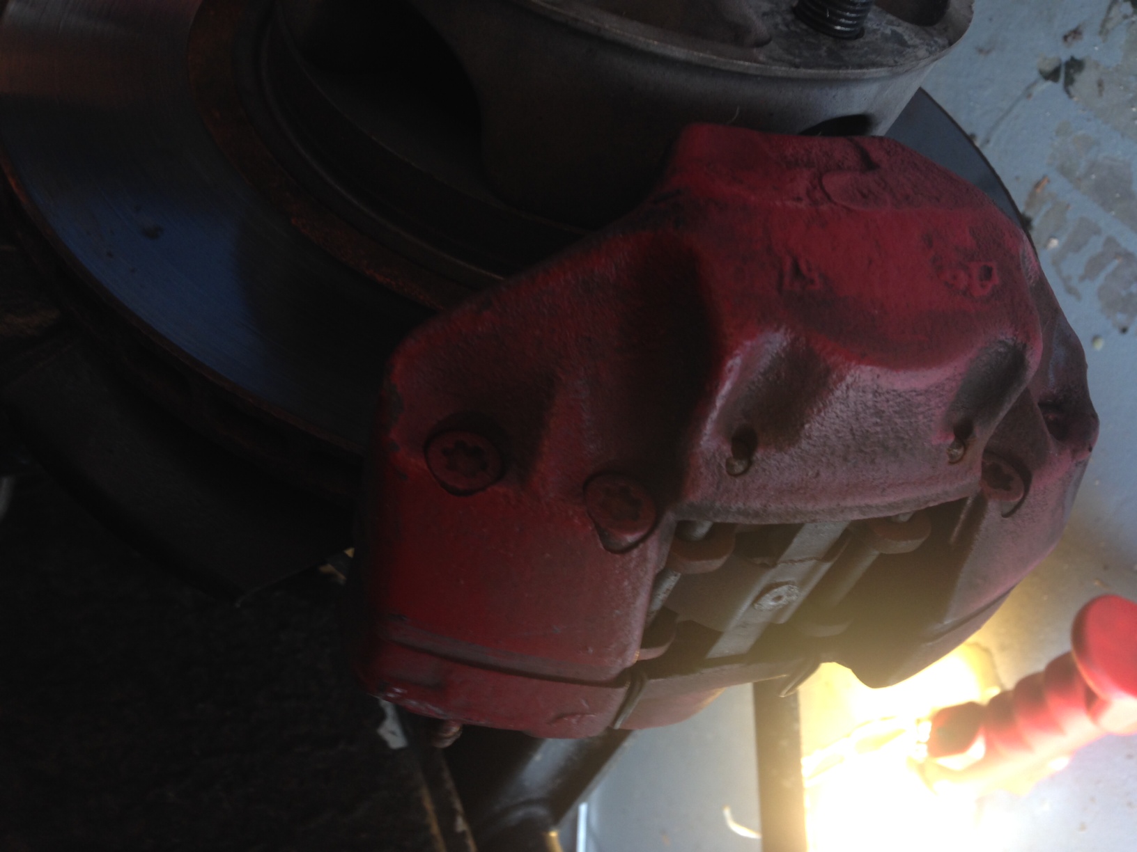

Also, does anyone know what these front calipers I have are? Dumb Ass PO (scotty boy) said they were '73 911 A calipers. According to the PMB website A calipers weren't around until the late 70's. Either he got the date wrong or the model of caliper wrong.
Either way it'd be cool to know so I can order pads for them.

Those look like "M' calipers.

QUOTE(bulitt @ Apr 4 2014, 07:04 PM) *
Awesome, thanks for the info!

" M " calipers have about a 3 inch center to center bolt mount pattern , " A s" have about a 3 1/2 inch bolt pattern. Ms will work fine for a -4 , heck I believe that - 6s originally came with "Ms" up front .Get er goin !!!! (IMG:style_emoticons/default/piratenanner.gif)
