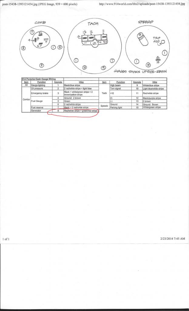

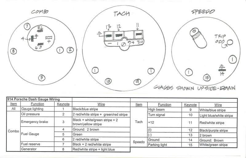

#4- I need to tie in my alt light with the suby engine. I have a single wire from the Suby to connect to the GEN light but don't know where to tie it in. I looked at Jeff B's info (thx Jeff) and found which bulb it is and there are 2 wires. A R/W and a G/R wire. The R/W goes to fuse 9 and to other gage bulbs so I can rule that one out. Maybe a switched + for bulb power? That leaves me with the G/R which goes to the relay board #5 on the 14 pin plug then out the 12 pin #1 to the OIL pressure switch. I don't understand this.

JeffBowlsby
post May 3 2014, 11:05 AM
Posts: 9,390
Joined: 7-January 03
From: San Ramon CA
Member No.: 104
QUOTE(76-914 @ May 3 2014, 09:10 AM) *
Odd. I have one sch showing GR yet today I find the one you mention w/ Blue on another print out in Jeff material. Are there two and I have the wrong one?? Many TY's for the assistance, guy's. (IMG:style_emoticons/default/WTF.gif)
That diagram was superseded., it was not correct. I try to keep the website materials correct, and I replaced that former diagram on the website in May 2013 with this corrected one. Keep in mind that this diagram is only for the 1974 model years, other years are different:
