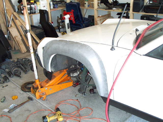

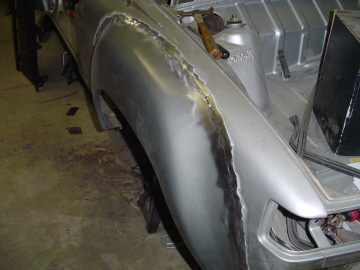

By request, I'm posting the few pictures I have of the installation of my steel flares.
I started by taping them to the car to find the correct position. It's a subjective placement and I recommend NOT using FG GT rockers as a guide. Mine would have been wrong if I had. Instead, I found that the arch of the flares was slightly larger than the arch of the factory fender. I taped them on in a position that split the difference when you looked at the car from the side.

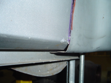

You can see the what I'm talking about in this picture. See the small amount of original fender visible at the bottom corners of the arch. Center the flare on the old fender arch.

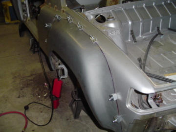

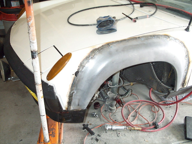

With self-tapping sheet metal screws, I then attached the fenders tightly down to the old metal so I could scribe a very accurate cut line:

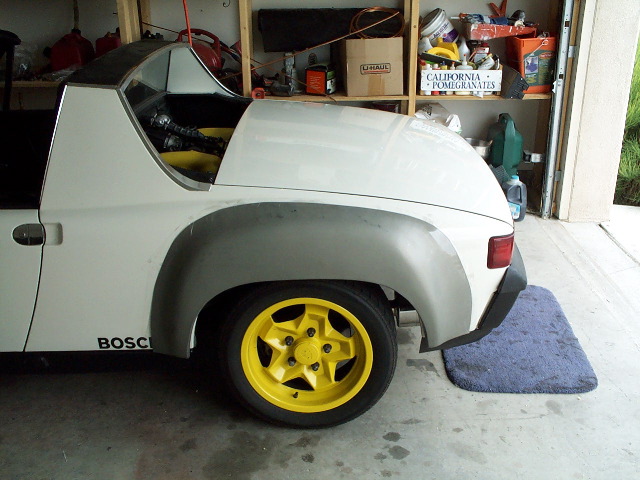

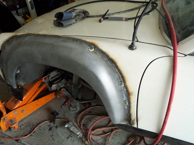

I then carefully cut along the scribe line, fit up the flares and started welding. It's a slow process, if you want it right. I did one flare per day. That's enough sheet metal welding for just about anyone. I used a TIG.

After you've cut the old fender at your scribe mark, I assume you're butting the new fender to the scribe cut, how do you hold the fender in place for the first tack welds? A helper?

I left some small tabs on the old fender that I could leave screws in to get started. I later ground the tabs off. They are butt welded.
Next time I'll use a tool that I later found that's made for holding joints like this. They are like little clamps that actually reach through the crack of the seam.

I found that you can get a accurate cut line if you cut and weld as you go around the flare (just another method) I agree with 914RS on the FG rockers, I had several different one and no two were alike. I ended up using measurements that were from a true 916 to locate the flares and then used the rockers that best match the positions.
My method
http://www.phoenixhobbies.com/html/flares.html

QUOTE (Root_Werks @ Jan 12 2005, 09:27 AM)
I thought TIG was only for aluminum? (IMG:http://www.914world.com/bbs2/html/emoticons/huh.gif)
No, TIG is for everything! If you want a clean, strong weld, use a TIG.

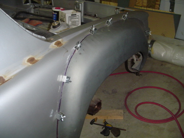

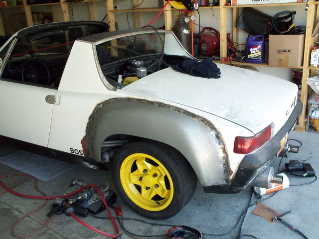

I clamped my flares on using C-clamps at the bottom edges and a Stanley slide bar clamp at the top. I then trimmed any high spots on the flare that kept it from fitting to the stock sheet metal neatly (mine were very roughly trimmed by AA for shipment).
I then used a felt tip "sharpie" to trace the outline of the flare onto the stock fender and removed the flare. Then came the (IMG:http://www.914world.com/bbs2/html/emoticons/sawzall-smiley.gif)
Once the stock fenders were cut I fit the flare in place utilizing butt welding clamps. I got 3 bags of them from Harbor Freight for about 25 bucks. They do a nice job of lining up the metal for welding. I then tacked the areas between the clamps working around from end to end to keep the panel from heating up too much and warping. I have MIG and TIG, but I think the MIG imparts less heat/warping.

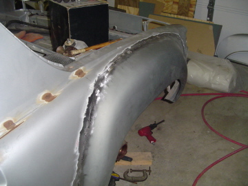

Once it's tacked between all the clamps, I removed the clamps and kept playing connect the dots until it was welded all the way around. Also, I agree with 914RS, one fender per day is probably enough for one day!

nuther...

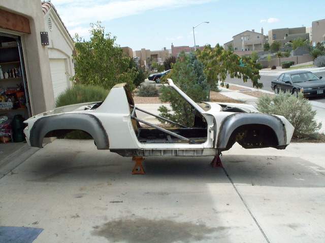

Now for a little.... (IMG:http://www.914world.com/bbs2/html/emoticons/welder.gif)

from the flip side

Haven't really figured out how I'm going to deal with the fitting of the bottom of the flares to the stock metal. It really fits like crap the way they make them. The stock piece has a double bend to it and the GT flares do not. It's not a biggie, but I'm saving it for last. I'll probably just do some sort of blend with a hammer and dolly. (IMG:http://www.914world.com/bbs2/html/emoticons/smash.gif)
