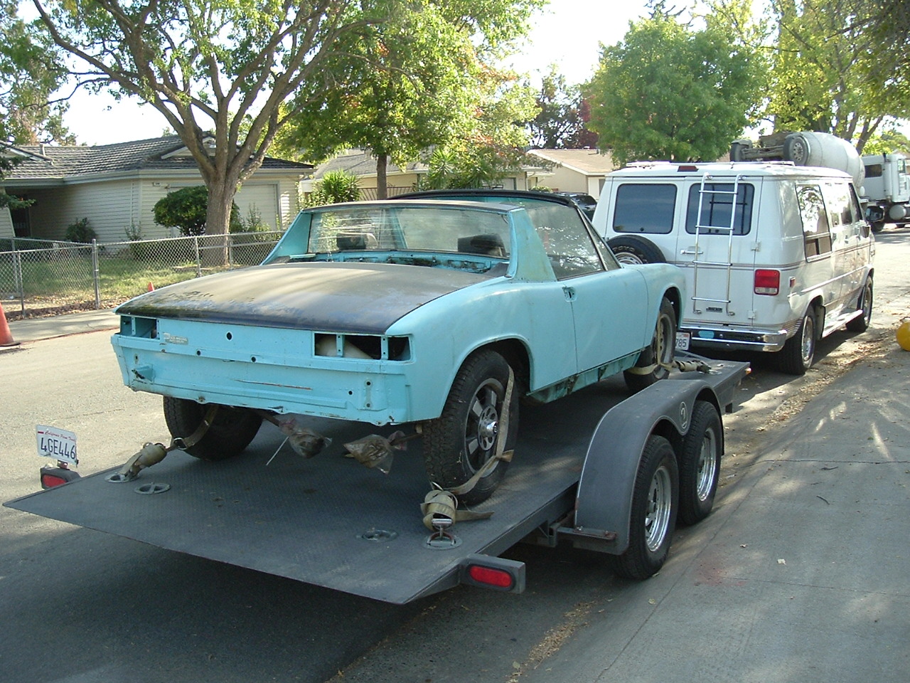

You can always tear it down, and have the old paint removed by media blasting. (IMG:style_emoticons/default/popcorn[1].gif) (IMG:style_emoticons/default/wacko.gif)

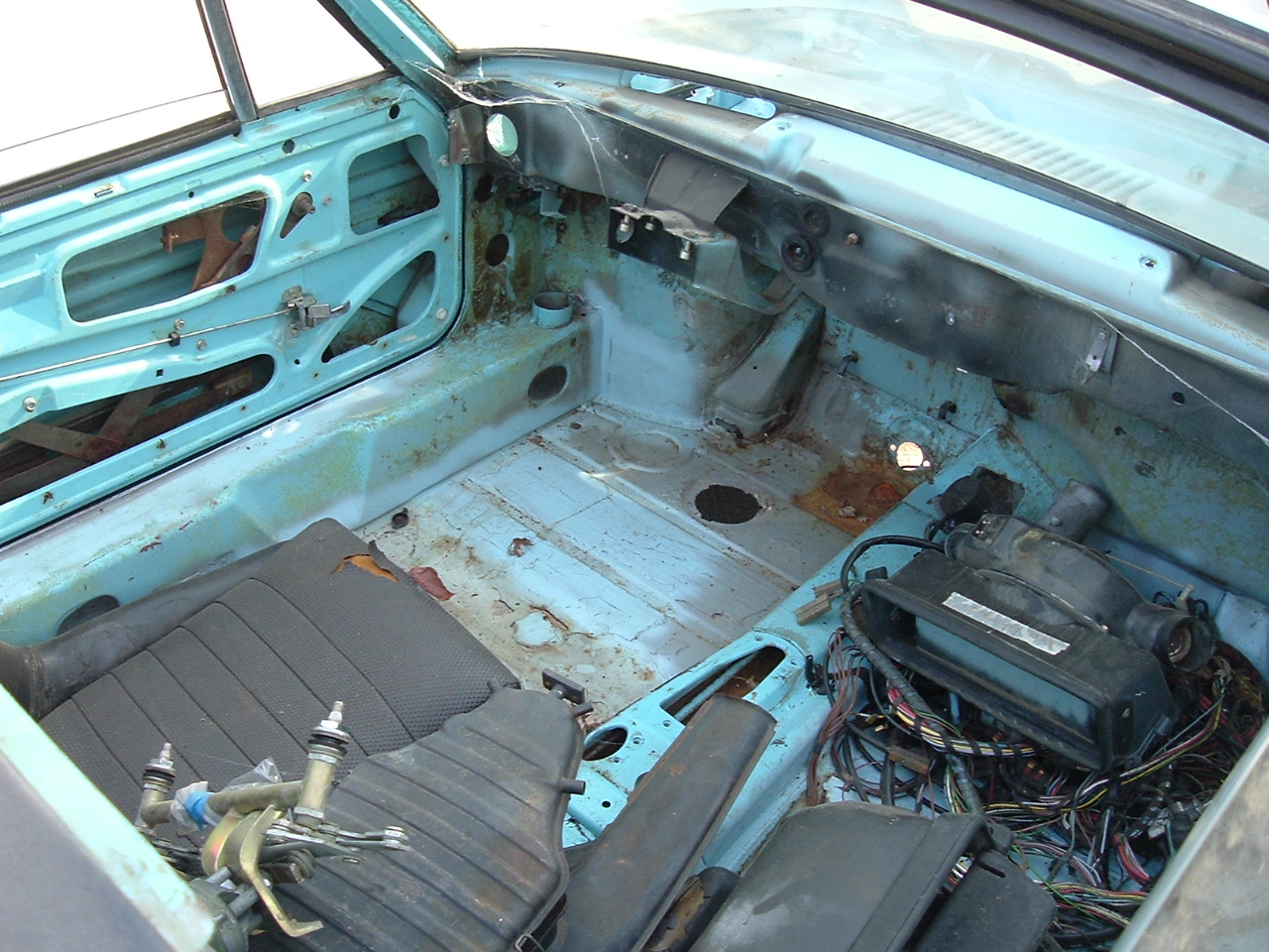

(IMG:style_emoticons/default/smile.gif) this one needs the glass removed, and it will be ready to blast.

Is everything in the interior all removed as well?
green914
post May 11 2014, 07:09 PM
Posts: 1,467
Joined: 29-March 11
From: Sacramento, California
Member No.: 12,874
QUOTE(partwerks @ May 11 2014, 05:35 PM) *
The seats are just sitting in the car, everything down to the wiring harness has been removed. (IMG:style_emoticons/default/w00t.gif)

QUOTE(green914 @ May 11 2014, 04:35 PM) *
You're blasting that one? It looks pretty clean, and besides--it's the best 914 color out there already.

QUOTE(bembry @ May 12 2014, 06:21 AM) *
Going to keep it the same color. The blasting is more for searching out rust, so it can be removed. (IMG:style_emoticons/default/sawzall-smiley.gif)
