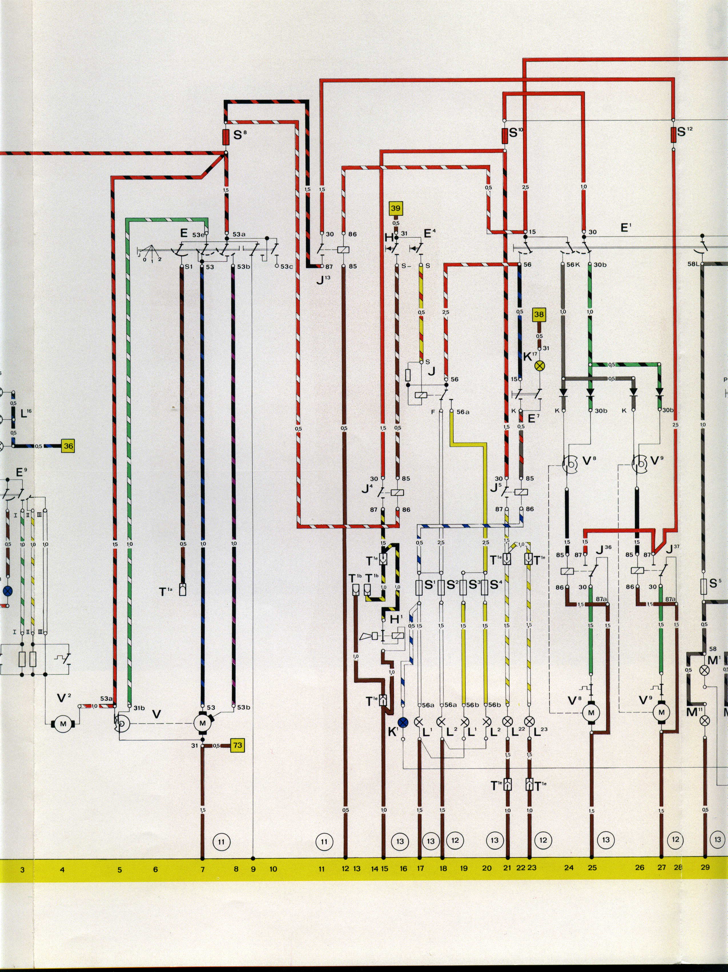

I hope you have a good print to follow. I will post a pic of what I have.
You have a short after the headlight switch. The power comes thru the key switch to terminal 15 of the headlight switch (E1). First notch of the headlight switch does not energize the headlights, second notch does. Second notch feeds power to the headlight relay (J) and the fog light relay (J7). It sounds like your issue it is before the fuses on the cabin fuse panel.
Your fuse at the battery is popping because that part of the electrical circuit was previously unfused. If this condition had happened prior to your fuse installation at the battery, you would have let out the magic smoke.
