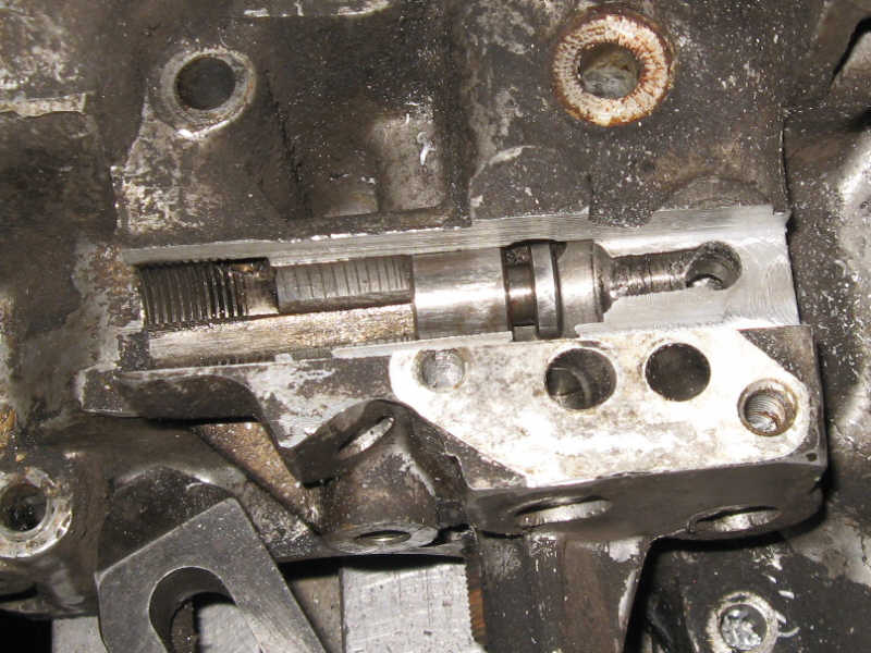

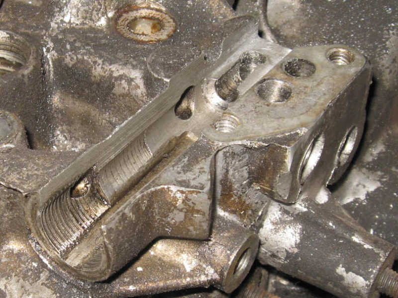

I've been doing a little noodling on this, and even machined into a crankcase to see inside the relief bore.
I'll post pics when I have an opportunity.
One interesting bit of evidence is a wear pattern in the bore from the spring which shows where the piston resided most of the time.
It was typically being pushed down by the oil pressure far enough to expose the cooler bypass opening.
Simply increasing the pressure resistance by using a longer piston/spring only moves the problem to a higher pressure but does nothing to solve the basic problem of oil bypassing the cooler at operating rpm.
However, there appears to be a simple "drop-in" solution which I can test in the next week or two.
My solution replaces the pressure relief piston and spring, but not with just a different piston/spring.
I plan to make a sleeve which blocks off the cooler bypass circuit, but not the sump return circuit.
The sleeve will hold a smaller diameter piston/spring designed to bypass anything more than about 60psi back to the sump.
That way the cooler will always get oil flow but never see pressure above 60psi.

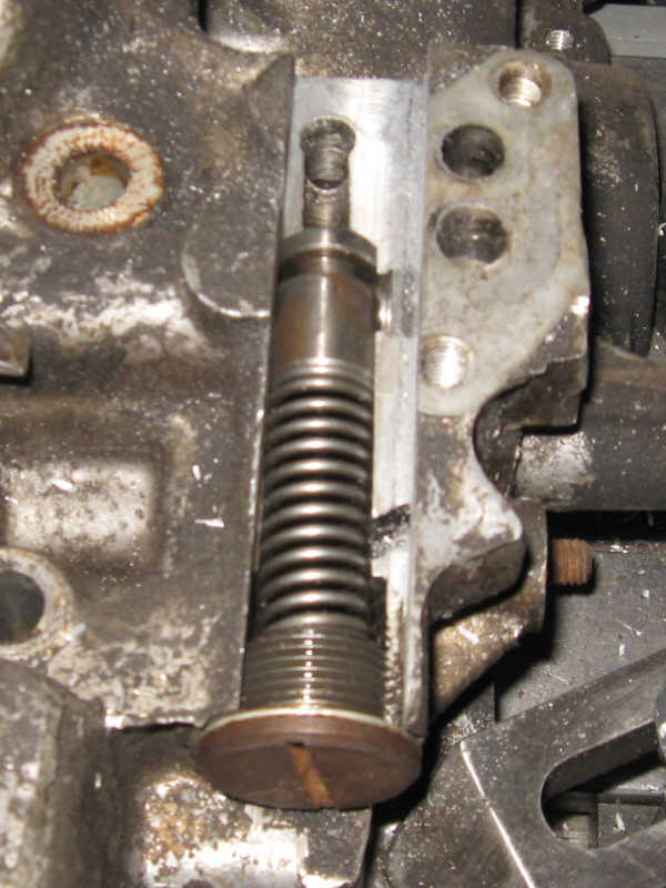

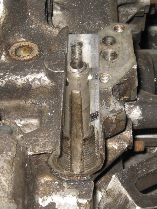

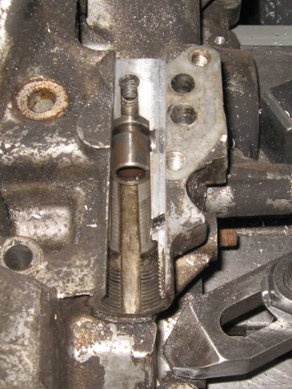

Here's a little visual aid:
Relief valve components installed.
Notice the wear from the spring.
Relief piston in the closed position.
Relief piston positioned where spring marks begin. Shows cooler bypass open.
