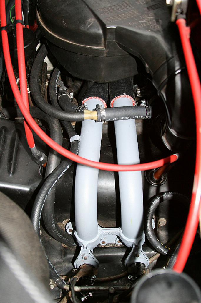

I would get a better hose for your AAR then move from there. I even used clamps on mine. See picture. I have a 1.7.

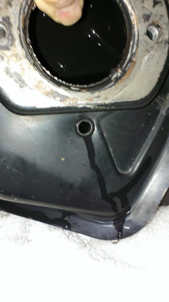

A question about the air box... I don't know what the small tubes are for that seem to run through it. They are about 1/4 inch in diam and I thought they were for some sort of support or something. Anyway, should they be tight? By tight I mean that I can sort of wiggle them about / turn them.
I copied a photo from another post for reference. The tube I'm talking about is the small one in the photo with the water streaming down from it (under the big TB opening).
I seem to recall mine were loose, but I'd think if they are supposed to be "sealed" that my issue would be bigger than what it is.

Those are supports for the plenum; they run from the roof to the floor of it so it does not squish when weight is put on it. They can be open at the ends, but they should not let air into the plenum. The welds (??) around them that attach them to the roof and floor of the plenum seem to crack with some frequency after four or five decades, so it is worth checking those for leaks.
--DD
These can be a source of a vacuum leak. There is a lot of weight and vibration that can cause the welds to crack
