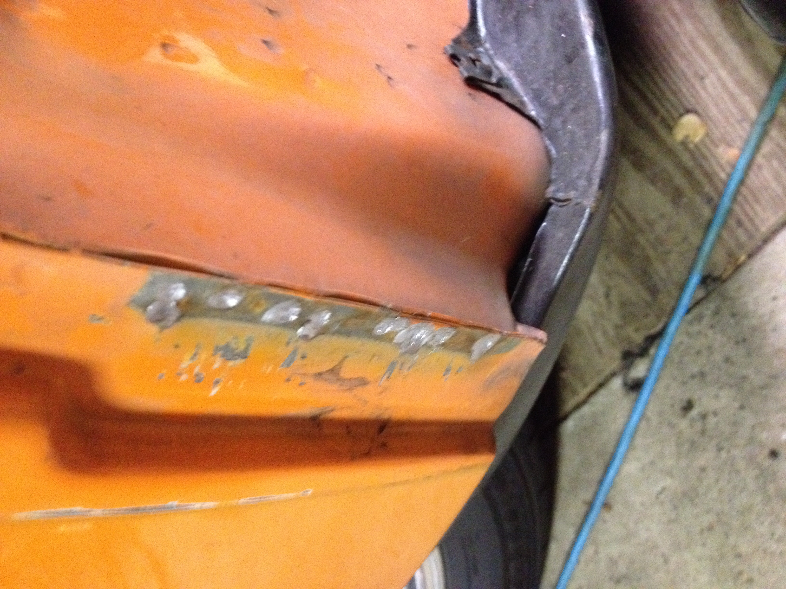

For the front, which I did first, I found it best to leave on the valance, as it not only supports the bumper but dictates it's location. However, that thin BUB support rail has to go first; I used a dremel with a thin cutoff disc. I went through 5 or 6 but BFD (as long as we're using acronyms here). It allowed for a very smooth, fine cut. I also removed whatever flanges necessary by starting a shallow pilot hole, and then reaming the sucker out with a 1/2" bit. Worked fine.

Ok, back. Heres the tab removed..(IMG:style_emoticons/default/sawzall-smiley.gif)
Then I hit it with some krylon paint/ primer to cover bare metal. The rest was straight forward, and worked out well.

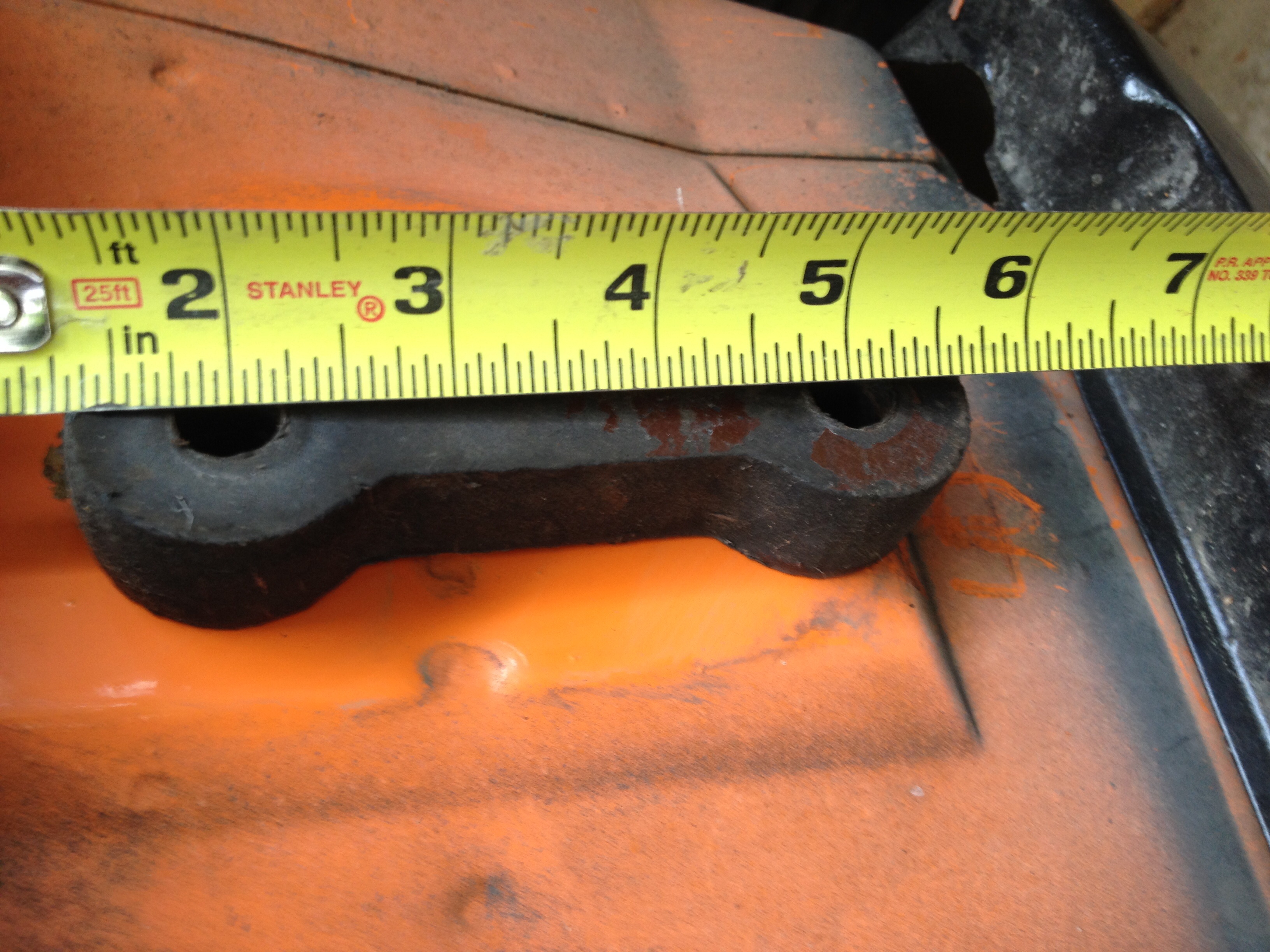

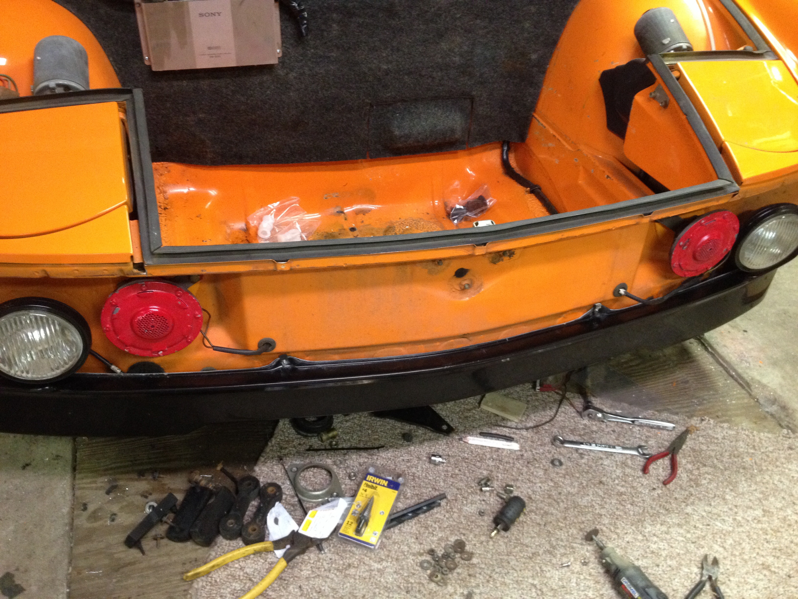

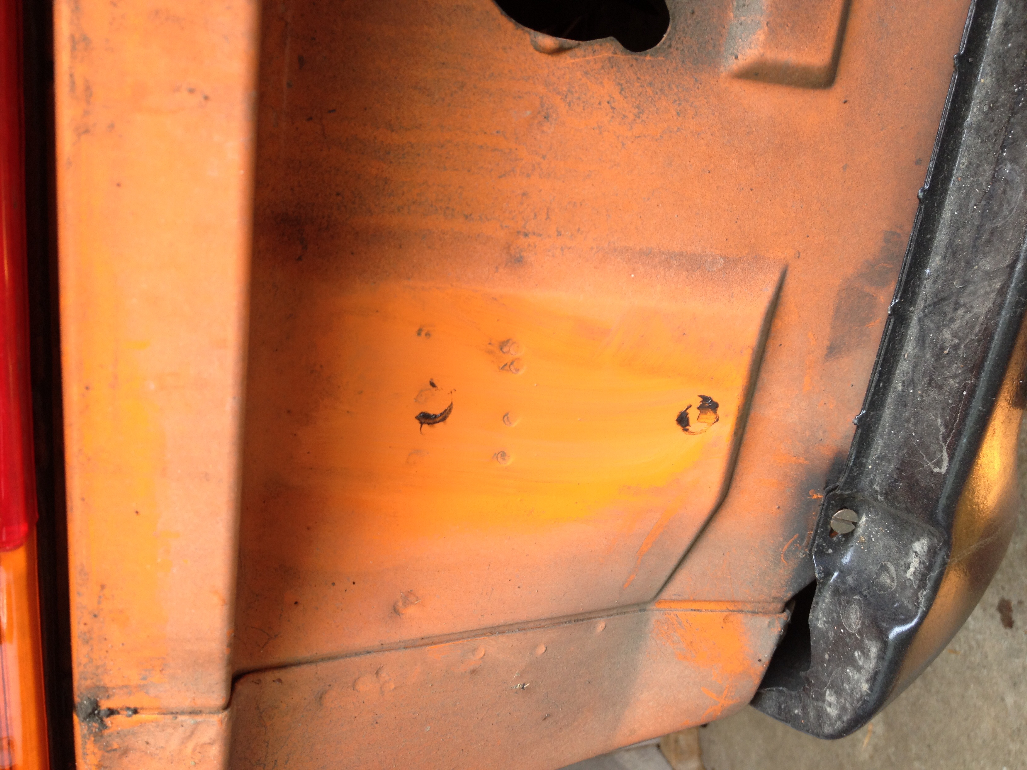

Next was the back. Here is where I deviated from Ken's thread. He had removed the valance, but again, I used it to my advantage. Once placed, it dictated the bumper location. But I had a hard time accepting measurements for hole locations. So after consuming a little head scratching elixir, (IMG:style_emoticons/default/beer3.gif) I decided to let the bumper tell me where to drill. I glued the dog bones into their true position, then, using the sleeve insert as a guide, pulled them out just enough, say 1/4", to smear a little grease as a marker to pinpoint (IMG:style_emoticons/default/shades.gif) the hole location...it worked so well I was able to use the bolts as fasteners instead of a stud...
I'm glad I did as the measurements suggested would not have worked out.
Porschef
post Jun 17 2014, 07:42 PM
How you doin'
Posts: 2,180
Joined: 7-September 10
From: LawnGuyland
Member No.: 12,152
The marked locationsAttached Image

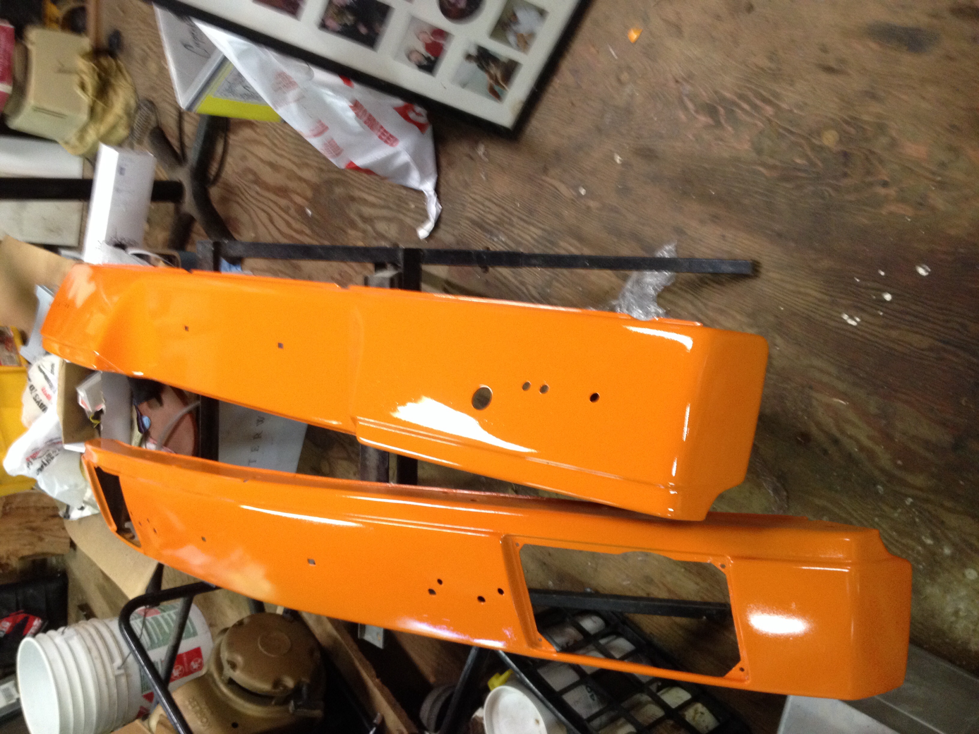

I thought about black, but I needed some paint for the back panel, so went with body color bumpers..
I ain't no ScottyB ...but it's good enough for my lofty standards.... (IMG:style_emoticons/default/lol-2.gif)

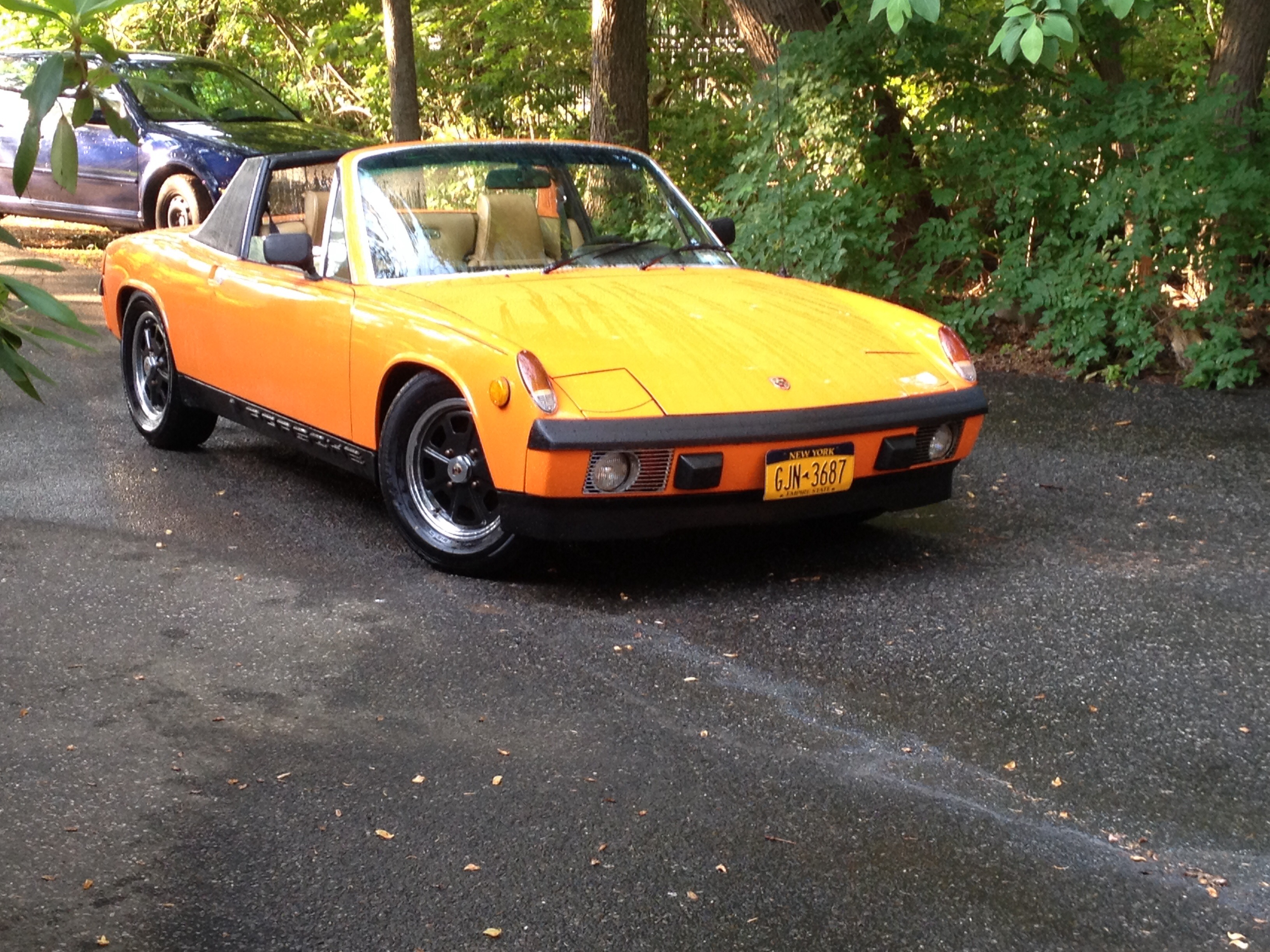

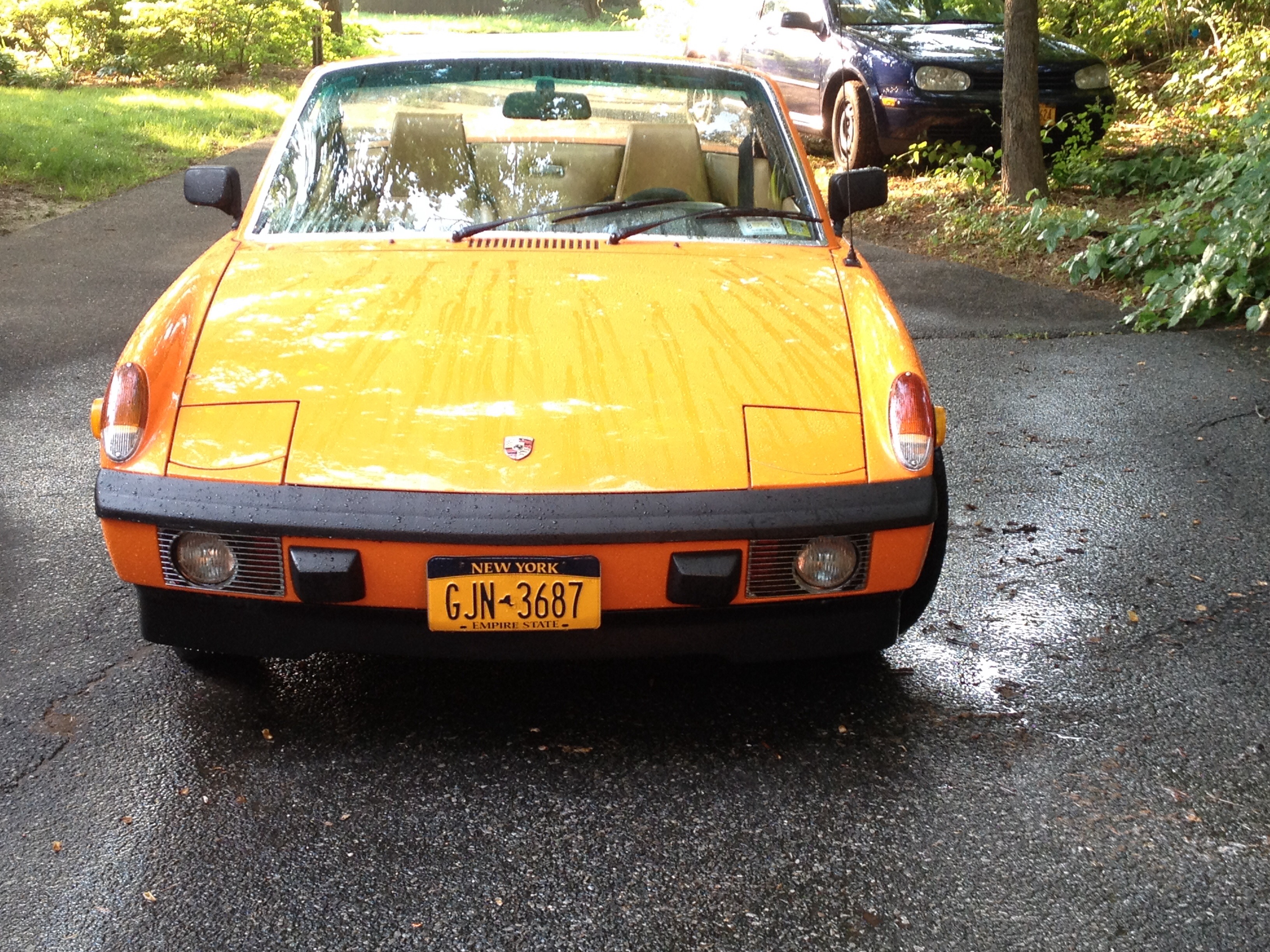

Anyway, here's the money shot...
The wife digs it. I guess I do too (IMG:style_emoticons/default/rolleyes.gif)

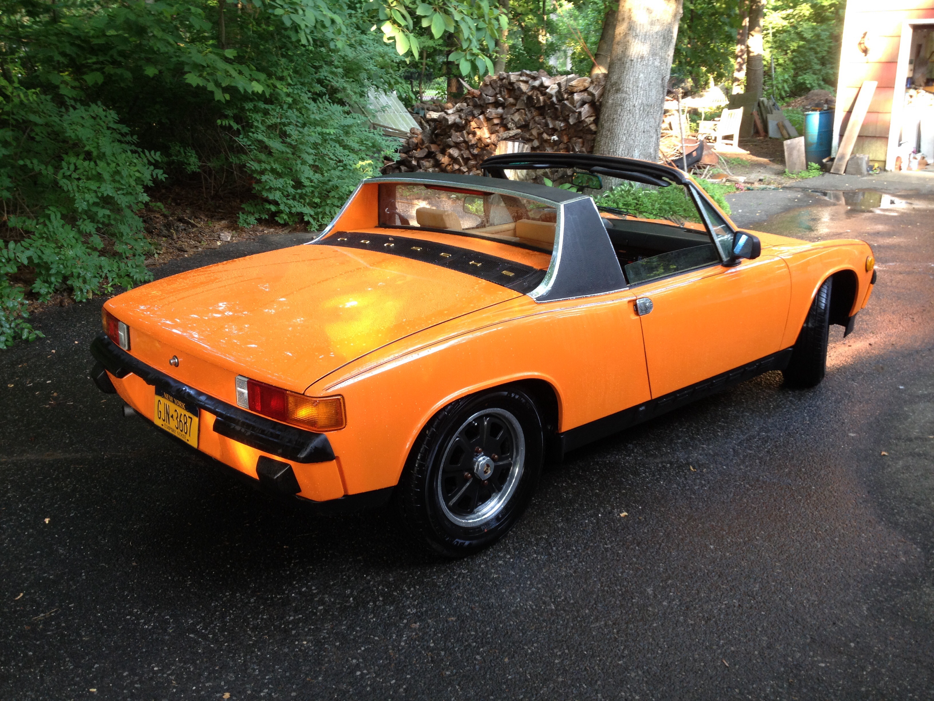

No wait. The spoiler is a nice product
Crazy lighting... No, the car's not two toned...

I think body color bumpers are very cool and enhance the lines of a 914. Nicely done.

The end.
Took her out for a spin on this fine summer evening...sum bitch, she does feel lighter!
Thanks for looking.

Like the blacked-out Fuchs. What center caps are those? 205 tires?

Gentlemen, thanks for the compliments. I really did come close to bagging the conversion for the sake of originality, but losing the weight is a good thing.
The center caps I picked up off eBay. I had to turn them down a bit on the lathe and then open the Fuchs (!) a little on the router table but they're nice, solid aluminum. Tires are 205/65s
