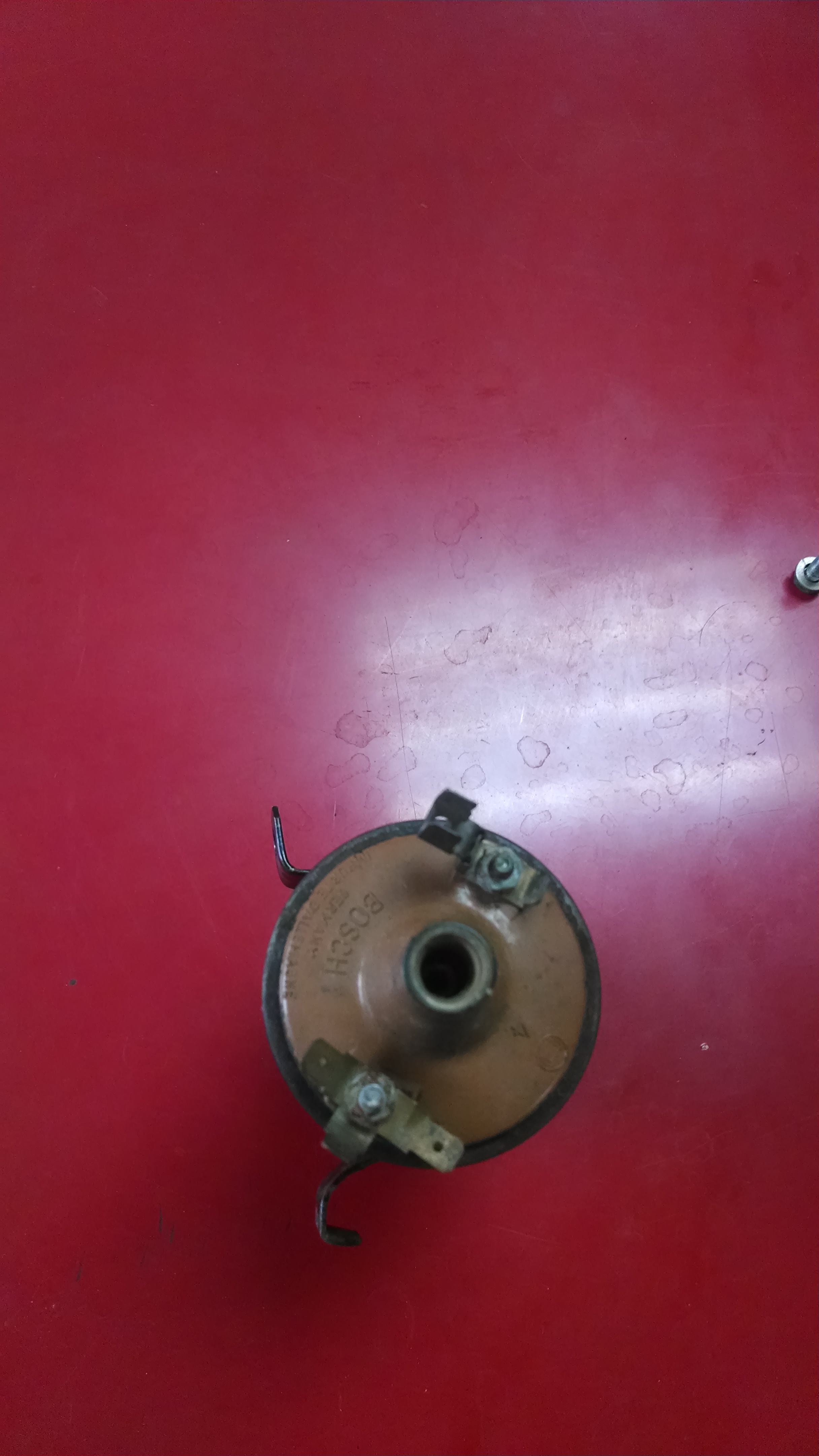

Might want to give us a picture of the coil and the bracket ....................

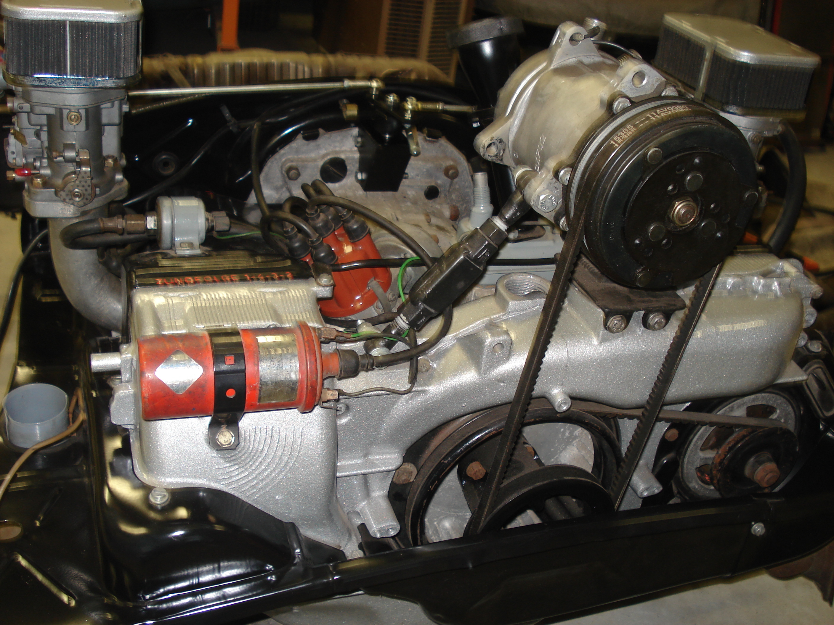

My 76 2.0 has those holes and the coil was mounted on the case in the back as in the pic. PITA and hot to get to. The first clue that this wasn't ideal was at an evening autocross events in which the engine was misfiring and blue arcs were all over the engine bay. The coil had fallen out and was dragging by the wires.
The bracket uses a long screw the same pitch as the engine tin. You bend the stock bracket to fit into the top and then use the long screw to pull things tight. Problem is it starts to get tight with a lot of space between the bracket and the housing so you feel like you are squishing the coil (source of my problem was being scared to go tighter).
So I have switched to the engine tin location as suggested. I also have taken to liking the epoxy potted anti vibration coils. I have a "Blaster" (IMG:style_emoticons/default/lol-2.gif) , but there are a lot of them out there. My idea is that the coils fail from wires eventually parting company inside. Don't know if that is true but they aren't pricey.

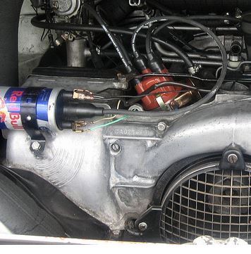

OK I got this picture on Google for a VW type 4 so maybe I have a bracket that went on a type 4 bus engine that uses a smaller coil? I was expecting the bracket to mount flush like this picture.

OK I got this picture on Google for a VW type 4 so maybe I have a bracket that went on a type 4 bus engine that uses a smaller coil? I was expecting the bracket to mount flush like this picture. Maybe I need to buy the Red Bull brand coil!

With the extra holes on that, I'm betting that it's a "custom" bracket made out of plumber's strapping.
--DD

Nope. That's the factory bracket. Let's see a picture of the cil in question.

Yup, stock bracket. You can just barely make out the raised square section of the factory bracket.

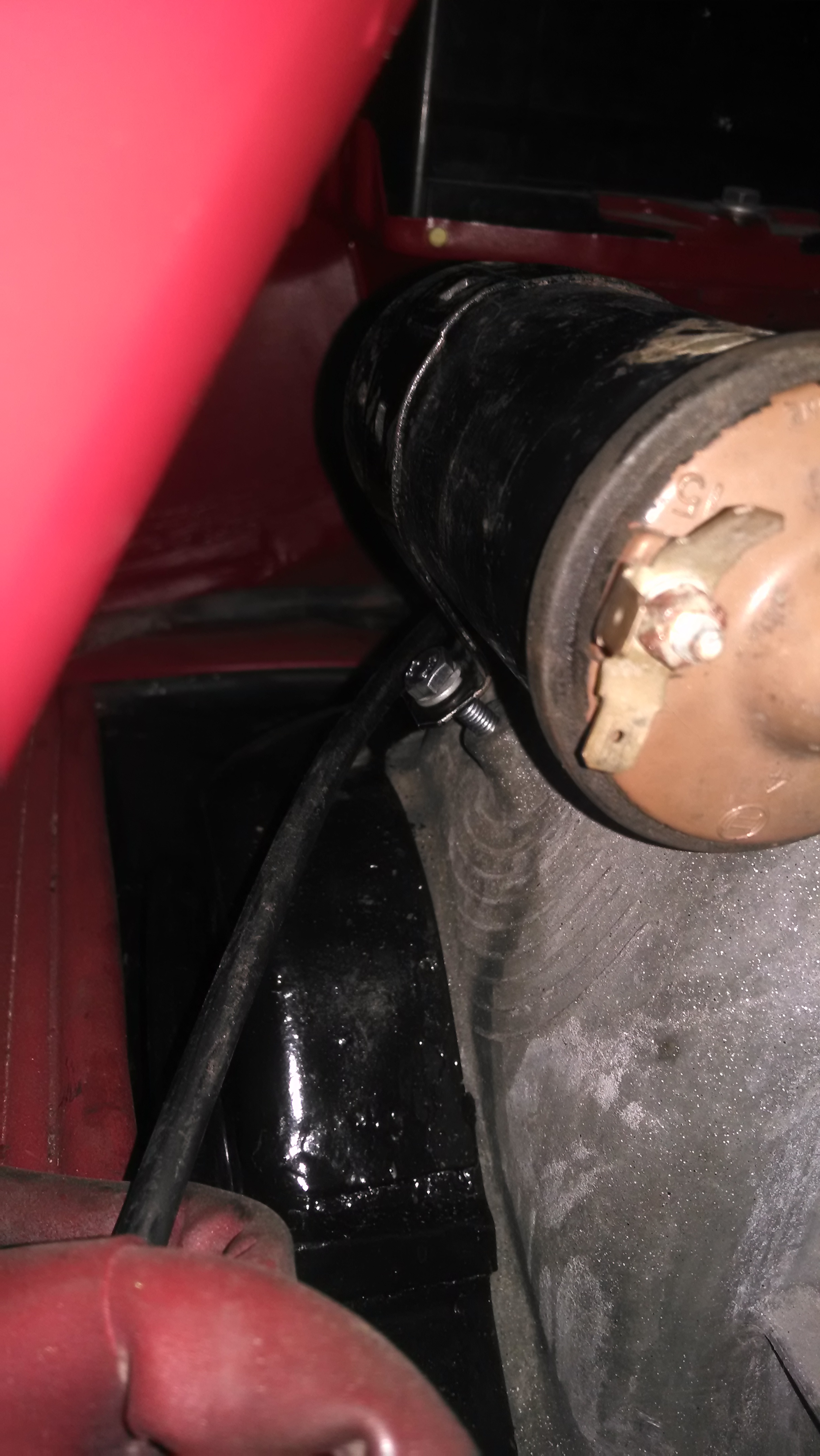

OK I think I figured it out probably the bracket was bent up so I tried to bend it back and then used a longer bolt to secure the coil in place. I still have a little gap between the bracket and the housing. I used a nut and some lock washers to secure it. On to hooking up the rest of the electrical and maybe a running car again!

Way to go. I would put a nut and washer between the bolt and the fan housing. Lock it either against the bracket or against the shroud once you've tightened it all down. Maybe you've done that already, but it's not in the picture.

Yes I did put a nut there so it shouldn't back out on me. Thanks for everyone's help!
