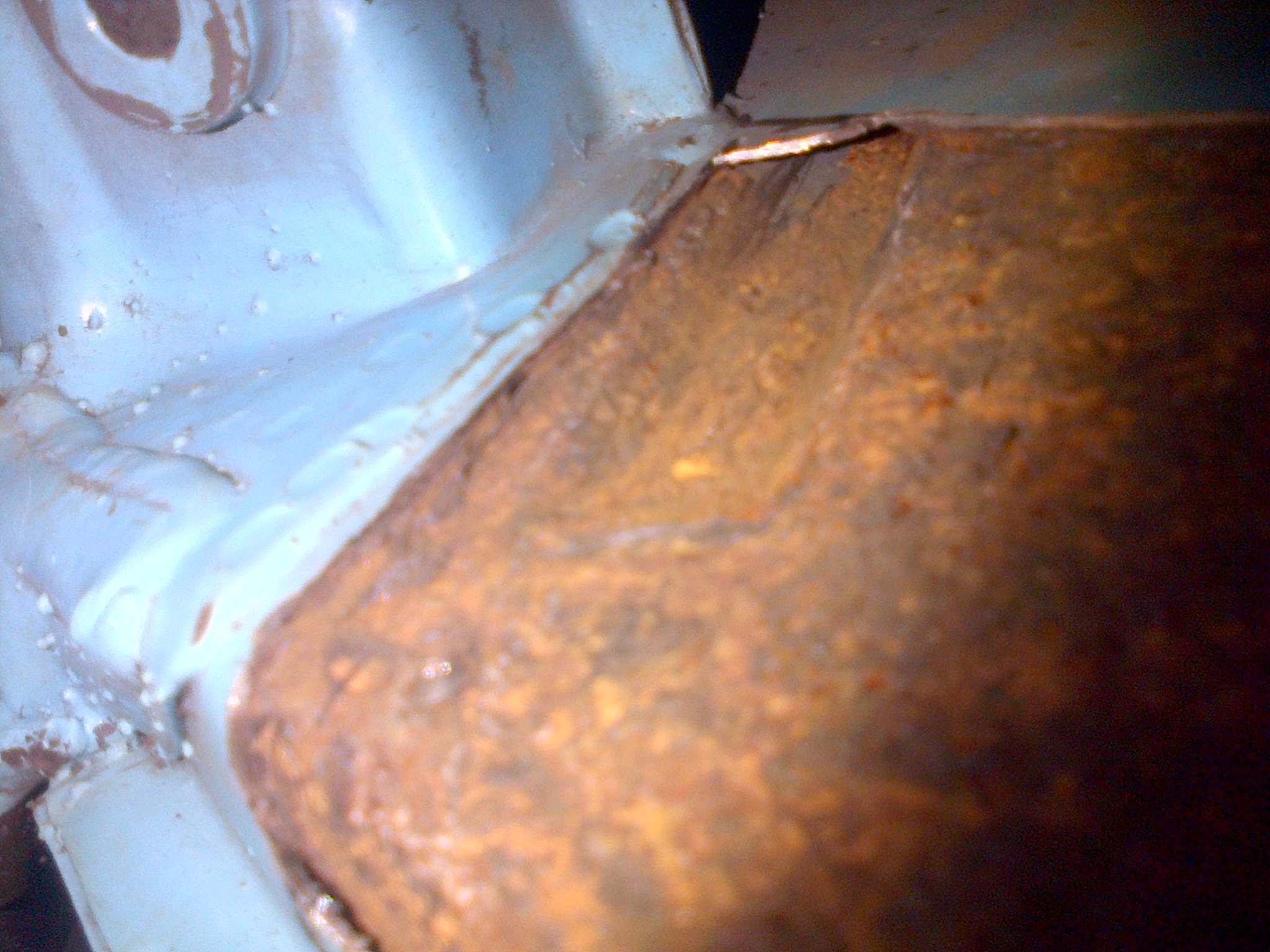

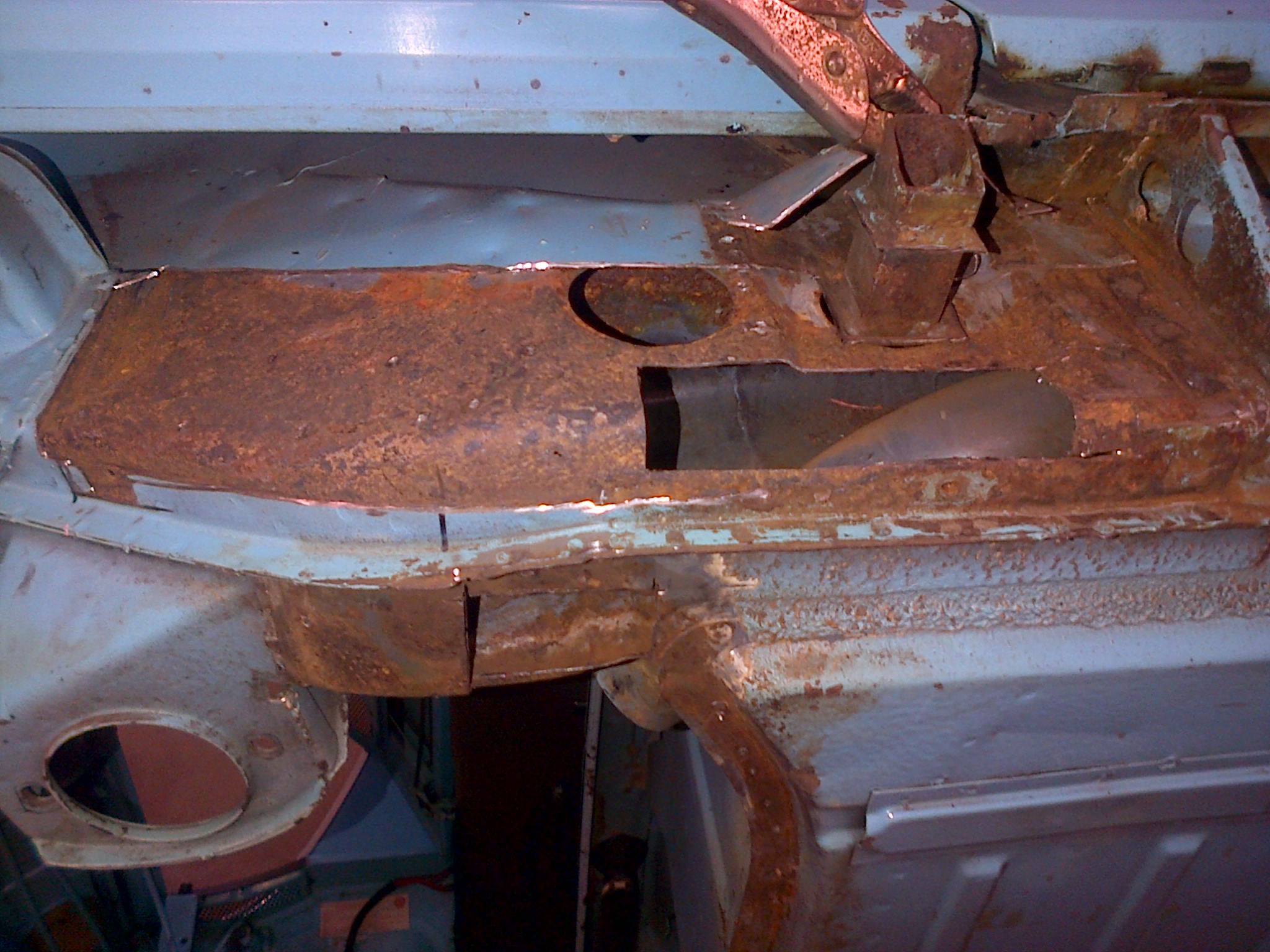

Sorry I should have included pics. here are a couple.Attached Image Attached Image
The rust is not that bad, yet, but I would like to stop it. I'm not going to probe any further there still is a lot metal thickness. I will replace what I have removed and do some further external reinforcement.
I once heard of a product that creped into cracks and crevasses by capillary action to kill rust but I can not recall where.
Thanks for your response.
