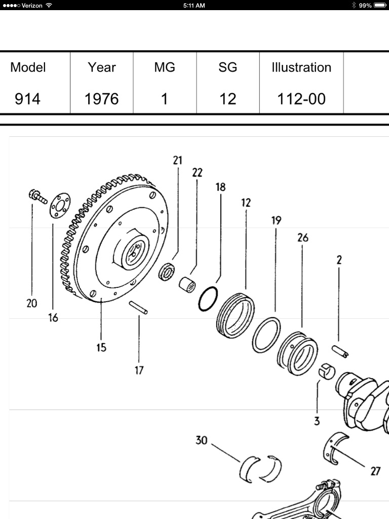

Mblizzard
post Aug 6 2014, 03:14 AM
Posts: 3,033
Joined: 28-January 13
From: Knoxville Tn
Member No.: 15,438
O-ring on the hub part of the Flywheel. Number 18 below.

Yes Anytime you replace a part (case, crank, bearing, or flywheel) the end play needs to be rechecked. the pocket in the flywheel determines the amount of shim required. the face inside the pocket seats on the crank and the face on the outer edge sets the amount of shim required. The "o" ring stops oil from leaving the bearing or shim pack and going past the bolt threads onto the clutch. It set in the grove between the two faces. Back the clutch cable off and wedge the throw out bearing away from the clutch then start the engine. That will insure that the noise is not the bearing. next reset the cable, start the engine, push in the clutch, listen for a change in noise, with the clutch pushed down put the transmission in and out of gear, notice any change in noise- pilot bearing. Gordon

I thought the conversation was moving in the right direction, so I simply made a quick mechanical point. Here we go with a more complete answer. No, you don't really need to set the end play after changing the flywheel, unless it's a knockoff. The crank and case are the primary determining factor, and the OE flywheels are pretty much right on the money. You should, however, ALWAYS check it. The noise described in the OP isn't likely to be a result of improper end play. Onward: While the release bearing can make noise, that noise is most common when the clutch pedal is depressed and the bearing is under load. If the ball cup in the release arm has become badly worn, or if the flywheel has been cut too far, the arm can touch the clutch cover and a grinding noise occurs. If the pilot bearing fails, significant noise will occur when the clutch pedal is depressed. It will rapidly deteriorate and shifting will become difficult as the mainshaft will be pretty much connected to the crankshaft. If the starter "hangs up", there could be more than one cause, and it'll both make noise and remove teeth from the ring gear. Starters get old, dry, and non functional in several ways. It works, so we know the bendix shoots out and turns the flywheel. However, it may not fully retract in a timely manner. Bad spring? Dry shaft? Can't tell, maybe even with the starter out of the car. Another cause may be a faulty ignition switch or feedback into the "50" circuit. Often the hangup will remain even when the engine is revved, but the noise of the engine drowns out the sound. This usually leads to a blown up starter. I've even seen the starter body shatter.
If the o-ring in the flywheel fails or is deleted, you're gonna have an oil leak, which will quickly coat the clutch disc, the flywheel, and the pressure plate with oil, but there'll be no noise connected with that problem.
