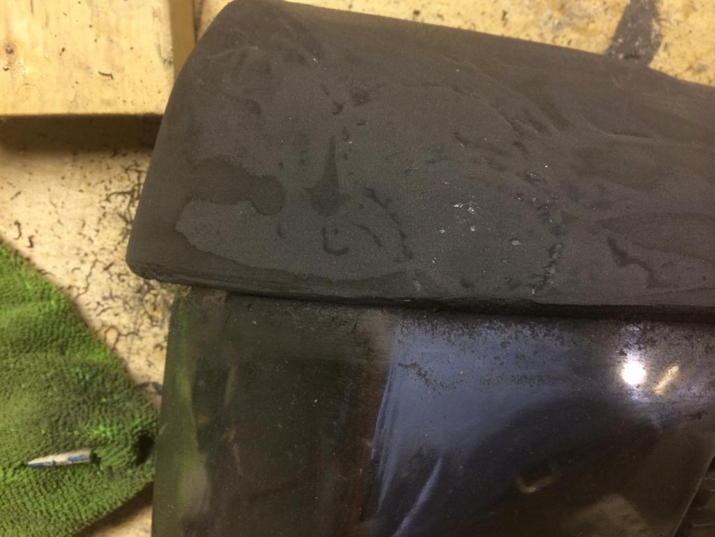

This is what it looked like after about 5 minutes of sanding with 100 grit paper.
It sands slowly. You almost have to "worry" it off, but it does sand. The durometer feels almost exactly like the original and there is no adhesion break at the joint.

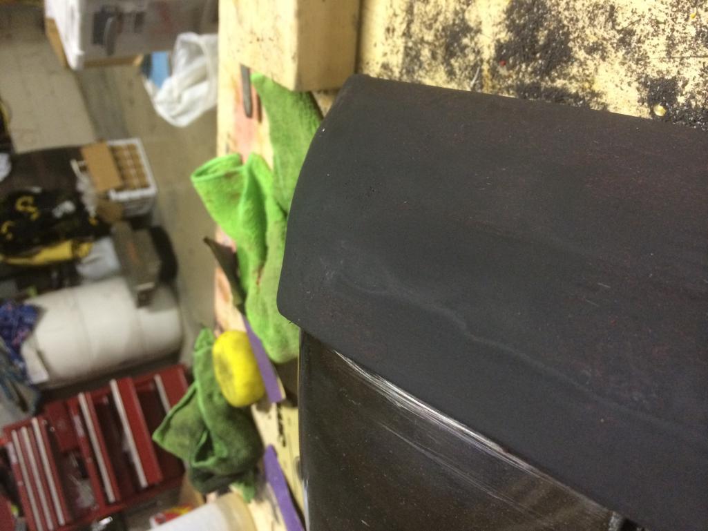

Here it is after maybe 15 minutes more sanding with 200 grit. It does not wear out the paper!!
You can see how much I removed by the debris under the bumper.
Looking pretty good!

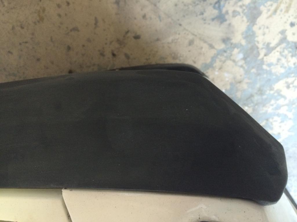

The thin top fill layer dried in a day and had perfect adhesion to the under coat. Some more sanding with 200 grit along the entire pad to blend it. Again there was no evidence of bond failure anywhere, not even in a small tear that was on the bumper.
I also patched a small chunked out spot on the sharp upper corner of the pad. Worked like a champ!
Looks pretty good. There is a slight difference in the original surface texture that grabs the light at certain angles and I can see the fix because I know it is there. You would not notice it unless you looked very critically up close. Again the hardness is nearly identical to the original.

Another "done" pix. Not sure how it will wear but this stuff is unaffected by years of exposure on boats. Wonder how it will look after application of some of the popular rubber preservatives like Armorall??
