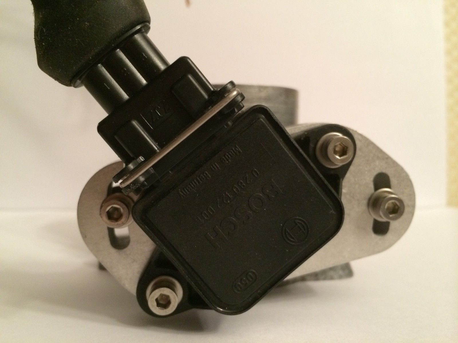

If you are still looking for a TPS setup, I made a few adapter plate for a bosch sensor.
You can search on ebay for: Porsche 914/VW Throttle TPS Adapter/Bracket MegaSquirt ECM
I'm also in the process of making an IAC controller that will accept a PWM signal to control the position.
Regards,

I have mine running already, but the adapter for the TPS looks a lot like that one.
