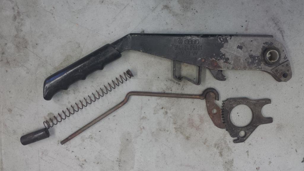

It's a late car; when I pull up on the eBrake handle it doesn't set. It will go back down to the floor. Is a part sticking ?

There is a toothed pawl that should catch on the larger toothed part. The spring in the handle should engage it. I have parts for them. Can get you pictures tomorrow. The button unscrews. There is a spring under it. The spring may be bent or broken. You can do that with the handle still in the car.

If the spring were bad I would think there would be no tension on the button. Could be the rod that pushes on the pawl.

Jim, unscrew the blk plastic knob and look. Sounds like the spring broke. Is there tension when you depress the button? If so, I would think the spring is good.

Unscrewed the button and pulled the spring; spring is not broken. Replaced both and still doesn't catch when pulled.
Is my next step going to be seat removal and ??

There's a rod inside, the one that the washer, spring, and knob work with, and it has a welded flat steel finger near the bottom that has a well known propensity for breaking off. You need to remove the lever assembly and take a look at it. WARNING!: There are early and late rods, and they don't interchange!

You are going to have to replace the handle. I have not found a way to take them apart without damaging them. I have a used one that needs paint and a replacement handle. I think they are still available as they are the same on 911's.

Here is the layout of the parts.

Is the rod and piece on the right end one piece ?
