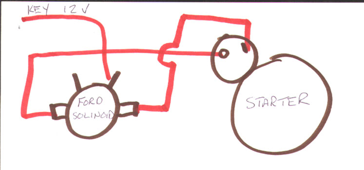

Maybe a visual would help.

Can I ask why your pic has 2 spade connectors??

Battery cable & alternator cable to one side of the Ford solenoid. Equal size cable from the cold side of the ford solenoid to terminal on starter and smaller gauge wire from same terminal to starter solenoid spade terminal( in other words, two wires from cold side of ford solenoid to starter).
Yellow wire (normally to starter) to terminal on ford solenoid.
