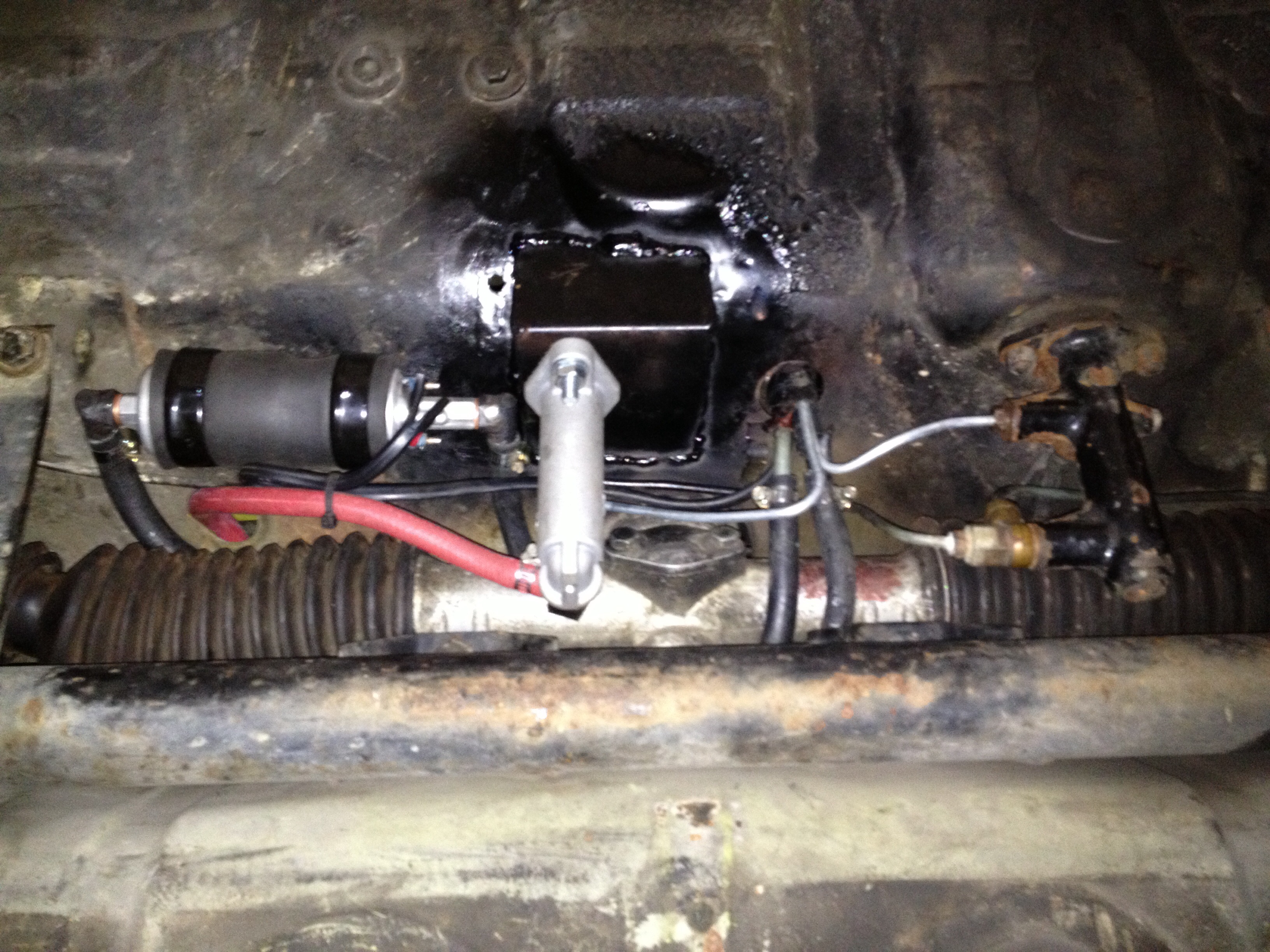

Here's mine

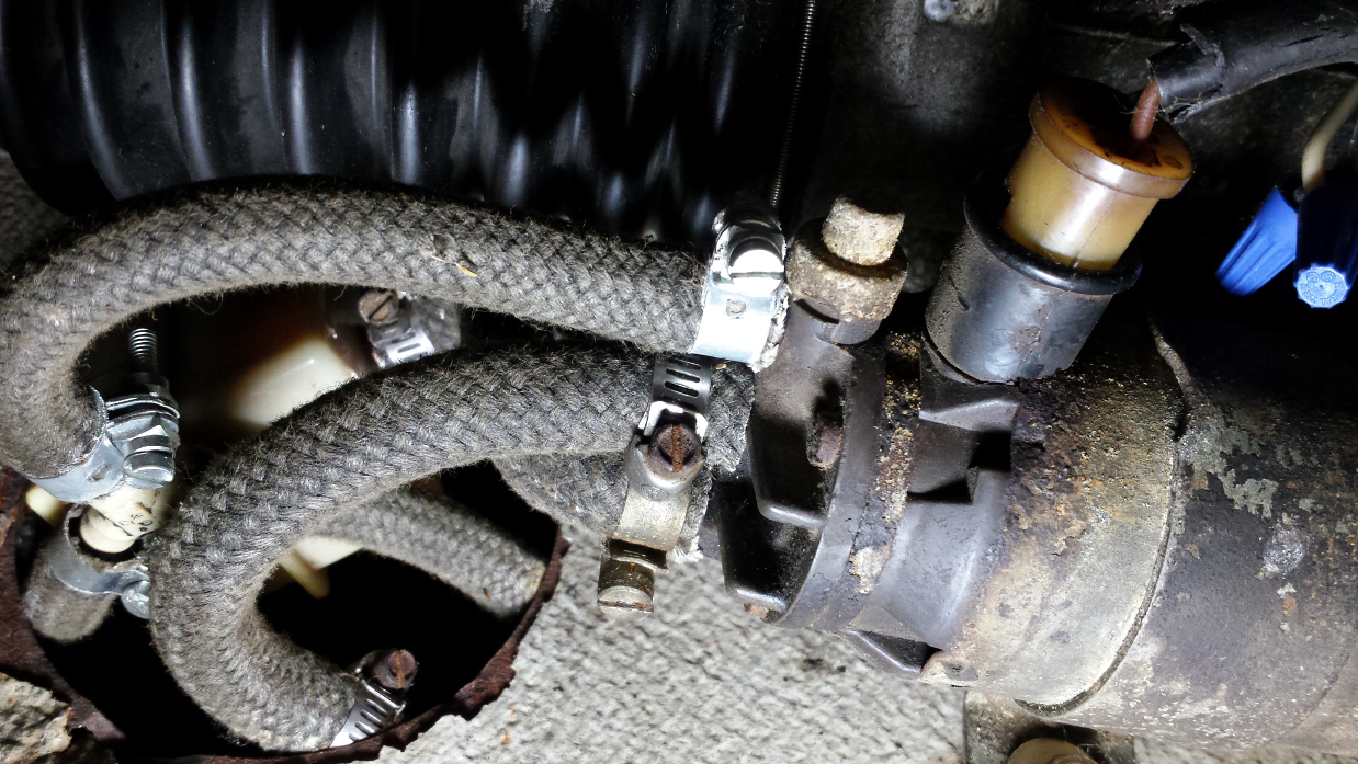

Here's mine, it's in the steering linkage tunnel and seems to use an existing hole in the unibody. Don't recommend this, if you look at the line that goes to the filter, it runs in a Z shape behind the other two lines and that filter is just loose in there. I think that linkage boot is pushing it around kinking the hose and causing loss of power via fuel starvation.

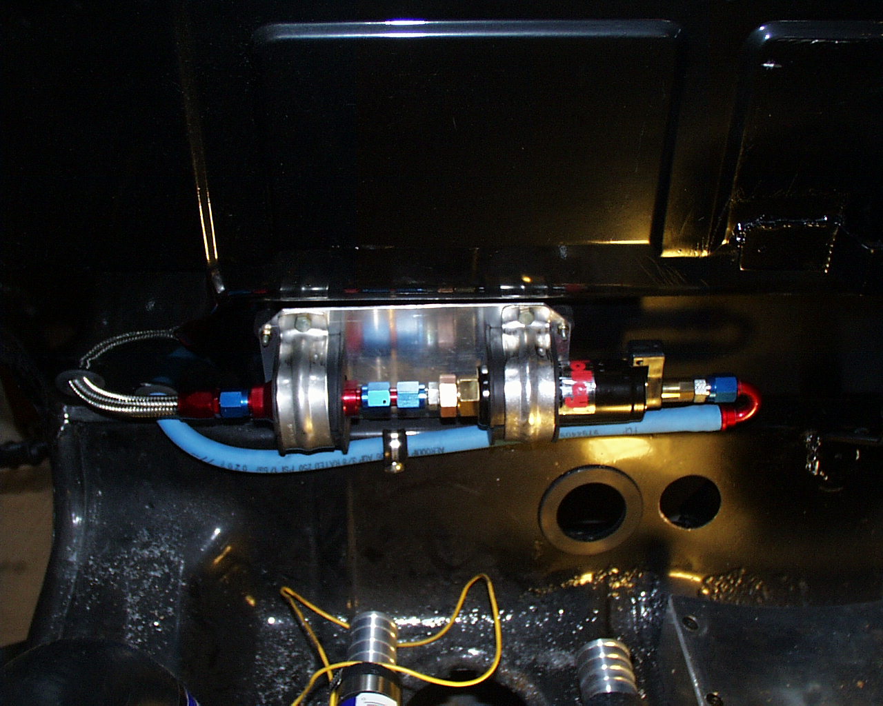

Here's what I did. Not much room for good hose routing but it works.

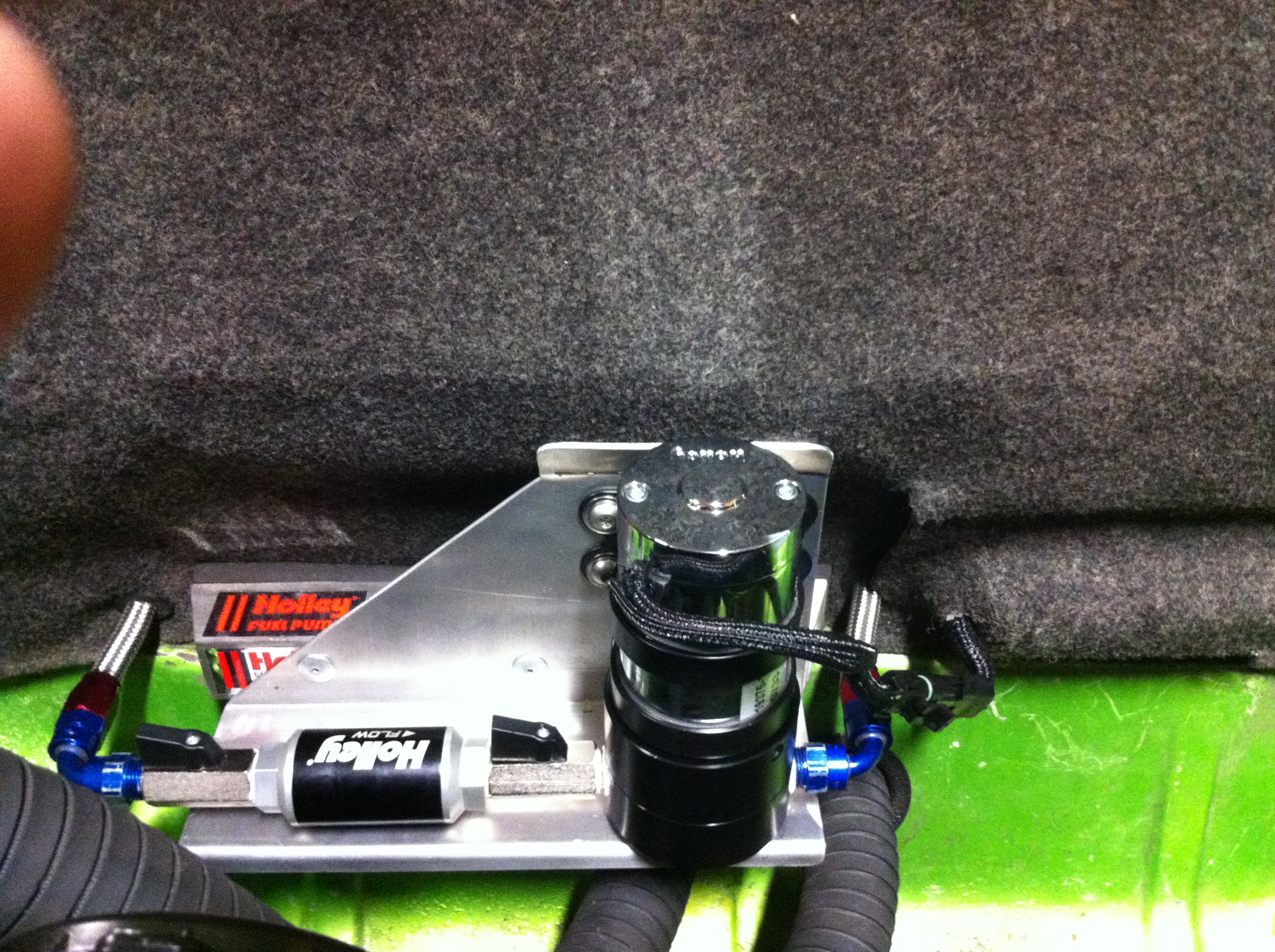

I did it this way,, it's all hidden when I put the spare tire cover on.

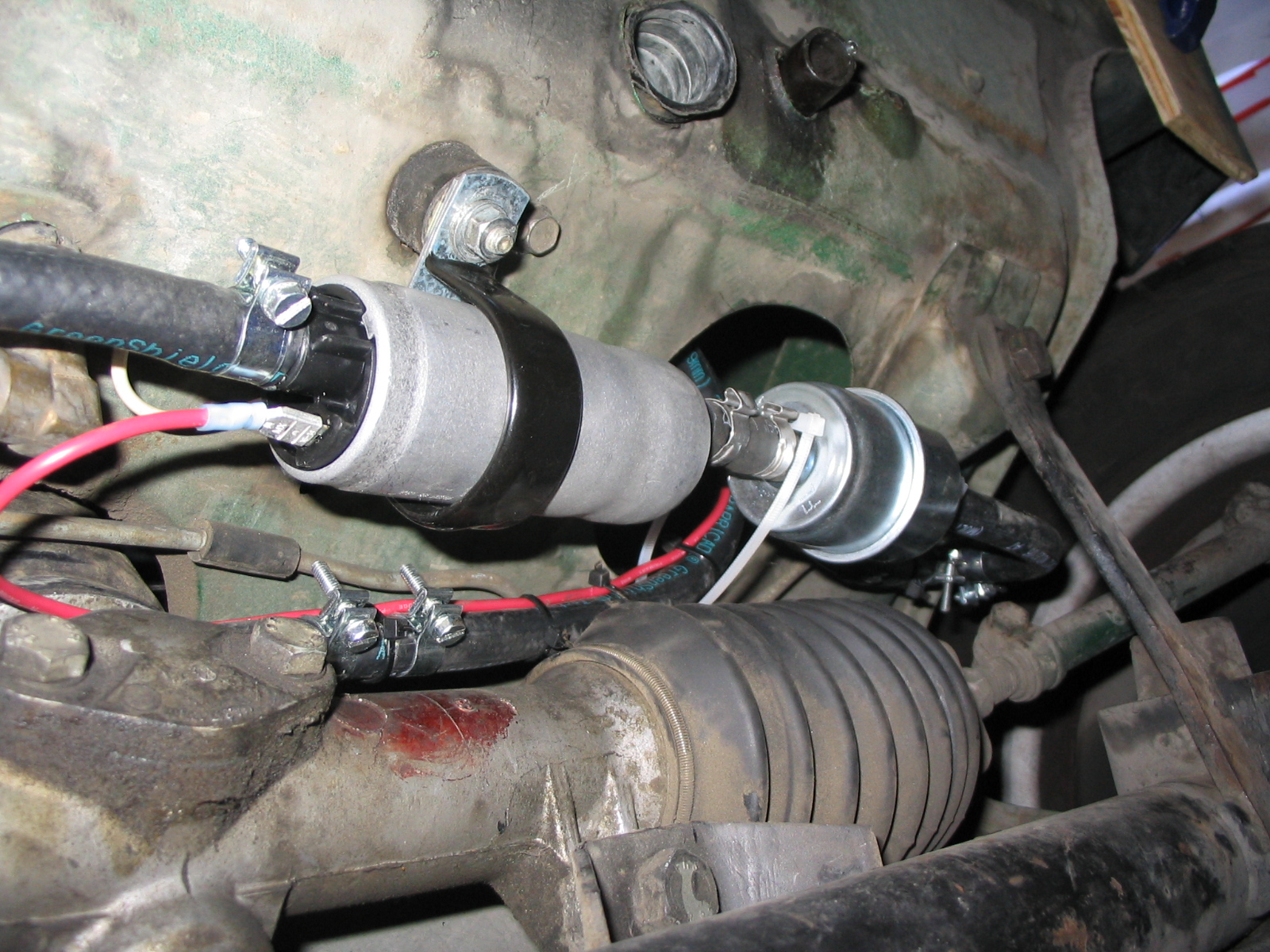

And here is mine
