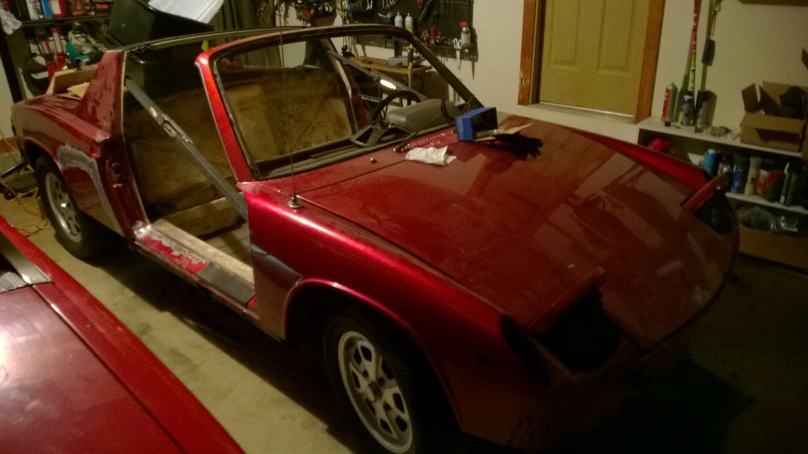

Ok, here goes. I picked up this '75 last April in lower Maryland. It was advertised as a 2.0, it has a 2.0 badge on the back, and it looked pretty good from a distance (or with beer goggles).

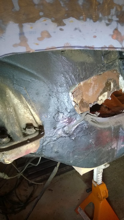

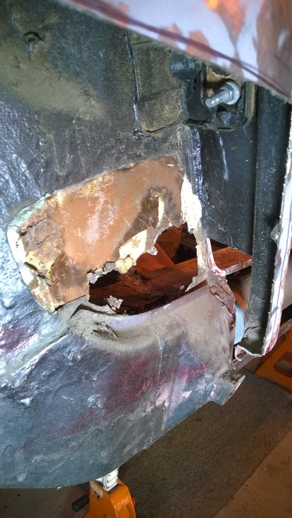

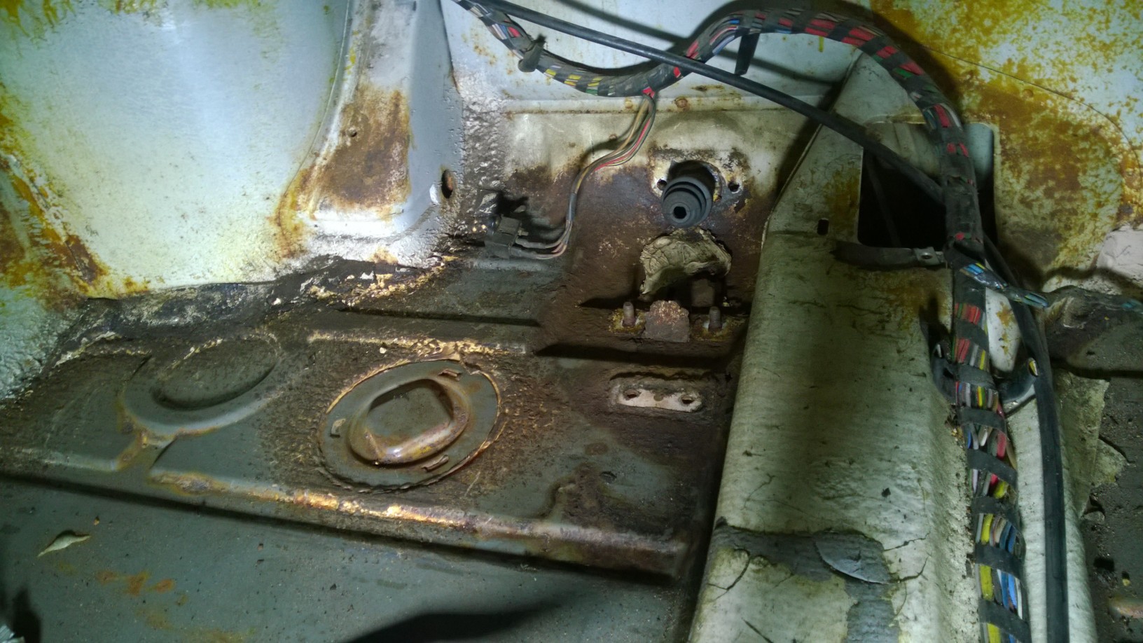

But when I got it home I found that it was actually a 1.8L and it had some ugliness as seen in the hell hole below:
And the floor pans aren't in great shape:
I'm pretty sure the longs need work, so I plan to tear into those in the next couple of weeks.
This is going to be a bigger project than I anticipated....

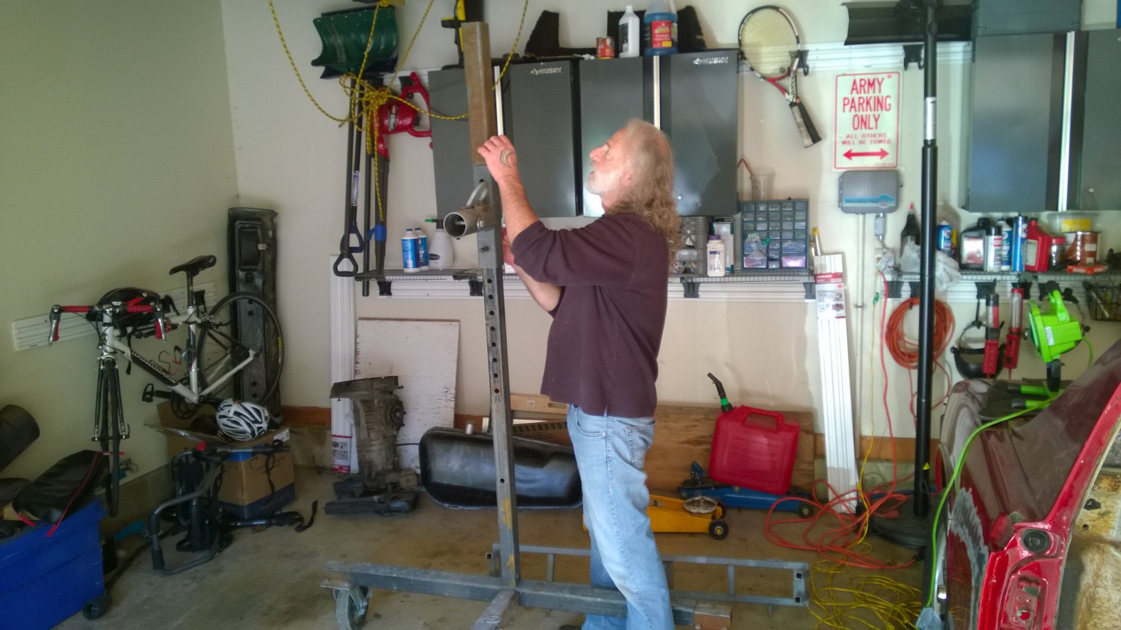

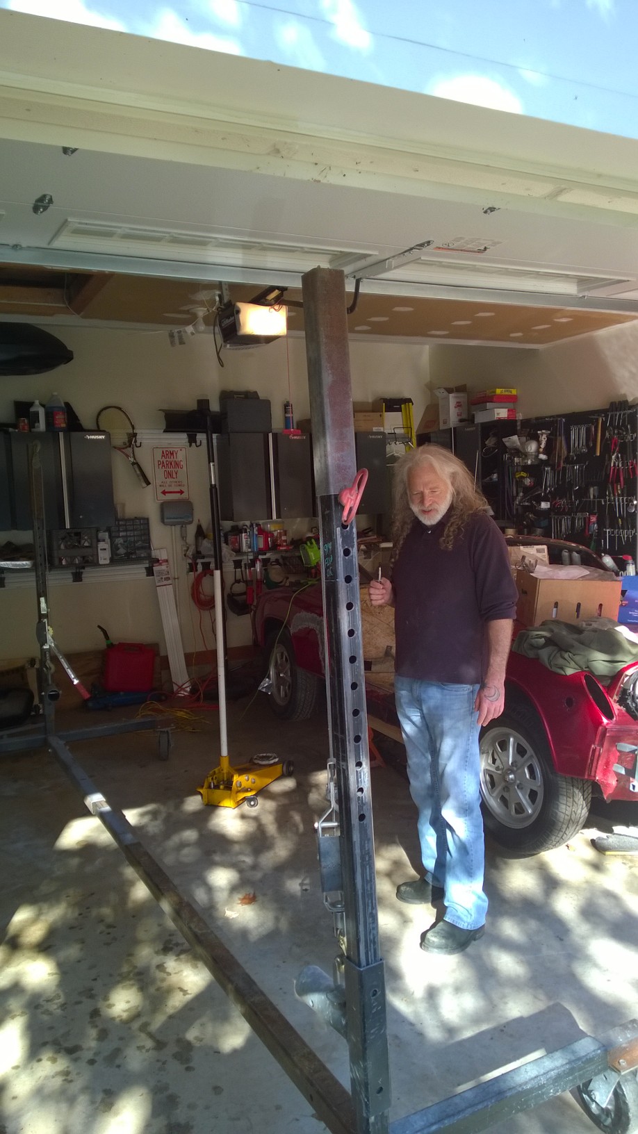

Anyway, I picked up a 2.0 engine that's been built out to a 2056. Now I just need to get serious about fixing up the tub. Today was a big step toward that. David (Half Moon) is letting me "borrow" his rotisserie, so I have no excuses now. I don't know the full genealogy of this rotisserie, but I think it belonged to CptTripps before David inherited it. Anyway, here's David dropping it off and helping me set it up today.
And setting it up in the garage. Honestly, I did help. Some.
Ready. Sort of.

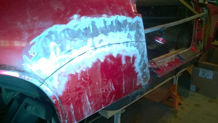

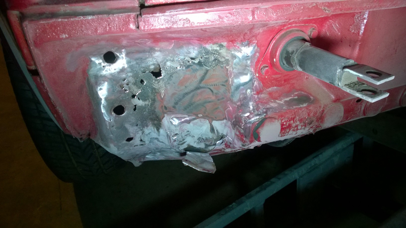

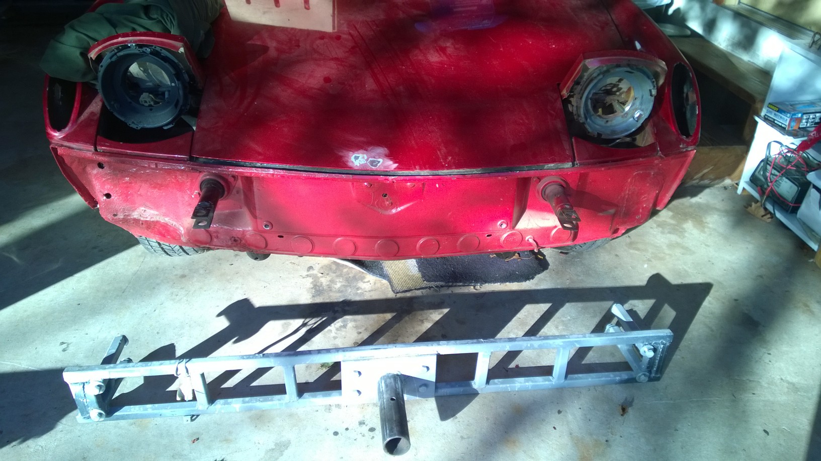

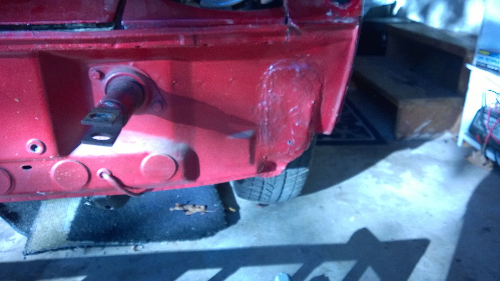

Now I just need to get this thing up on the rotisserie. Give that this is a '75, I know the mounting solution needs to be modified. It's also a little complicated that it appears the PO, or some PO, appears to have done a pretty piss poor repair to fix the front end following some moderate front end collision:
Don't think it's good idea to trust suspending the car on whatever that is. After a little grinding, and a LOT of bondo dust, it looks like this:
Yeah, that's not going to hold anything. I'm going to see if David's ok if I modify the front mount bracket for the rotisserie so it fits the '75 bumper shocks. I think Zach documented this somewhere, once upon a time.

The rotisserie very conveniently comes with some door braces, which I've rigged with braces I built a month or two ago (picture below shows only my original bracing solution):

I'd strip the suspension off the car before trying to hang it. Lighten the load first

Good point, and absolutely.

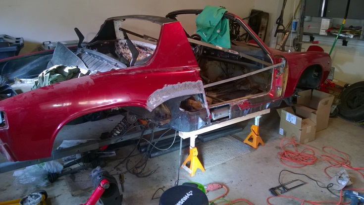

Consistent with recommendations, I felt it best to unload the suspension and other unneeded “stuff” both to lighten the car on the rotisserie and also just get it out of the way. I took off the front hubs, and I still need to remove the rest of the front suspension. But I focused on the rear for now.

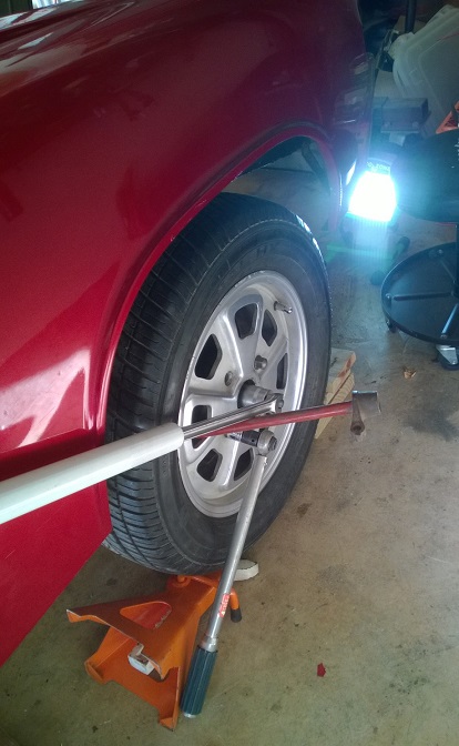

My first challenge was getting that axel nut off without engine/tranny or brakes in car. The wheel kept turning under the torque, but with enough PB Blaster, heat from a propane torch, some blocking leverage, and my son sitting on the car to give it extra weight, I managed to break those free.

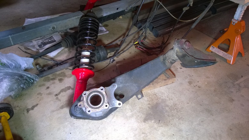

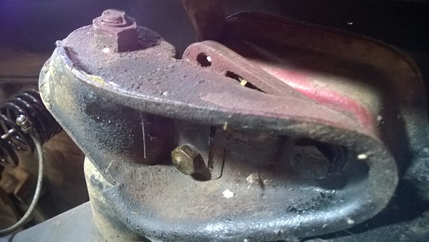

Anyway, after removing the drive axels with a gear puller and banging out the hubs, it was time to take out the rest of the trialing arm. Here’s a picture of the bolts connecting the arm to the body. There were two shims there (don’t know what size), and I know from reading here that these are important to rear wheel alignment. I imagine I did not do correctly whatever I’m supposed to do to make alignment easier upon install.
Stupid question #1: is it the number (or total size) of shims present and/or the positioning of the shims that determines the alignment?

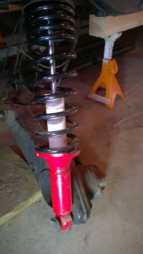

Here is the trailing arm removed. Stupid Question #2: what brand of shock is that? It’s been painted over.
Anyway, now the car has no rear suspension. Much lighter!

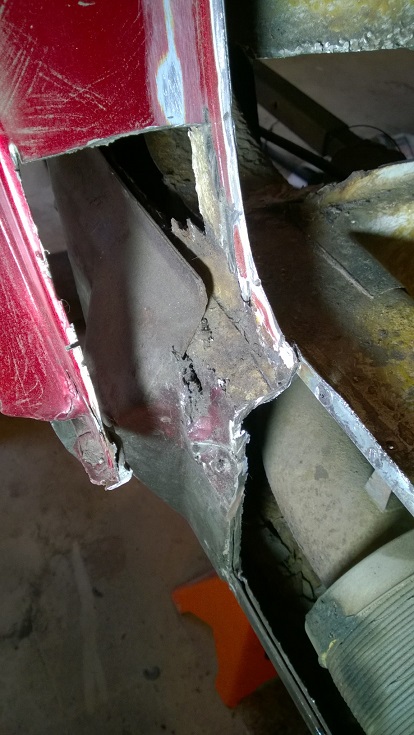

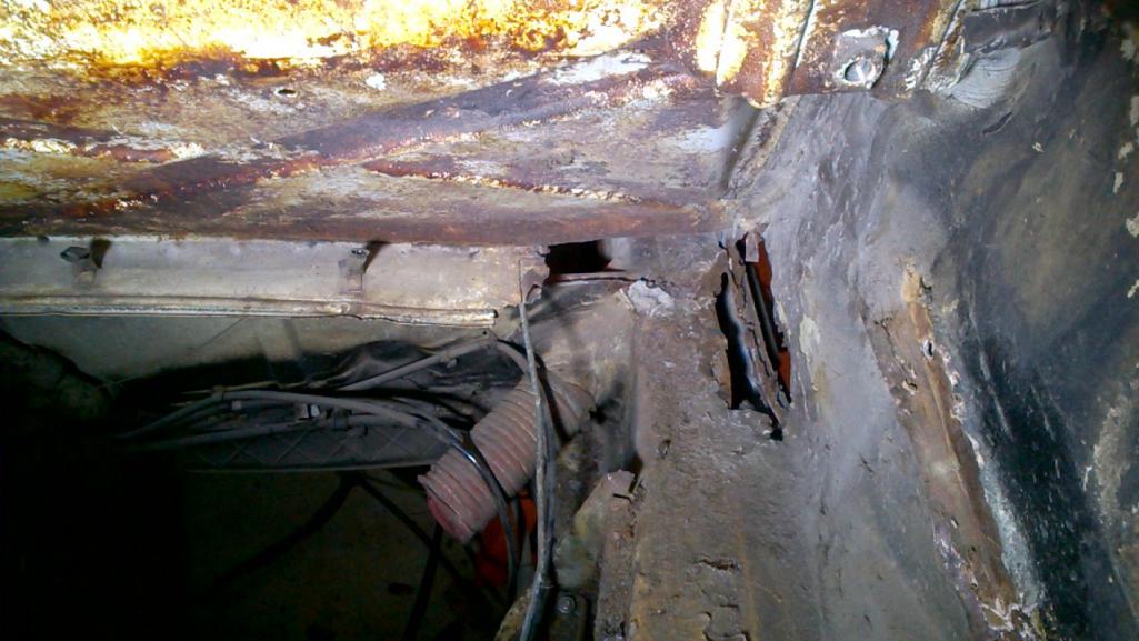

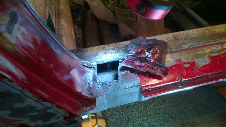

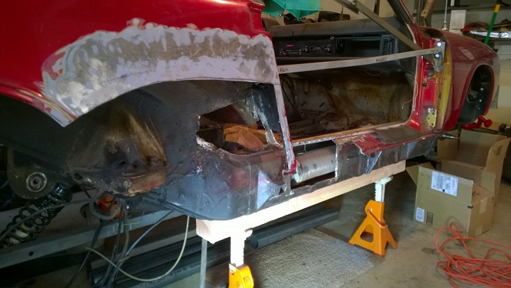

Then it was time to start cutting. I’ve spent way too much time thinking about it. It’s good to just dive in and commit. My goals are pretty simple: learn and hopefully be pleased with the end result. So after removing the rear suspension, I started cutting. Here’s what I’ve found so far after some exploratory “surgery.”
The PO used some pretty funky stuff to do his hell hole and long “repair.” It involved lots of sticky stuff, globs of paint, something resembling tin foil, another substance resembling something ceramic, 18 gauge sheet metal, and unicorn farts. Ok, I’m kidding. There was no sheet metal involved.
And here’s where I “retired” for today. I’m glad to at least be committed at this point. I’m hoping to do some more cutting into the long this weekend and get the rest (or most) of the outer long removed.
Stupid question #3 (yes, I’m keeping a running total): I guess I’m going to need, as a minimum: outer long and door sill, right? I previously purchased the hell hole restoration kit from Mad Dog, which I need to start shaping.

white shocks indicate KYB....toss them in the trash. Alignment is based on the thickness ( number ) of shims. They only go on one way
Don't buy anything quite yet, but plan on:
http://www.restoration-design.com/mm5/merc...tegory_Code=914
P331
P319R
P302
P303
P351
P342R
P315
P316
P317
P318 (maybe. Can't tell from the pics)
Fabricate a hell hole patch
Fabricate lower firewall patch
Fabricate outer skin if you have to replace the inner long ( P351) in the engine compartment.
