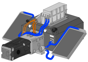

mgp4591
post Dec 6 2014, 03:16 AM
Posts: 5,908
Joined: 1-August 12
From: Salt Lake City Ut
Member No.: 14,748
Interesting side rad setup... would you have that much room on the sides and still keep all the rear trunk area? Maybe the rads would have some ducting to direct the airflow and you could run them flatter in the compartment to save room? I'm going with the upfront design but laying down at an angle but I'll definitely look into this setup for a turbo intercooler and oil cooler solution. (IMG:style_emoticons/default/idea.gif)

post Dec 6 2014, 04:33 AM
OldMember
Group: Retired Members
Posts: 3,068
Joined: 17-June 13
From: TO
Member No.: 16,025
Step to the left.
Step to the right.
