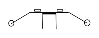

Okay so my drawing here is really crude. This is just to give a feel for what I was thinking & get input. My thoughts were not doing a full cradle. Just doing some drop down mounts for the tranny. In looking at the Porsche six mounts that are on the firewall. I thought why not do something similar with the suby motor.
So the 2 small blocks on the front of the bar would be a tube a bolt would go through. This would let the front of the motor get lined up & mounted. Yet let you pivot up & down from the tranny. So you'd lift the front of the motor. Then bring the tranny up & attach. Then you'd attach the engine bar on the side's.
This came up as I plan to use the out front header system that moves the turbo to the front of the motor. My mount would keep the engine mount from affecting the headers. Plus be one less tube my exhaust will have to route around going back.
Okay so let me know what you think. I admit I am no genius & maybe my idea sucks. So lay it on me but please do it constructively. Don't just tell me I'm an idiot (IMG:style_emoticons/default/evilgrin.gif)
I also figured to add another angle piece to the motor mounts on each side once I had the headers on (IMG:style_emoticons/default/confused24.gif)

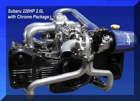

I'm thinking of doing something similar to make exhausting my 6 simpler. Why go up a larger turbo though? I feel like even in stock trim that engine is going to be a handful, and that trading lag fro more power might be a losing proposition.

I think you may have a problem routing that exhaust down under the car and out the back. The orientation in the photo is for a rear-engine car, probably a sand rail where the exhaust is already in the right place, but in a 914 that big exhaust pipe still has to be curved down and around/through your motor mounts, axles and all to exit in the rear. I know it's possible to change the turbo to the front, others have done it, but I imagine you're going to need to get creative with the plumbing. Plus that turbo and pipe get significantly hot, and that puts them right near the firewall.

I am getting the engine complete with exhaust. While I am looking into bigger turbo & options. I probably won't be doing much there until later if at all. Just pricing things out to see what makes sense & prioritize. I am not getting the cradle as he is building his ls1 off of it. As far as the turbo routing. Lyle had it in the stock spot. He was running a 901 with the adapter plate. Since I plan to run the suby tray we talked about Bob. The suby tranny output CV's sit farther forward right. Which means moving my motor back so my cv's aren't at to big an angle. Which would mean the turbo isn't going to fit without cutting up my rear trunk.

My turbo's in the stock location and we did have to cut a bit of the trunk for it, but it's really minor compared to my son's car. He bought an unfinished project where they didn't flip the intake manifold so took a huge section between the shock towers for the throttle body inlet. Something to avoid if you can.
The nice thing about using the stock exhaust is that it's pretty well designed and built, it's cheap since you have it, and you're keeping more things stock so easy to replace or upgrade later. The bad thing is that it crosses the engine in the front which limits the ways you can do engine mounts in the front. I have the Smallcar engine mounts around here somewhere, for example, a neat solution that we never used because they would have forced us to design all new exhaust and turbo plumbing. Too much work. Plus of course I'd have lost that lovely Subaru exhaust burble. (IMG:style_emoticons/default/biggrin.gif)
