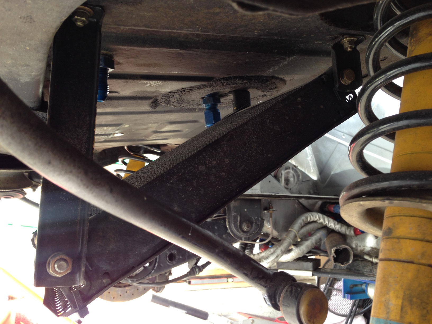

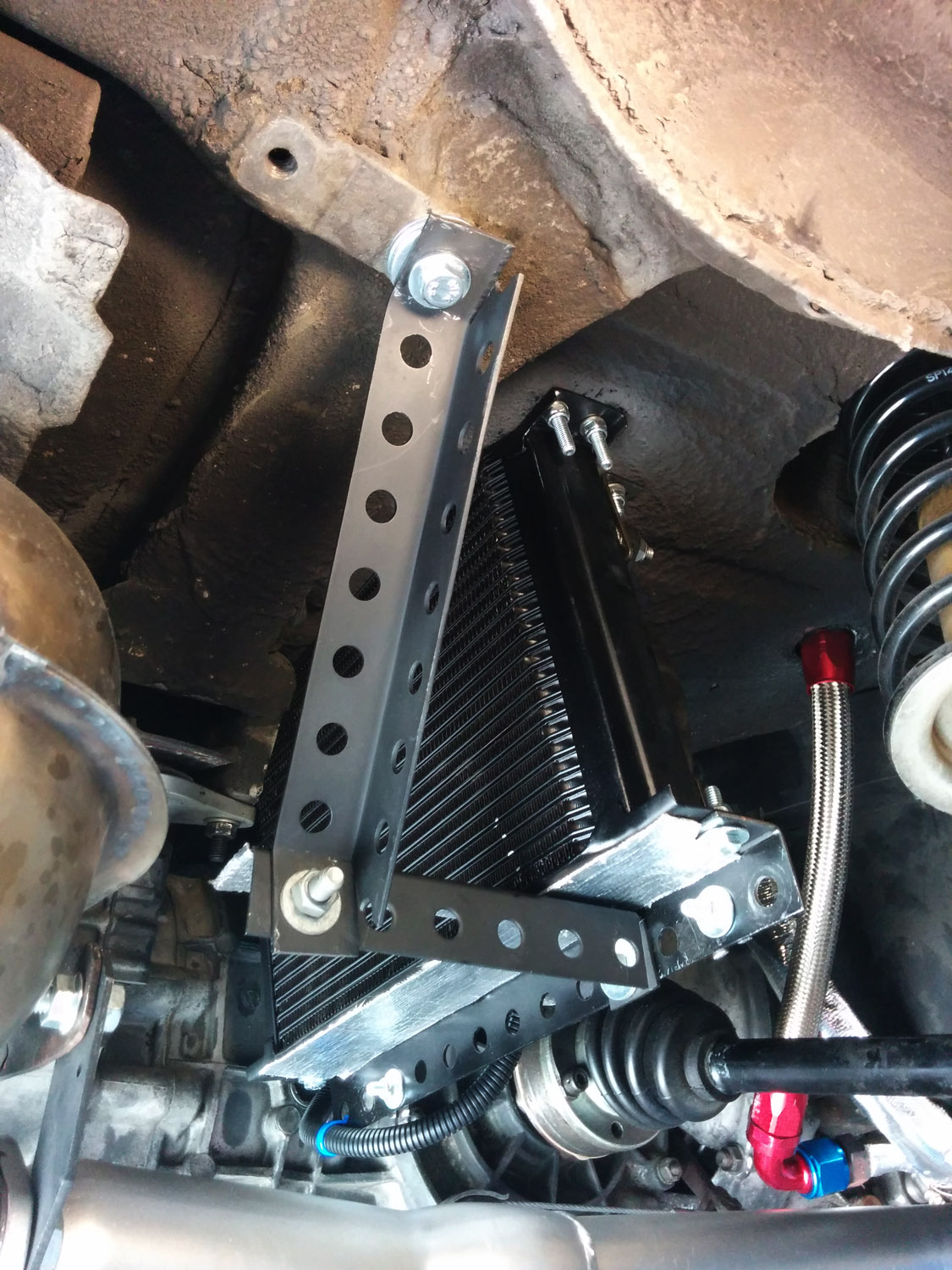

I attempted my 914-6 conversion with a 3.0L without running an external oil cooler. Some have said they have done it so I figured if I could save a grand of dollars that would be nice. But my extended freeway driving took it to around 240 and I didn't push it any further. So thus I caved and installed an external oil cooler.
Engine oil ouput line
Existing Remote Filter Mounted in Trunk
Mocal 25 Row, 235 Matrix Mounted
Braced Against Muffler Bracket
Fan Mounted
Electrical - Grounded to Transmission Ground
Relay Mounted - Main Power off Bus Bar, Ignition from Relay Board
Mocal Remote Oil Thermostat
Putting It Together
Finished!
Brings temps down to 190 @ idle

I don't have an oil filter on my tank - my aftermarket /6 tank was poorly built and the filter console was off-center drilled. So I mounted an -12 AN fitting into the filter console and that's where the oil filter outlet feeds to!
Also with this design it was modular - I was able to add the oil cooler with no additional costs of re-routing lines or changing fittings. See the black coupler in the 2nd photo.

But I don't understand your bottom brace on the oil cooler, and is it necessary? The engine and transmission move independently from the bottom of the trunk, so it looks like you are just asking to crack the cooler or its mounts. Or am I missing something? Can't the cooler just hang from the trunk and not be attached to the muffler/trans/engine?

That's actually a good point that I didn't consider. I'll have to think about it. My transmission and engine are on hard solid mounts so they don't move as much as normal.

I am curious though if anybody else has an opinion about the cooler being braced against the muffler bracket. Keeping in mind transmission and engine are on solid mounts.

I should think the solid mounts would decrease flex. Still ideal might be to choose engine or body to anchor to entirely, knowing they flex.

Doesn't matter, the engine still puts out a hell of a lot of vibration. That mounting will break the cooler and when it does it will likely wipe out the engine.

An aluminum cooler has almost no structural integrity at all and will leak in a hurry unless it's fastened to something stiff (or in a bracket, and protected from vibration.
I've had to replace one per year now on my rear cooler and it's just because I've been too lazy to re-engineer the mount.
On this installation though, doesn't the exhaust heat up the cooler a bunch? How much would a shield over the pipes help?
I've avoided that spot for years in favor of mounting in front of the right rear wheel-well well away from direct heat.

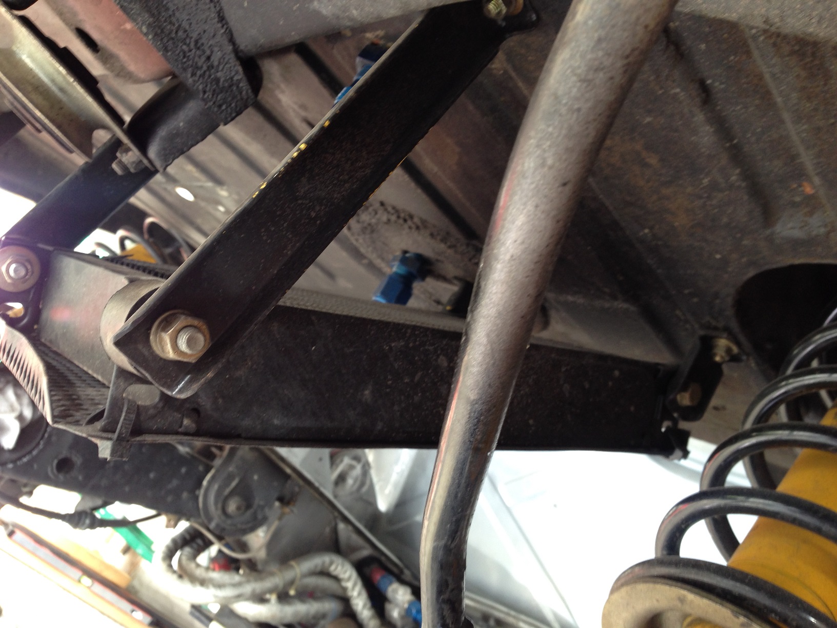

Still looking into vibration solutions but I relocated the brace off the muffler bracket.

QUOTE(patssle @ Feb 22 2015, 07:31 PM) *
Impressive, but what bugs me is the fact that the cooler is very close to the road wheels! And unprotected. One big stone, or rock through the radiator and you're stranded. I would come up with some sort of sturdy mesh guard to protect the cooler. Personally I would investigate the possibility of a cooler in front of the spare tire. I've seen lots of examples on the 'net.
Regarding vibration: a U-shaped cradle would help: you can mount the cradle to the car and the cooler can be mounted with flexible suspensions to the cradle.

N.B.--that's one of the rear sway bar mounts, not a muffler mount.

Maybe in a previous life...it's an oil cooler brace now! (IMG:style_emoticons/default/smile.gif)
The oil cooler is located near the rear of the rear tire. The front face is mostly covered with the fan and fan-grill while the non-covered side is facing rear away from the tire.
Unless a rock bypasses the exhaust and bounces off the muffler and then hits the oil cooler with enough force - it should be fine.
