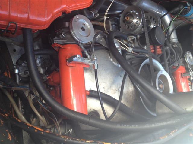

Tangerine Racing system as seen at Hershey
