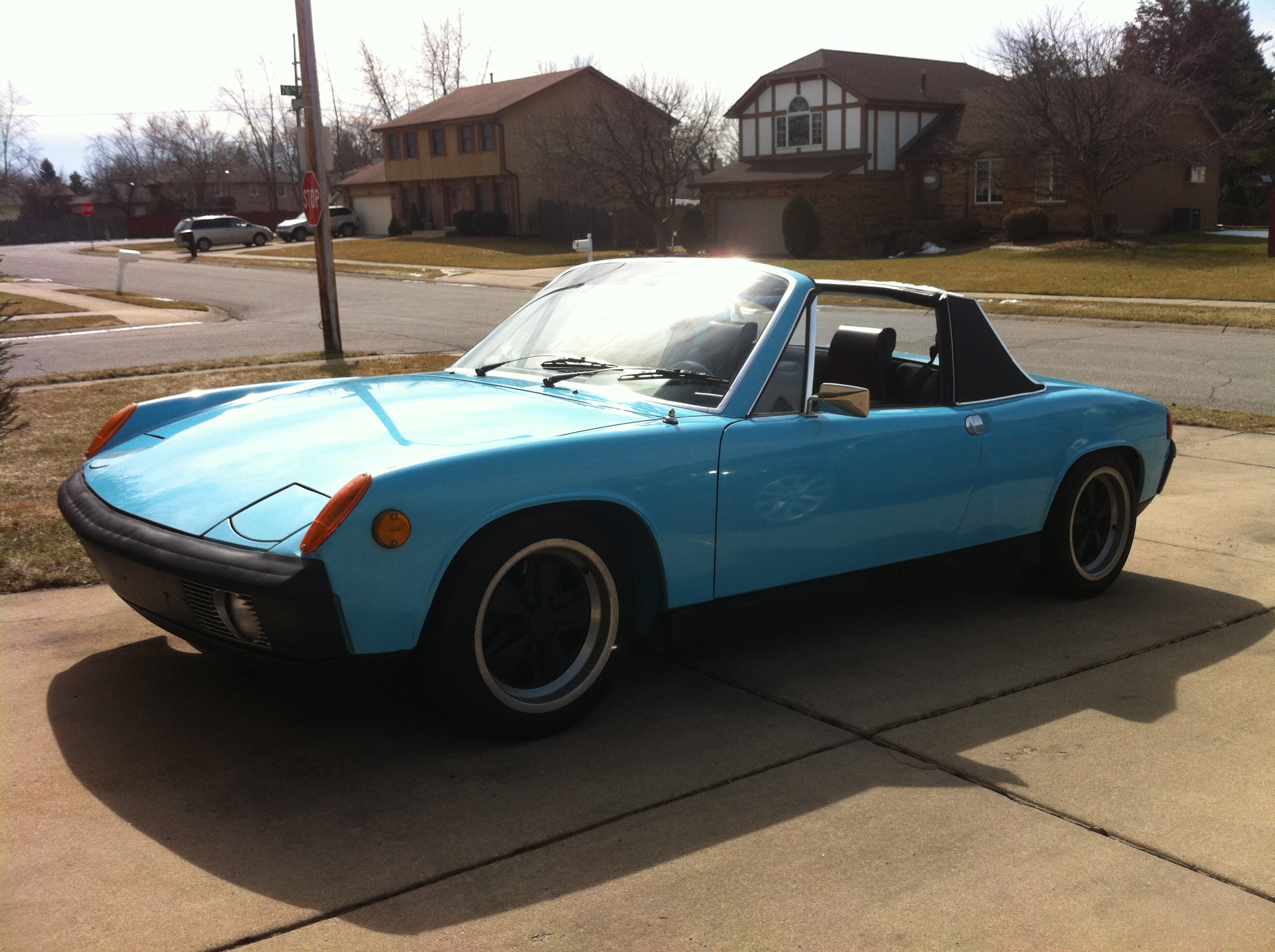

Hello all!
So my 914 refresh begins! As my car sits, it’s a ’74 1.8, which is somewhat cosmetically challenged (I know the pictures look good, and the car looks pretty good in person, but I am my father’s son and am anal about how my car looks, nothing short of perfection satisfies me).
My current project list includes(and none of these are in “order”):
-Brad Mayeur long kit
-new rocker covers
-dynamat for the firewall
-scuffing, sanding, fixing dents and repainting panels
-hunting for and fixing rust
-replacing battery tray (and fixing the trunk hinge while the engine is dropped, as well as rust hunting and fixing in the engine bay)
-replacing vinyl on sail panels
-refinish wheels
-clean and refinish wheel wells where necessary
-repaint/clean engine tin
-removing wart markers
-miscellaneous problems/projects that pop up along the way
-roll bar and harness bar (I want to autoX)
Currently, I’m planning on doing something fun with the car and giving it a subtle Gulf Oil theme. I have Gulf logos that are going on my front fenders in between where the door and front wheel arch is. I am also toying with either color matching the Fuchs centers Olympic blue, or painting the centers orange, as well as the bumpers, rocker covers and valances. Any thoughts on the paint, or other suggestions as I tear into the car? I am going to do this in quick bursts, so that I can have a car to drive, in between goals in repairing it. Eventually, the goal for the car is a 6 conversion, so I am going to be taking upgrades for that into account as I move forward as well.
-Alex

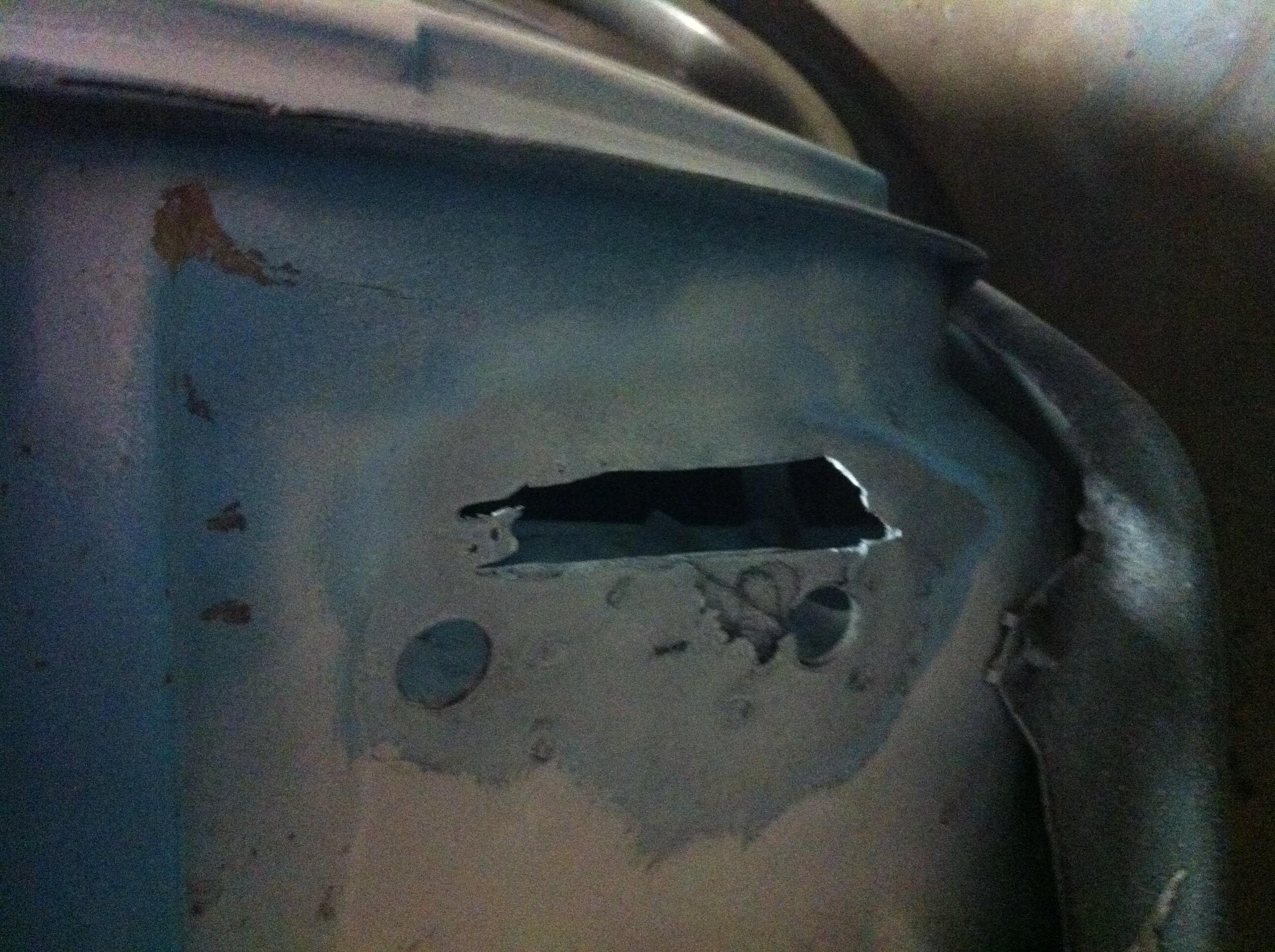

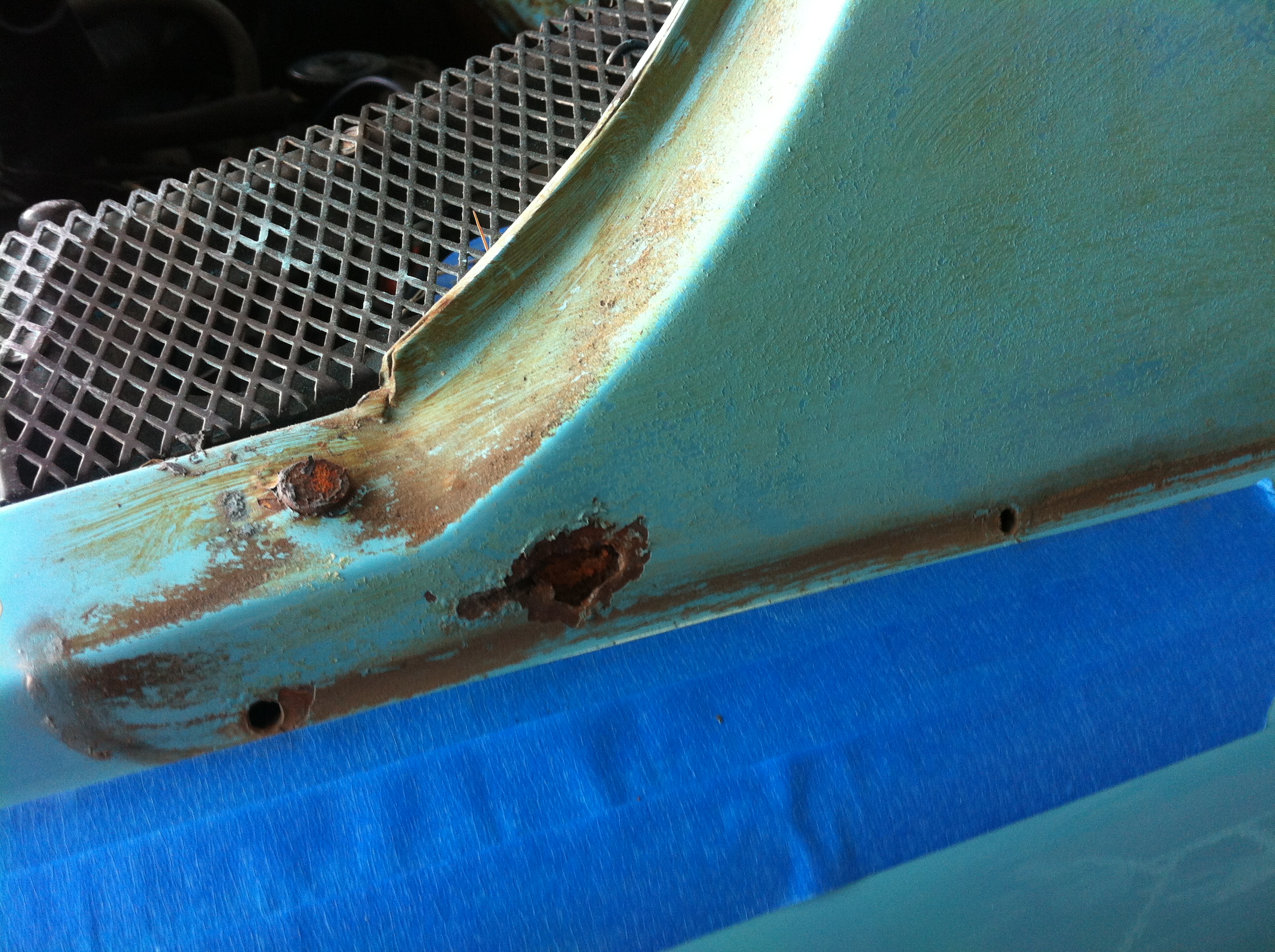

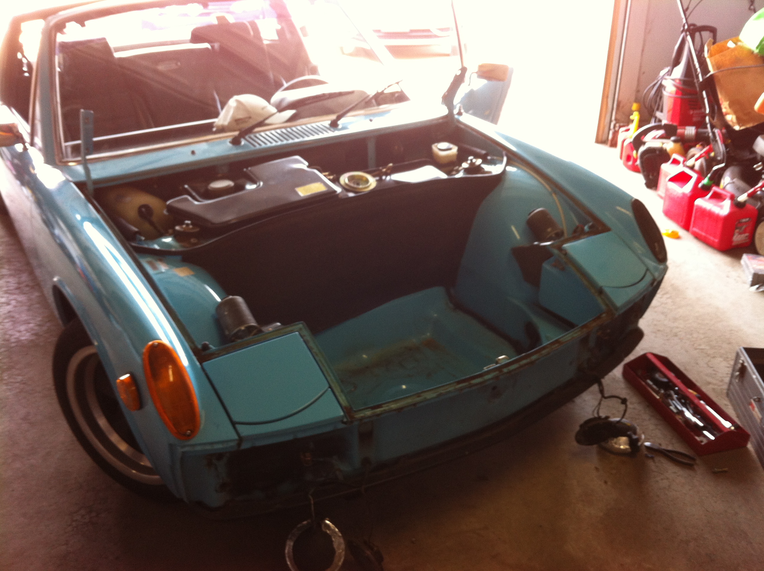

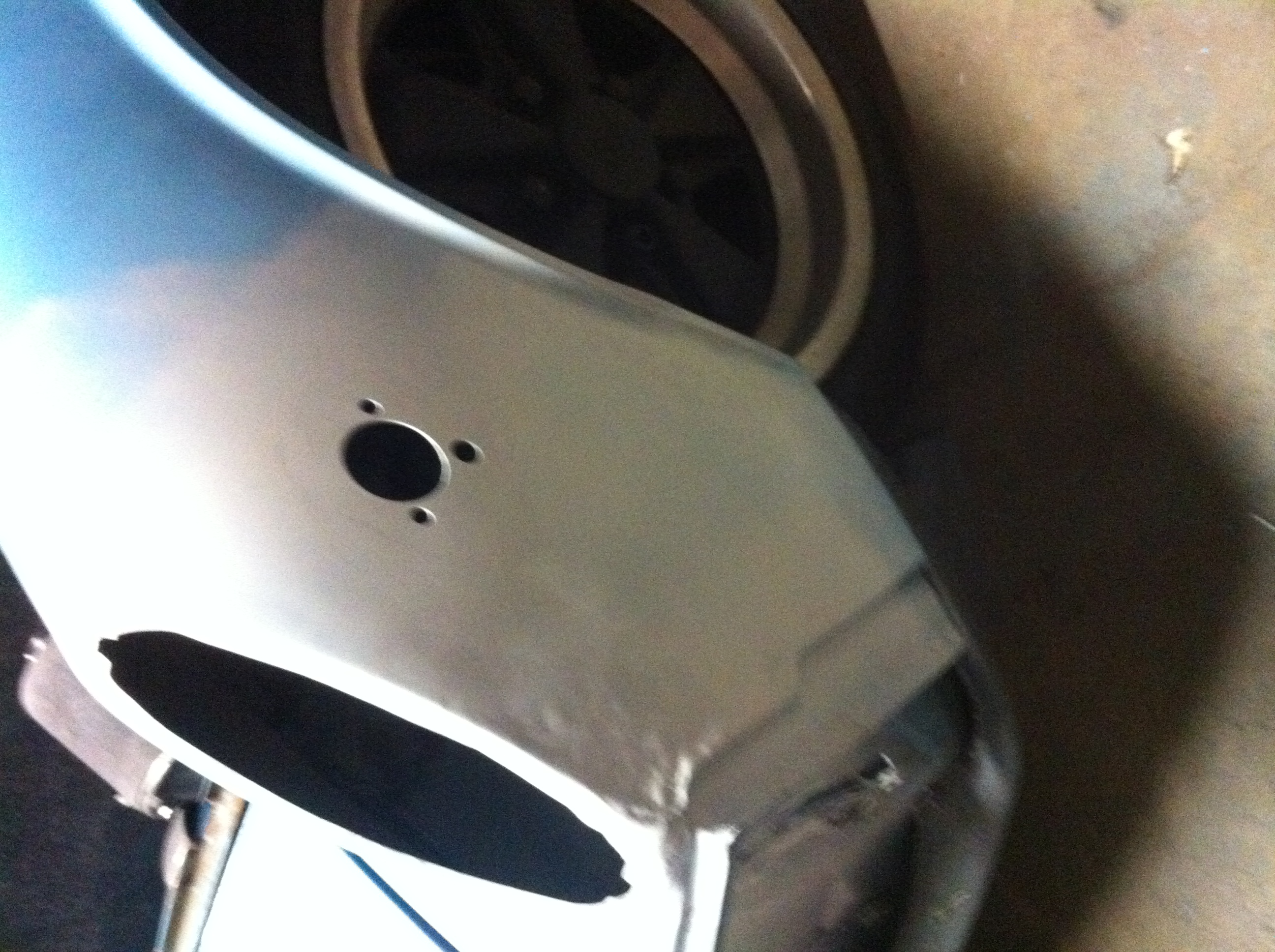

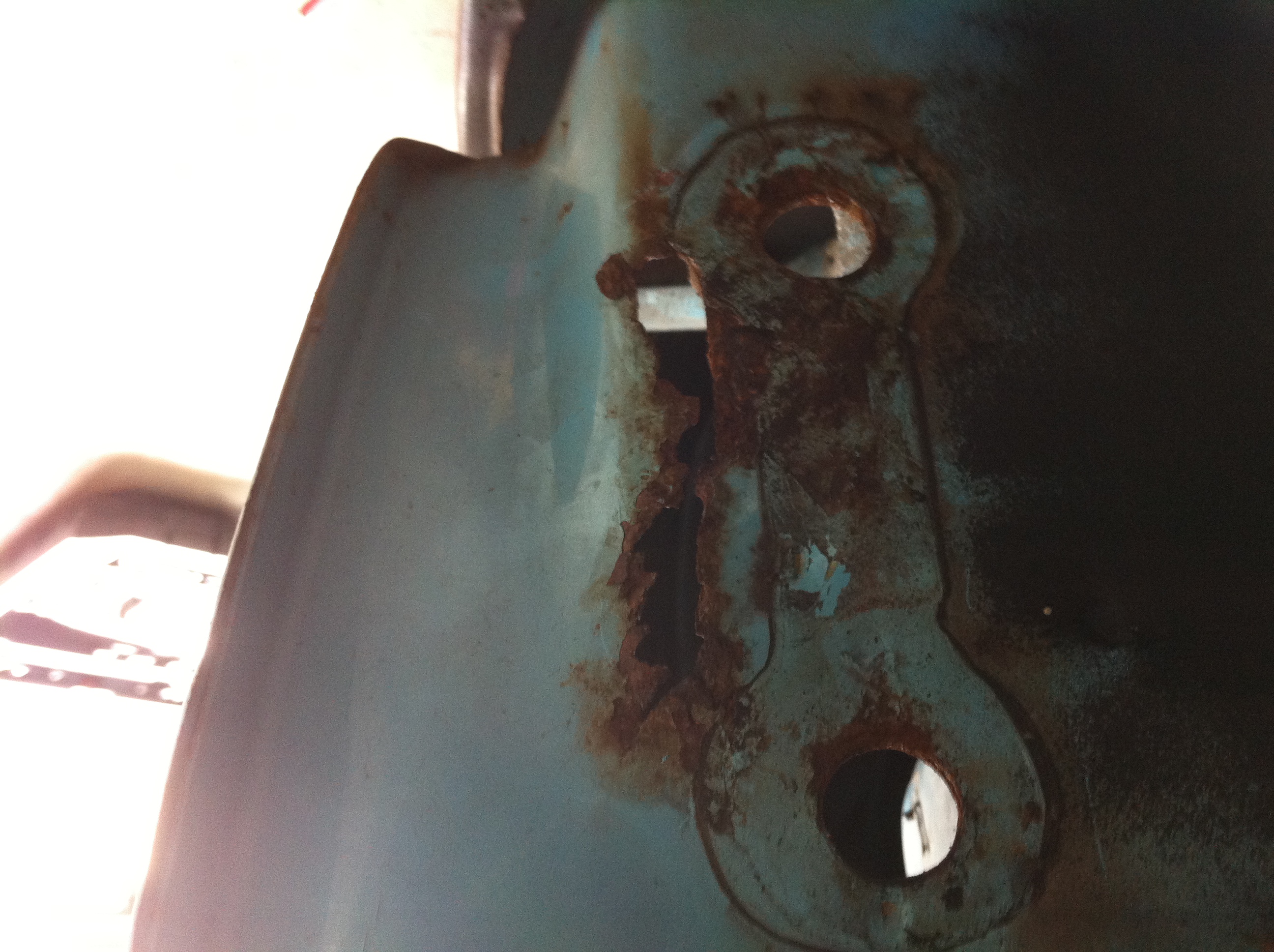

Tore into the car today, removed the front trunk lid and front bumper. Yikes, found rust on the left front bumper mount, not too terrible though, Its already down to bare metal and I will be patching over the next several days. Any tips on welding prep or wiring I need to disconnect before I weld?
Peeking around under the car yielded no surprises that I can see yet, though my rocker covers are coming off next week for the 914 ltd long kit I'm putting on. If anything is present there, I will eliminate it swiftly and as correctly as possible.

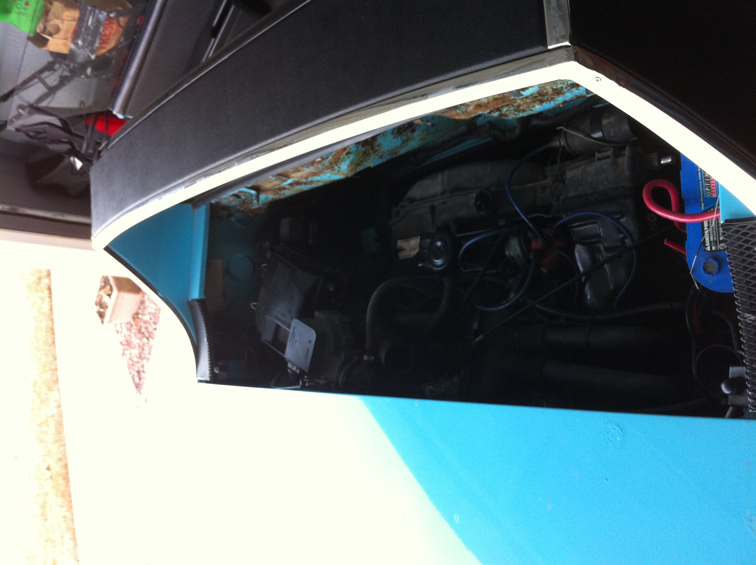

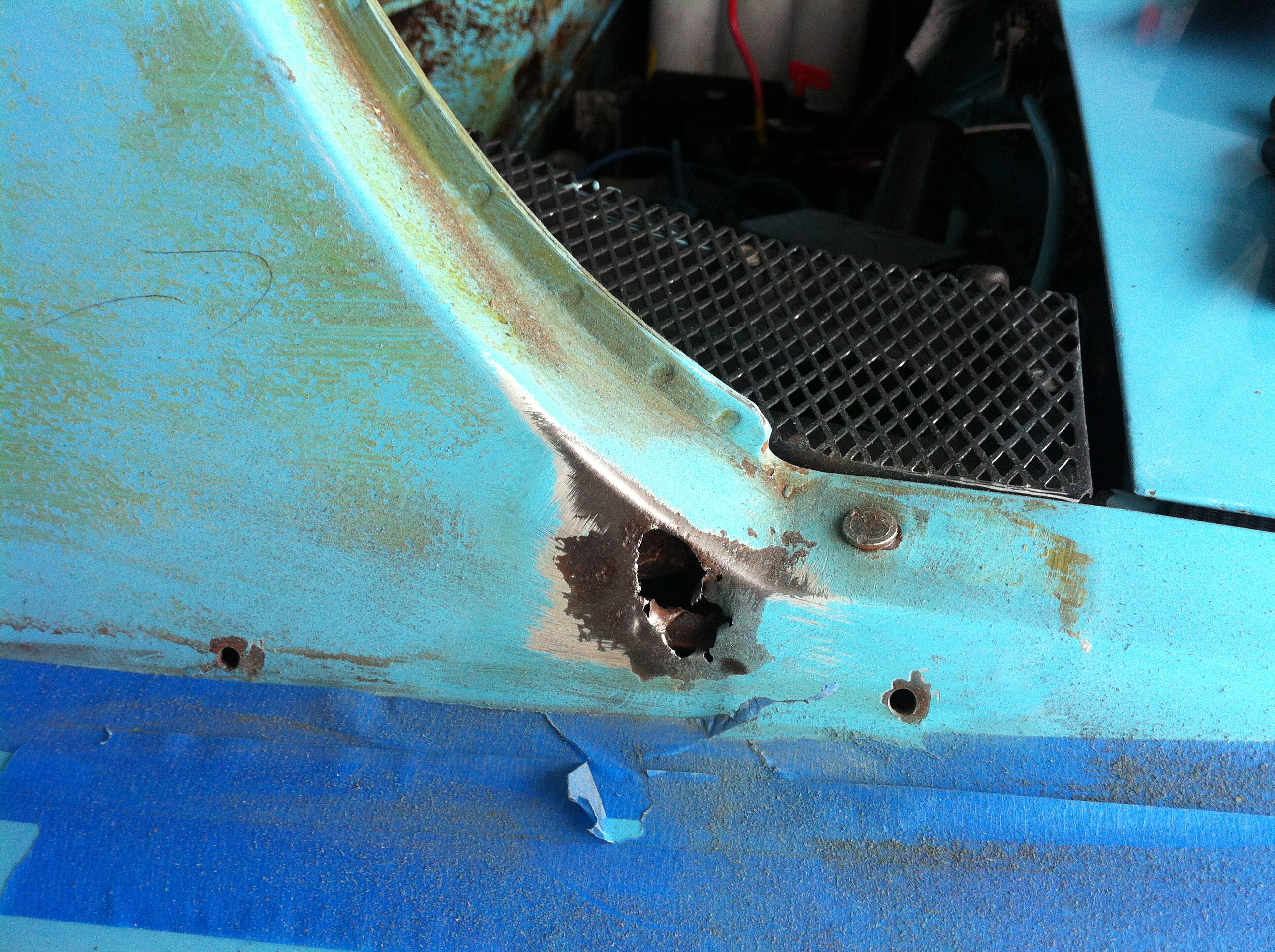

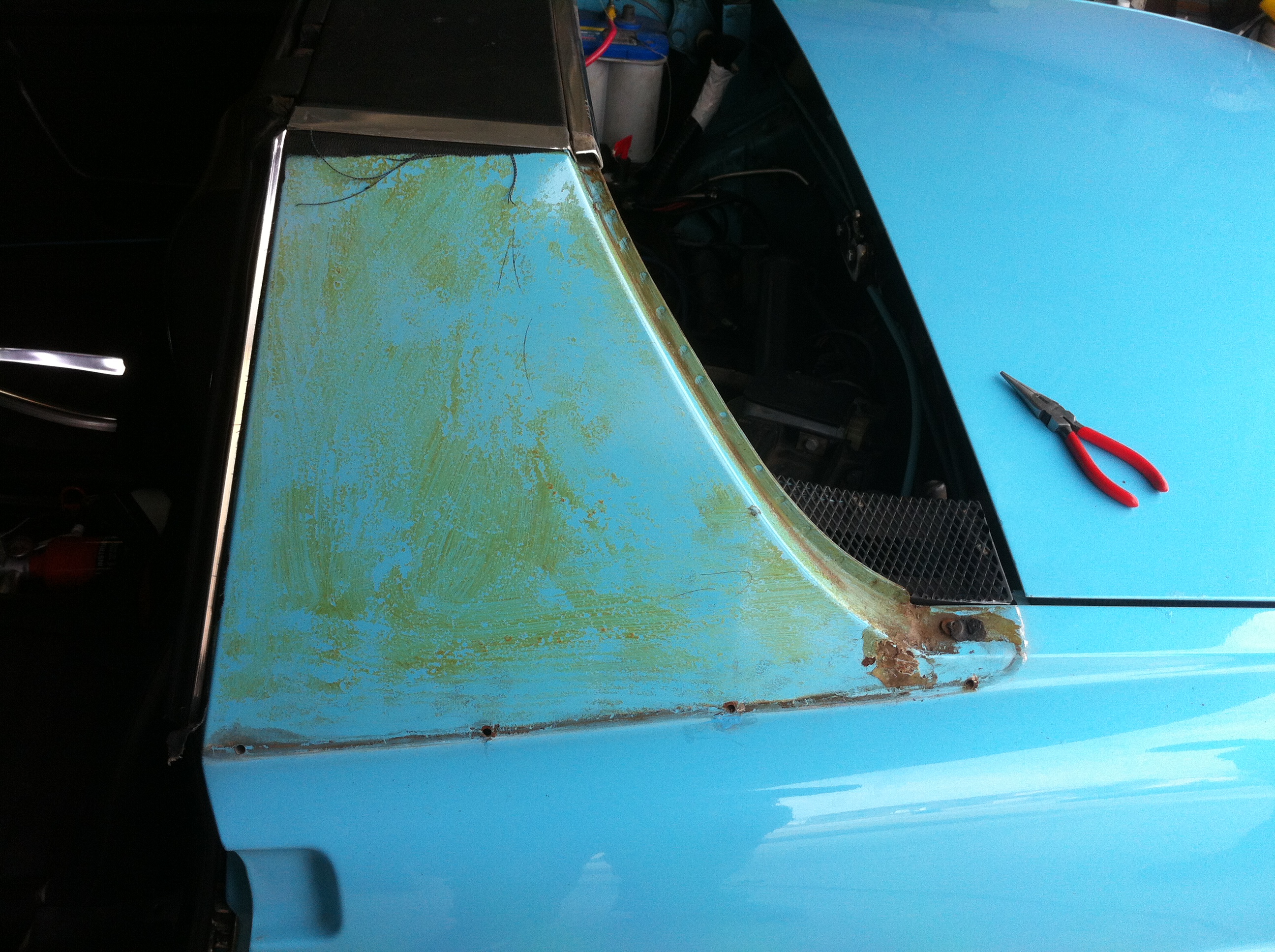

Also, took off the vinyl on the sail panels, found some rust, which I knew about. Not too bad; planning on taking down to metal and welding in patches.
Also, I neglected to mention in the previous post, I removed the trunk seal and found a few spots in the channel I will be patching as well. Any tips or suggestions for welding those?

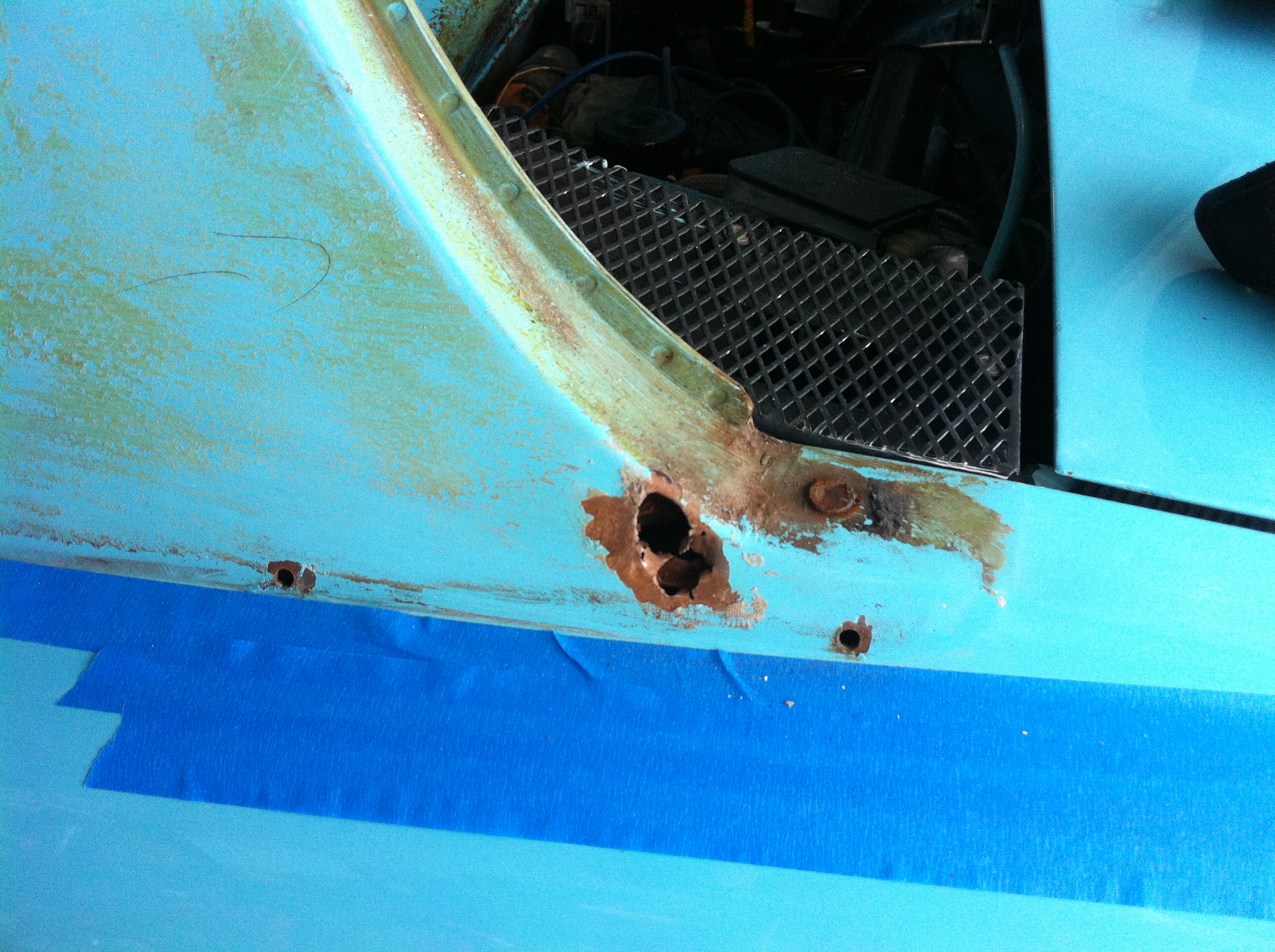

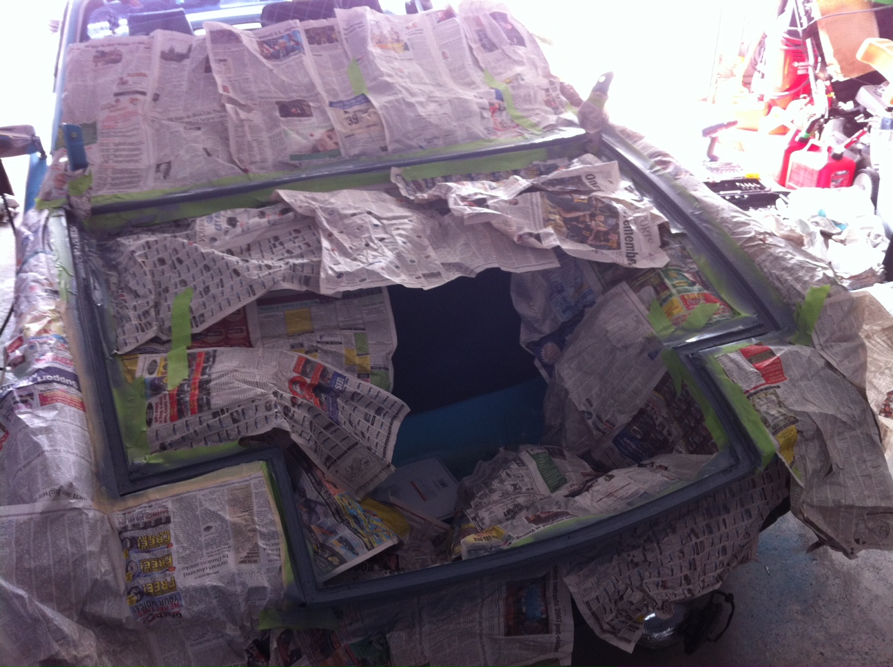

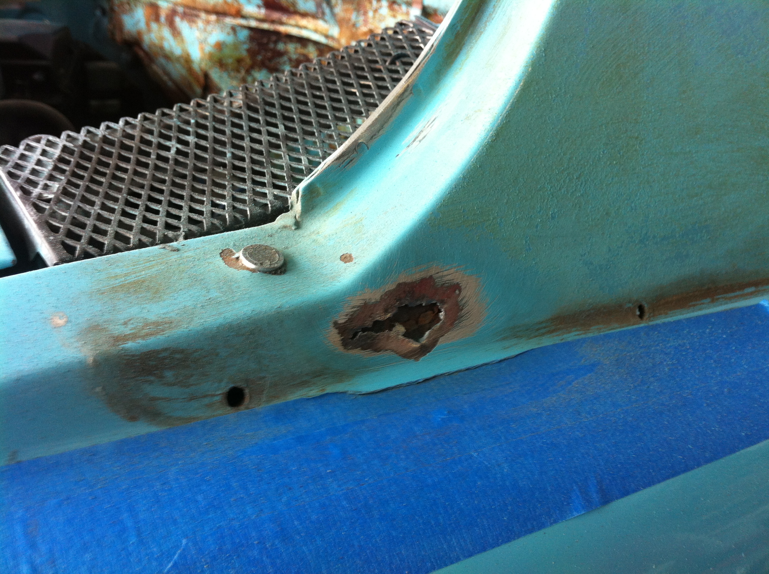

Got a bit of work done yesterday. Sort of squared the rust hole next to the mounts. I'm planning on cutting more out between the holes and patching after I get the other patch in. Hit the front quarter with a hammer a bunch to fix the fender profile and hit some dents out. Definitely took a bit of mental strength to tell myself that I was about to hit my car with a hammer, but the profile is correct now. Just have to smooth the small stuff there, and put some filler on once I weld the patch over the wart hole.
Attached ImageAttached Image

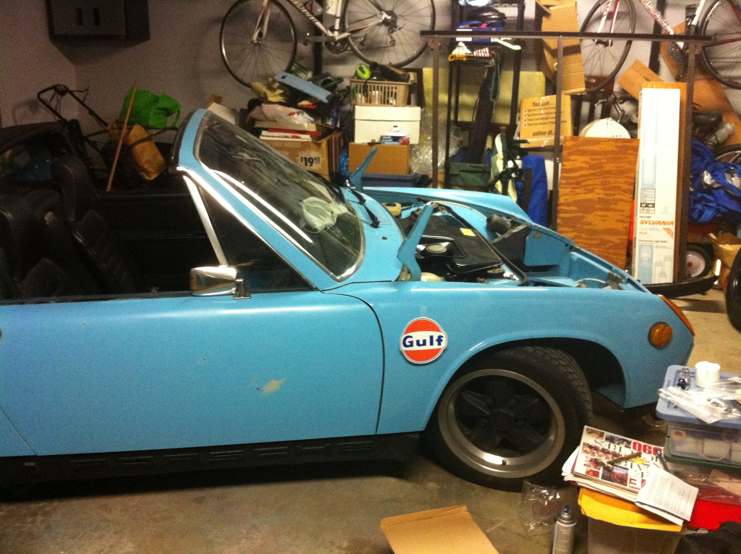

Also, tested placement of the Gulf vinyl, I like it! (IMG:style_emoticons/default/aktion035.gif)

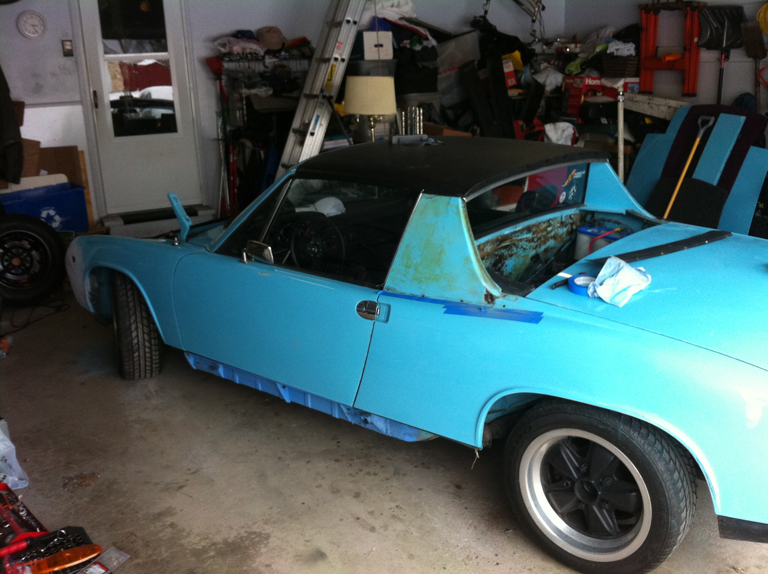

Here are a few pics of progress again. I squared the hole next to the bumper mount and wire wheeled it, but forgot to take a pic (IMG:style_emoticons/default/headbang.gif) Will have to do that later.

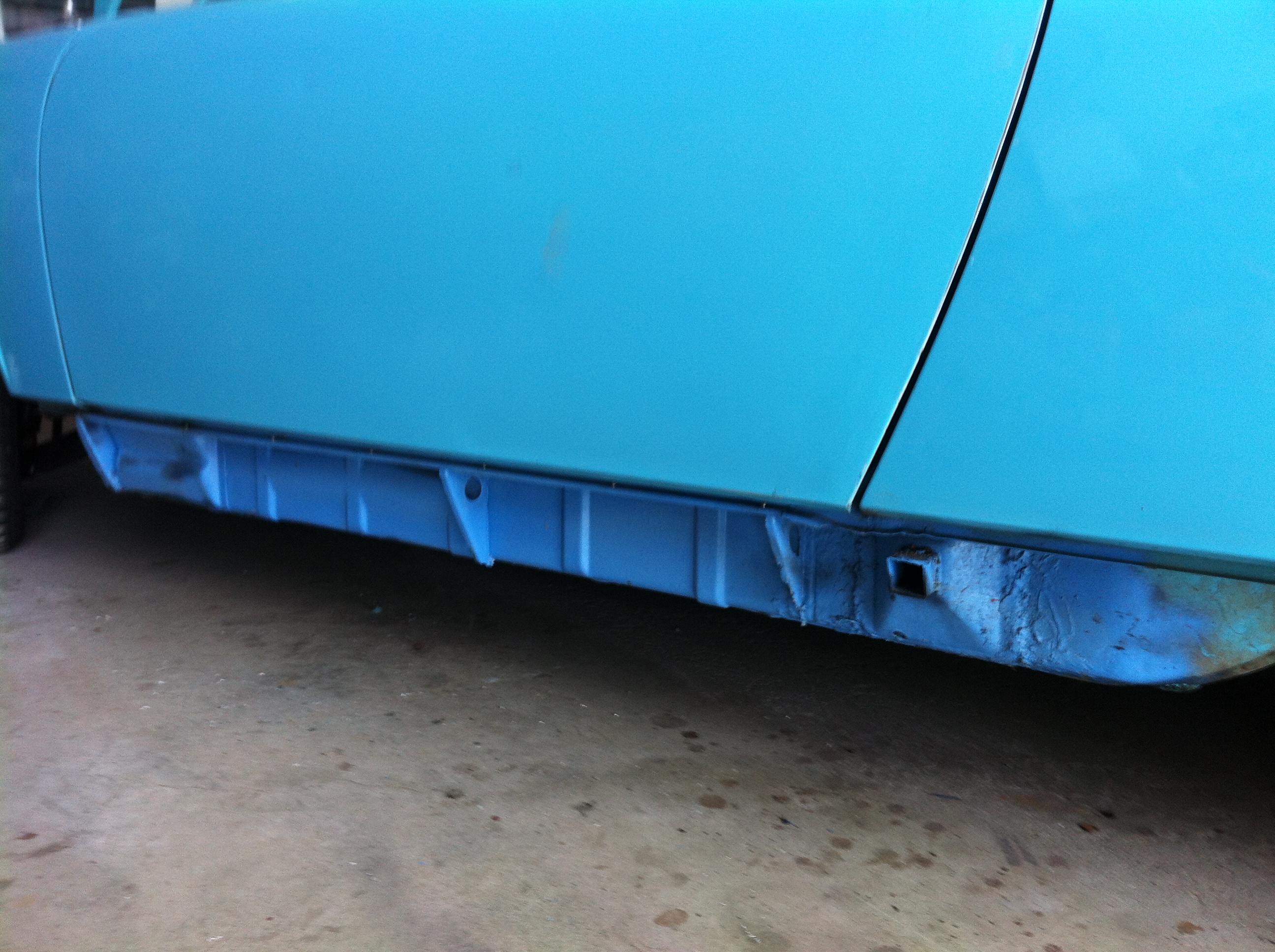

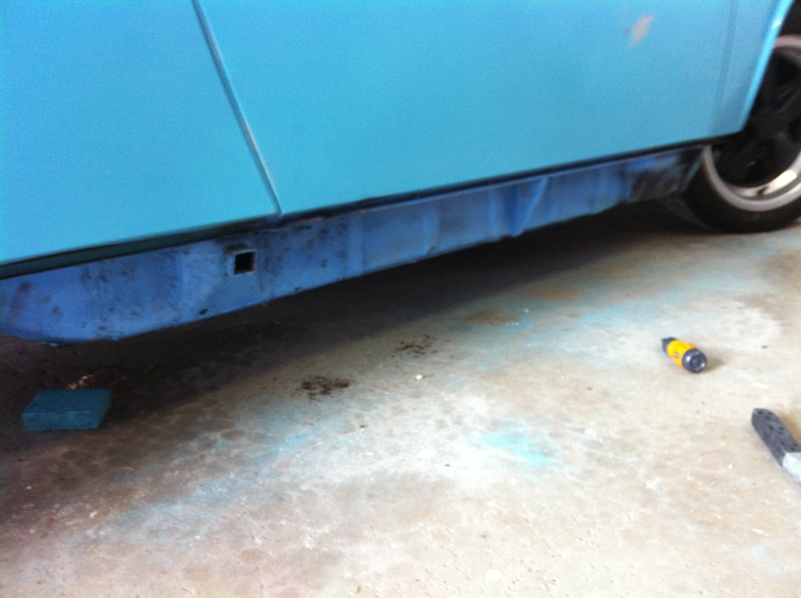

Took the rocker covers off, was fearing the worst, or at least a bit of rot, but nothing to my sight or in reach of my awl poking for rust. The splotchy matter what appears to be a rubber sealant, I stabbed through and hit solid metal every time, so I think its pretty good. Though there is a patch on the right side long about 3" long and 1" wide that I have to remove and weld correctly.
I will be using Eastwoods Internal frame coating in the longs (as well as some of Eastwoods other fine products on the car), just as a precautionary measure. I know a bit of very small particulate rust has come out of the drain holes, so I want to nip that in the bud now.
I ground/hammered/pryed out the rust on both sail panels and wire wheeled them. The right side hole has solid metal behind, Im thinking because of how it is, I can just pop in a few beads into the spot, fill it, and grind it flush. The right side however, I am going to cut out and patch with a small piece. Suggestions on sheetmetal gauge?
Also, are there any precautions or procedures I should do to the car before welding on her? I know disconnect the battery, but should I do anything else?
Thanks for the support and help thus far guys! Attached Image Attached Image

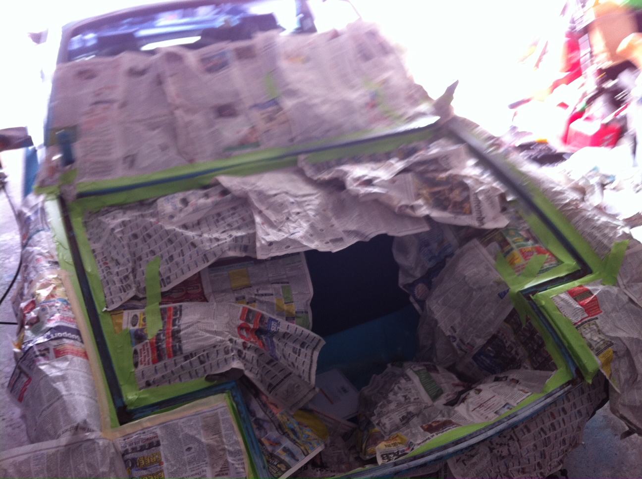

Got the better rocker covers and long kit in yesterday. Wow, thats all I can say, excellent work from 914ltd on this kit, very impressive.
So I masked the trunk seal channel (some rust in the channel) and prepped and sprayed Eastwoods rust converter on it. Going to probably leave it the grey color for a while until I get both fenders to the point of paint, so I can touch up the little areas that need to have blue put on them.
I got to use my favorite hammer and popped out a few other dents on the passenger side (IMG:style_emoticons/default/smash.gif)
Hopefully going to put the car on jacks tomorrow or Thursday for prepwork for welding.

I have seen on other threads that rust along the bottom of the sail panels is caused by foam installed by the factory in that area. I am no expert on rust or 914s but you may want to determine if the rust is deeper than you expect. Have seen several pictures of the sail panels removed and rust being more extensive than expected.
