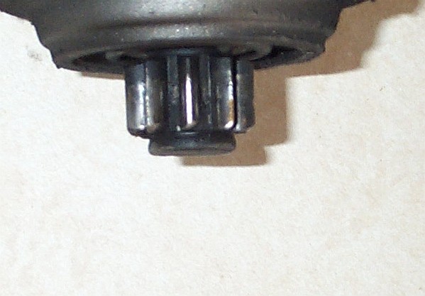

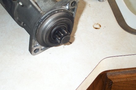

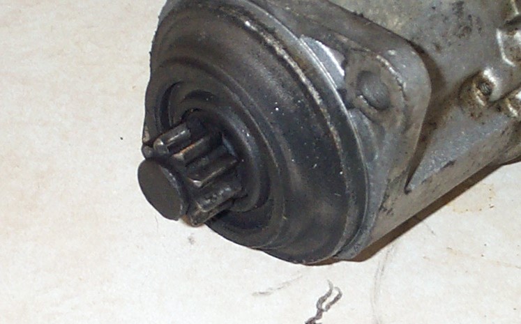

Here are some pictures of the worn starter gear. I don't think it's too bad to *not* reuse.

pic 2

pic 3
