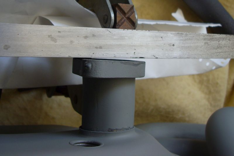

PM sent Stoddard ? Dansk new version ones ??
If so check flanges. . mine were not parallel to heads and Stoddard recalled them.
This is a picture with a straight edge and the gap. .
If yours are OE factory exchangers, they [at least mine do] should have a stepped ring on the center of the flange. . You should be able to look at the gasket and see the impression where it mated and see where the leak is. . .
I never use these gaskets over as they crush where this ring is. .

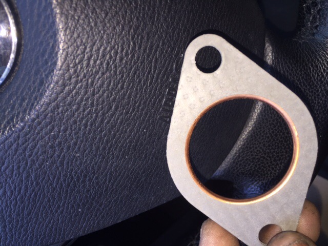

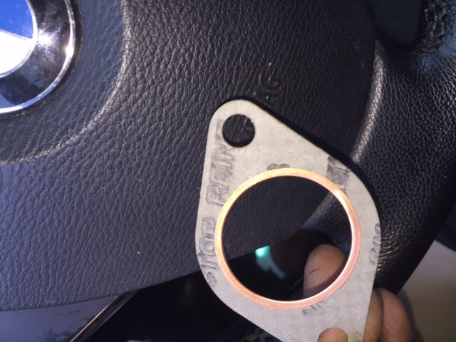

914itis
post May 14 2015, 07:41 PM
Posts: 2,892
Joined: 9-October 10
From: New York City
Member No.: 12,256
Thanks all ,
I got it all sorted out .
The gaskets needed to position the right way with the coppered side up .
I noticed that after ordered a second set. Out of 10 I ordered only 2 were stamped . As shown in picture .
Because if the lip on the HE's the softer side must face them.
No more leaks .

Agreed with your positioning, but what stamp are you talking about? It
says "Victor Reinz".
914itis
post May 14 2015, 08:38 PM
Posts: 2,892
From: New York City
Member No.: 12,256
I think it says top.
I'll look again.
mskala
post May 15 2015, 05:55 AM
R
Posts: 1,965
Joined: 2-January 03
From: Massachusetts
Member No.: 79
QUOTE(914itis @ May 14 2015, 10:38 PM) *
I'll look again.
That's just dumb luck. TOP is just the part of VICTOR that shows. I've always
installed the copper side toward the head, but good to know there's going to be
problems the other way.
