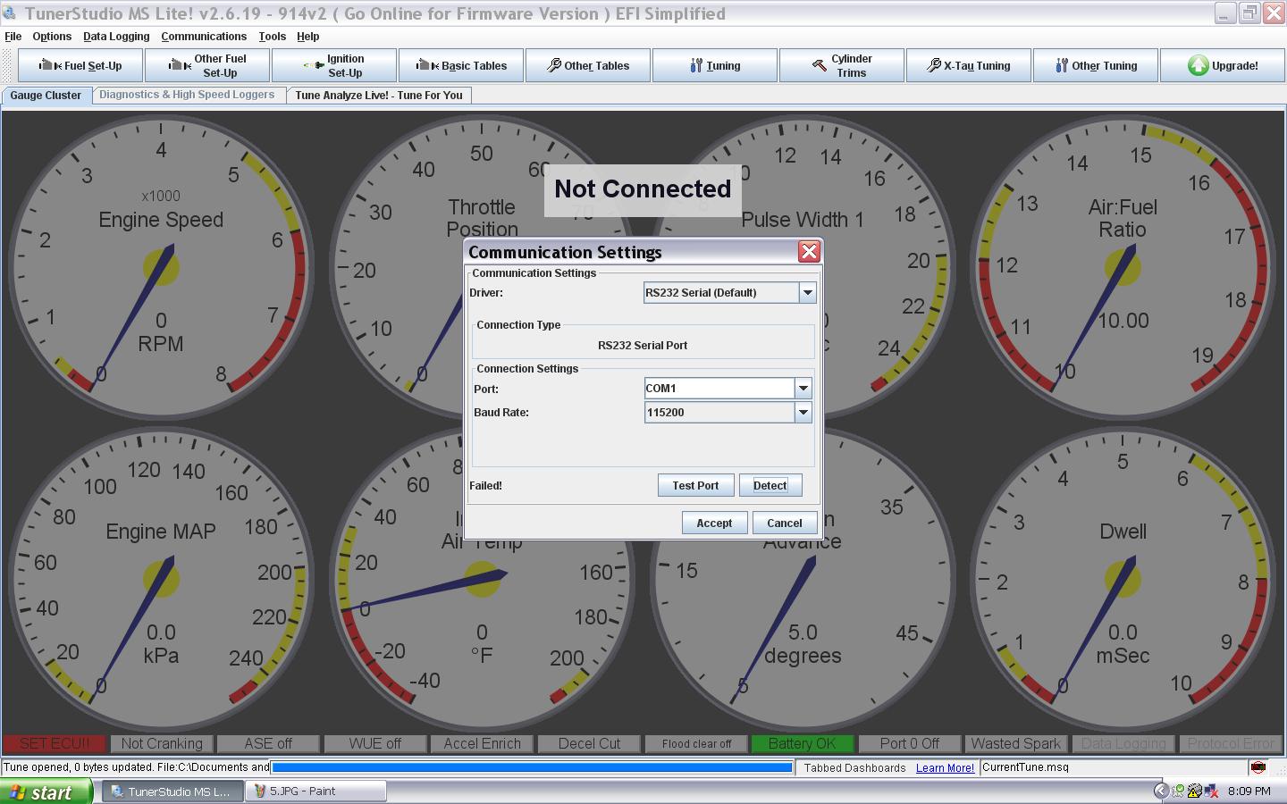

After getting all the wiring and fuel lines hooked up, I added fuel to make sure there were no leaks. When that checked out I set out to get all my sensors calibrated.

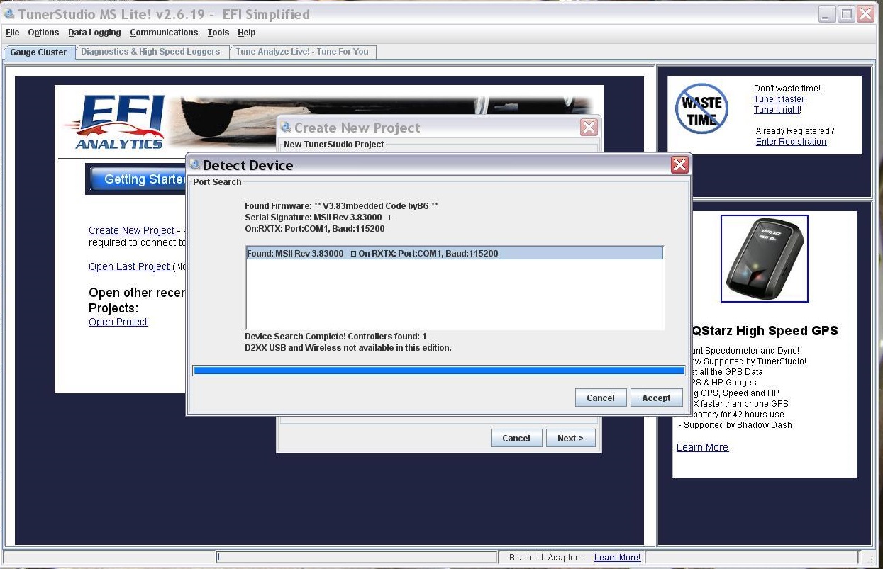

I hooked up my laptop and detected the MS

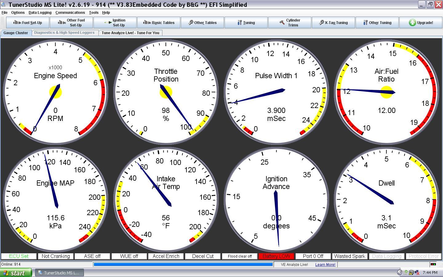

This is what my gauge cluster looked like before I started getting things calibrated.

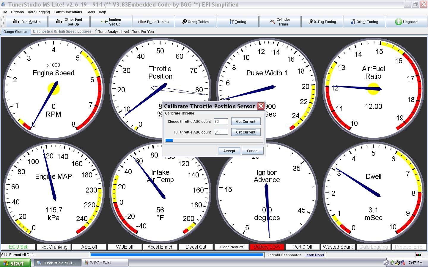

I then calibrated my TPS
After this, things went wrong! I attempted to calibrate the CHT sensor. I put in the correct numbers given to me by Mark, and then clicked "write to controller" I dont know if this was the correct step, but somehow the firmware disappeared from the MS unit. I attempted to reload the firmware but it hung up every time. I tried a dozen times but nothing worked.

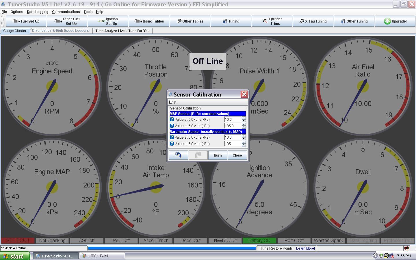

I moved on to other things and I think I was able to get the MAP sensor calibrated.
After the firmware was lost it wouldnt connect to the MS unit anymore, so my night was kinda pooched. I am going to have to reload that firmware before anything else happens.

For the connection, make sure that the ECU is getting good voltage. You may need to put a charge on your battery.
On your laptop get the port check utility and run it. It should detect the ECU and ping back which firmware its running.
MAKE SURE THE BOOTLOADER WIRE IS NOT GROUNDING SOMEWHERE! If its grounding somehow the ECU will act as if it has no firmware.
