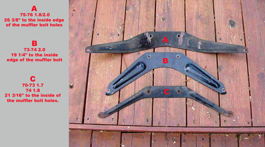

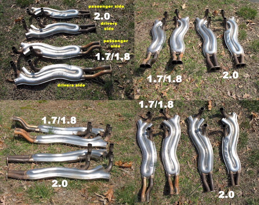

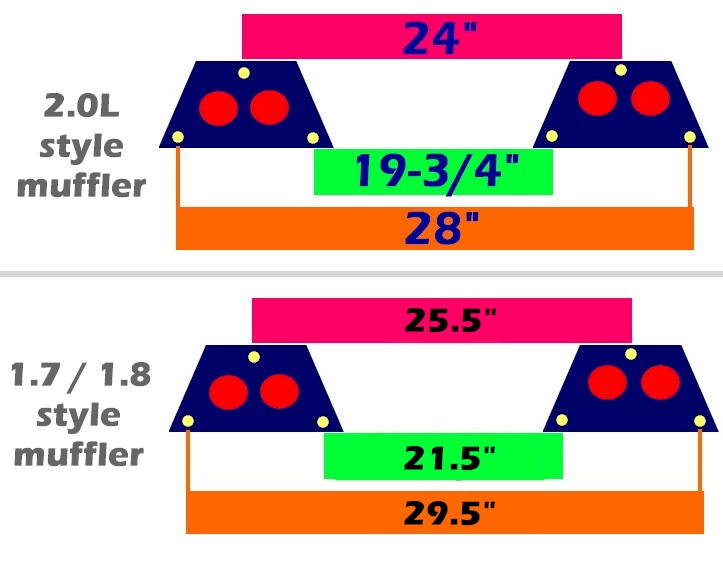

The 2.0 exchangers will fit a 1.7. They have larger pipes. Different gaskets are needed at the heads and rear flanges. They use different muffler brackets.
If you paid for 2.0 exchangers they should have straight pipes out of the end. If they offset upward they are 1.7 or 1.8.

On Jeff Bowlsby's "Tech Notebook" page (http://bowlsby.net/914/Classic/TechNotebook.htm) there are some images that might help you figure out what you get:
(IMG:http://www.914world.com/bbs2/uploads_offsite/bowlsby.net-121-1432877958.1.jpg)
(IMG:http://www.914world.com/bbs2/uploads_offsite/bowlsby.net-121-1432877958.2.jpg)
(IMG:http://www.914world.com/bbs2/uploads_offsite/bowlsby.net-121-1432877958.3.jpg)

Why they would have sold you a 1.7/1.8 muffler bracket AND one for the 2.0s is beyond me. Did the kit include all of the other heat related items? How much was the 'handling' charge addition to actual shipping?

As for the muffler brackets, my guess is whoever packed the box didn't know which bracket to put in, so threw in both of them just to be sure, or just didn't care. I checked the invoice, and they only charged me for one bracket.
